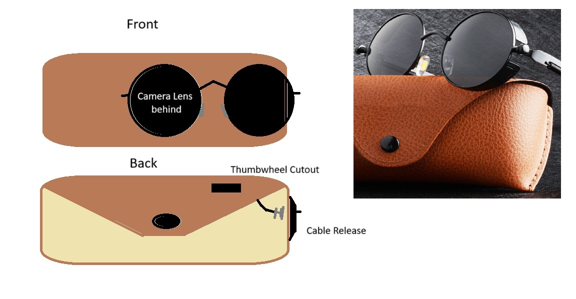

Just an idea I've been thinking about for photography without being noticed:
Something that might work for a compact 35mm. You'd cut out the case where the camera lens goes and put one lens of the circular sunglasses in front of it, gluing it there.
Operation by cable release or shutter button cutout. Advance by thumbwheel cutout. Thumbwheels can usually be advanced silently if you go slow. Changing other camera settings would require opening it.
It doesn't look out of place to carry sunglasses along with their case. You'd probably have to remove at least one of the ear hooks, but I doubt that would draw attention. Maybe one of the ear hooks could support the cable release behind it.
Foam or other filler materials inside so your camera stays firmly in the correct spot. Maybe even a tripod mount if you want to get fancy.
Inexpensive, simple, easy to make.
So in effect you are putting an unknown and uncalibrated filter in front of the lens. Why?
Leaving aside that it can (musn`t, but can) sound strange if you want to take pictures unnoticed... let me put it like this:
Aaah, Mr. Bond, nice sunglasses you have there... and even a case for them. Most people just put on their sunglasses or clip them on their collar if they don`t need them, but you Mr. Bond also carry a case for them around. But, Mr. Bond, you never put the glasses inside the case, you just clip them outside the case where the glasses cannot be protected -which is strange. Also you never put the sunglasses on and never permit anyone else to use them - but you often hold the case-clipped glasses with both hands at unusual angles and fiddle around the case with both hands...
...strange Mr. Bond, strange - let me have a look at your case-clipped sunglasses Mr. Bond!

You don't raise it up. You keep it on your lap while sitting or hold it near your waist as you would normally hold an object that you were just carrying. Every now and then you can tilt it a bit and take a picture while acting as if you were just randomly shuffling an object around. The power of it would come from how little attention you seem to give it, it would benefit from the basics of the magician/sleight of hand skillset.
You could get fancy if you want and select a pair of perfectly round eyeglasses and mount an optical filter in them instead. They'd need to provide at least a couple stops of darkening in order to obfuscate the lens behind them. But easier to just test the optical effect on the camera of the stock shades and adjust accordingly.
Most people pay a lot less attention to the small details than you think. We go on autopilot and our brain imagines in the gaps for us. Resting your thumb on the nose bridge allows the shades to seem naturally pressed to the case rather than glued. When you aren't using it, you could also place it in a bag so as not to expose it to attention.

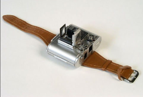

Even stealthier than the OP's idea is a Tessina camera on a wrist strap. One can even have the tessina with a light meter on the camera.
I have one of these cameras and the wrist strap so I will not need your product.

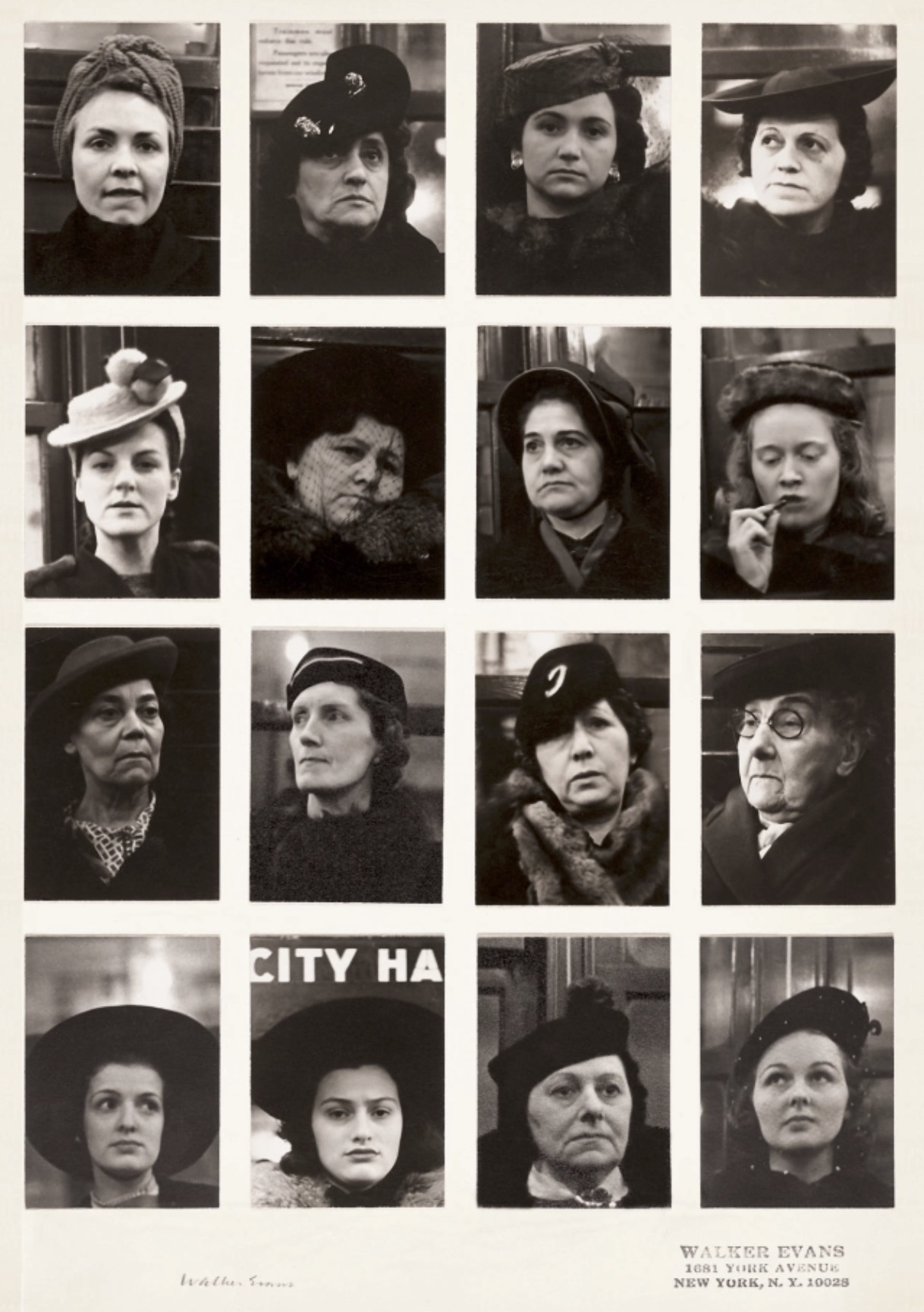

You're a bit late. In 1938, Walker Evens hid a 35mm camera under his coat, with the lens poking between buttonholes. He took a series of "subway portraits that is well-known.
At least five of them are looking directly into the lens.

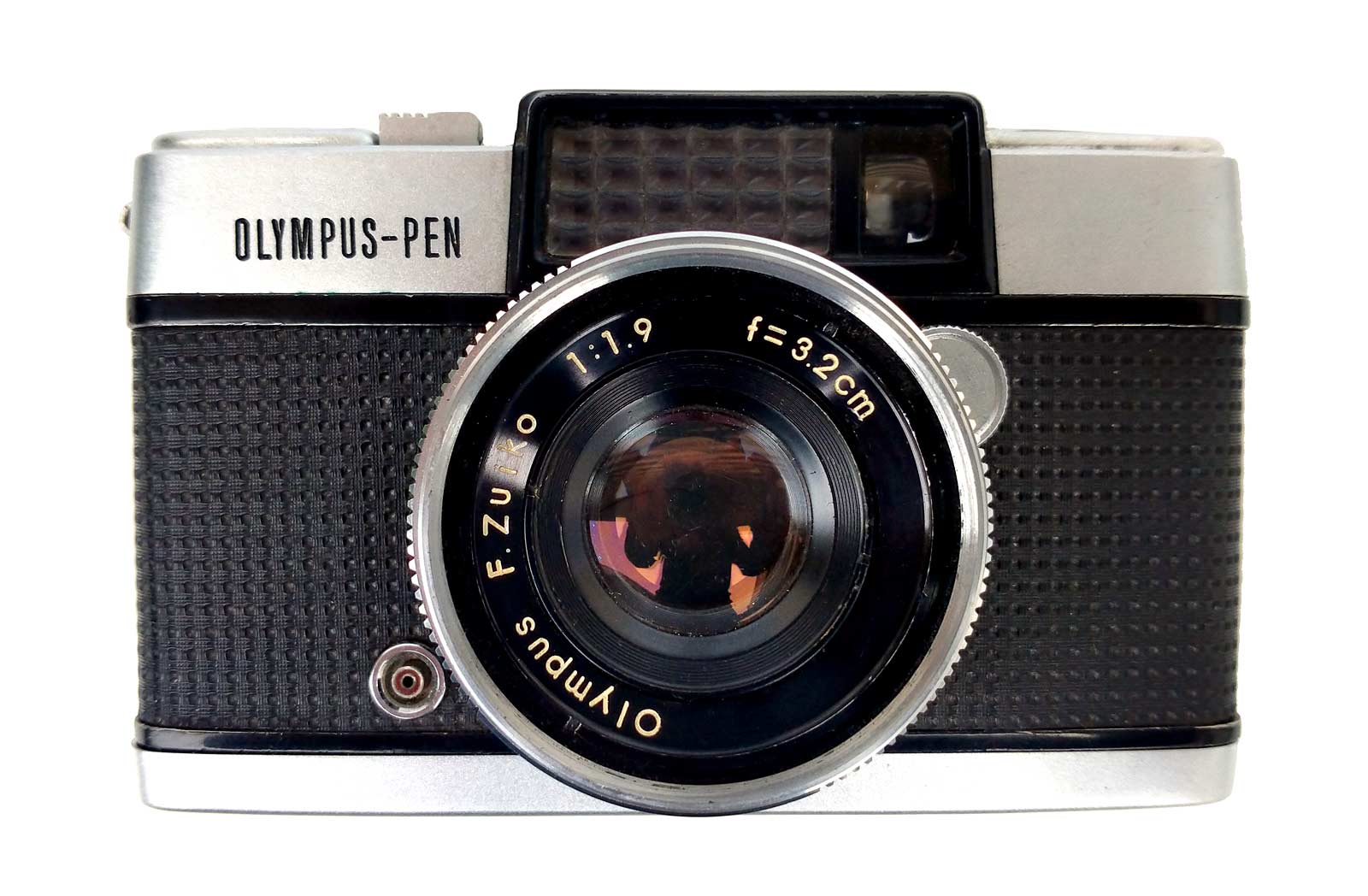

I finally decided to get started on this project, ordered the materials and they'll be arriving next week. I'm going to try it with an Olympus Pen D.
The glasses are polarized and have a 48mm lens diameter. The Pen D's lens has a 43mm filter thread and I also have some 43->49mm step up rings. Should be fun to see what I can come up with.
I'll probably put some black tape over the lettering on the lens.
