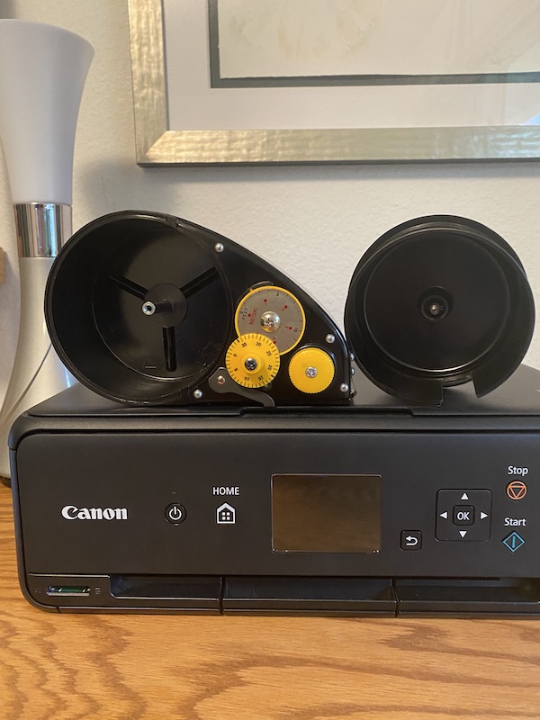

The Alden 74 arrived today loaded with a mystery film. It looks like color stock. Also it's missing the centering spool, so if anyone has an extra, let me know. Just heard back from the seller, they're refunding my payment and told me to keep the loader!
That center piece is probably broken off, and the lid won't screw down tight without it...
The center shaft is there and the cover is secure, the only thing missing is the piece that is fitted to the center of the bulk roll of film, then slips over the shaft to keep the film from wandering around the chamber.
Okay, that comes with (some) commercially sold bulk rolls, but likely isn't present if the film you got was rolled down from cine stock. The loader will work about the same with or without it, though there's slightly more risk of scratching without it (from the outer surface of a new roll riding on the inside of the chamber). You could drill a length of 1" dowel to fit if you get film that doesn't have the core, or drill through an 828 film can if you've got one you don't care about (35mm cans are too big).
With the seller refunding my payment, I ordered another one with all of the parts. Since he told me to keep this one, I'll try using a piece of dowel. Thanks for the suggestion.
