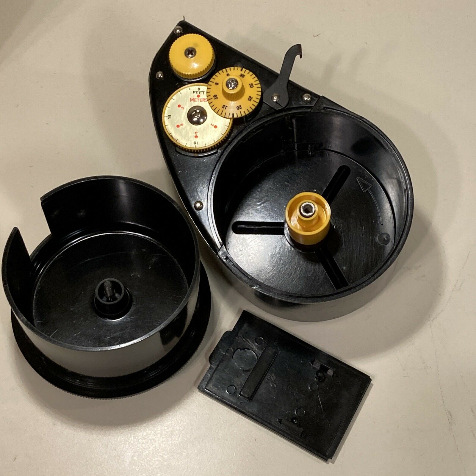

The centre spool comes with film - it's not part of the loader. The seller was a sucker, unfortunately....
In this photo, it's the plastic piece that fits over the center spindle. The film core slides over that to keep the film aligned. It's the piece that is missing.
Tried the mystery film in Rodinal 1-100 for one hour, took out a wet piece of film with no signs of development. I'll keep the rest of the roll for practice.
One ebay listing shows:
And that yellow spool would need to be removed to insert a bulk roll that comes with a centre spool - such as the black spool above. Easy to see how it would be lost (my Alden doesn't have it). But I don't remember the last time I got a bulk roll of film without a centre spool.
