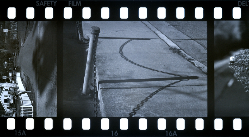

I can't say I'm overly impressed with the results from your ancient 'Tri-X'. When I restarted shooting black and white in 2012 my bulk loader was still half full of Ilford FP4 which expired in 1992. I also had a few reloaded cassettes of TMax 400 that expired in 1989. Bearing in mind the age of the film I chose to process them in HC-110. Pretty miserable results with large grain and heavy base fogging. A lot of the problems were probably due to storage conditions and I had also moved house a number of times in the 1990's. I blame the heat of the Australian summer.
I find it hard enough to get good results from 35mm negs without the handicap of degraded film stock of unknown age and provenance. If the budget is tight then treat yourself to some Kentmere , Foma or one of the B&W movie films. You may never want to go back and pay the somewhat onerous Kodak tax again.
I can't say I'm overly impressed with the results from your ancient 'Tri-X.
Oh, neither am I, unless I temper my expectations. Judging by the font on the box, this is a Revenge of the Nerds era device. That film might have been in there 30 years for all I know, and I think it's interesting that it works at all.
This experimenting is serving only a couple of purposes for me.
I have some FP4 and HP5 on the way, but they're not here yet. Same with my soviet cassettes from the ebay Ukrainian seller. But I'm excited to get rolling and impatient so the first purpose is to test carts (taping to old film is OK, the snap caps are good, the arista plastic ones are literally unusable - the felt sheds profusely and is guaranteed to leave craploads of fuzzy fibers in your camera and on your film) then learn how to roll, get a sort of process and flow going. Super comfortable with all that now. And the loader works perfectly, one click per frame, really easy once I got good at taping.
The second purpose is to practice developing, which I've just started this autumn. Short rolls, silly experiments, nothing that matters. I have to practice to get better at loading reels, handling film, and just seat the processes and that only comes with doing. It is all way easier now than it was 5 times ago. I'll never use 60 rolls worth of xtol in 6 months, so it's essentially no cost other than my time.
So - free film! I'm doing my learning while not wasting anything of quality or endangering any rolls I actually care about. That last 10 or 15 meters can be test strips like an earlier poster suggested.
I just photographed my fist with 1 finger for 100 and 2 fingers for 200 and none for 50.
Finger works too.
Although in years to come you may find yourself looking at the negatives and asking yourself: "who was I giving the finger to, and why?" :whistling:

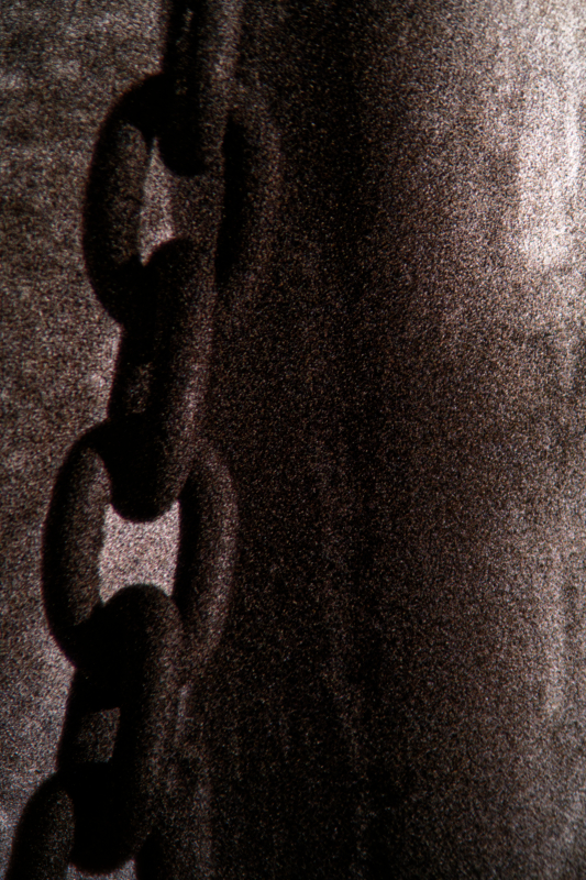

D850, el-Nikkor 80mm on tubes, AWB using white LED
D850, 4x objective + 2x F mount adapter, AWB using incandescent lamp

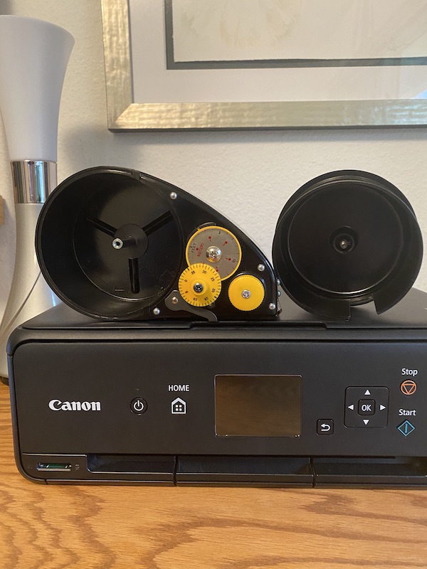

The center shaft is there and the cover is secure, the only thing missing is the piece that is fitted to the center of the bulk roll of film, then slips over the shaft to keep the film from wandering around the chamber.
From the picture, I think yours is complete. There is no additional part or roller which fits on the center post inside the chamber. The metal post you see in the center of the chamber is all there is. The bulk film roll is wrapped on a plastic center core which fits down over the post, then you put on the top and tighten its center screw down onto the threaded end of the post to hold the thing together with the film inside. The lid is rotated on the post to open and close the light trap where the film exits to the cartridge. That is at about 4 o'clock in your photo. There should be a small crank to engage and wind on the cartridge, located on the back side from this photo. Check one of the many YT videos on the "how to use" of this equipment.
