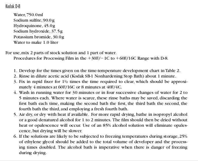

In principle
Can you prepare that formula in the attachments?

Well, no problem, my friend.
In principle
