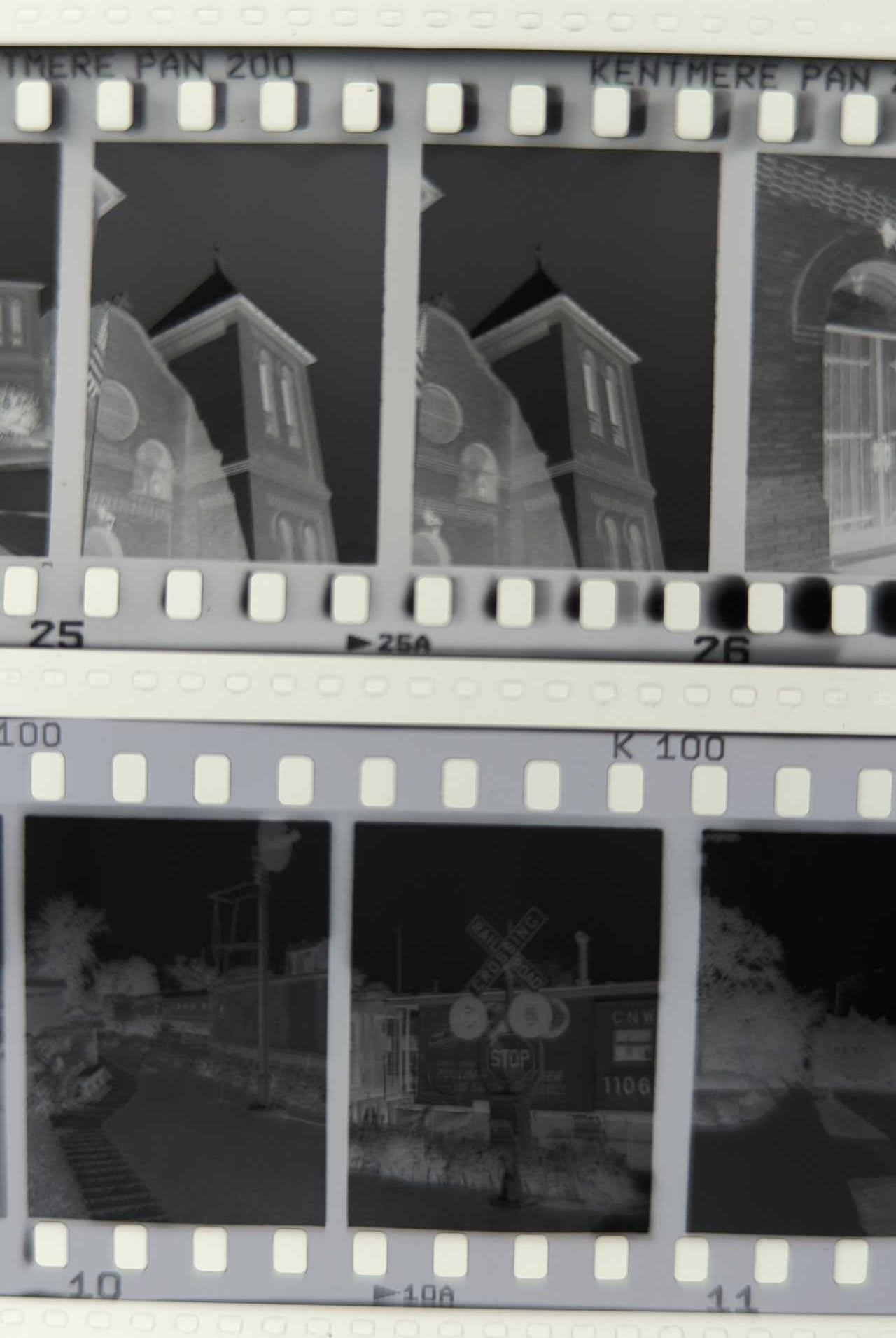

It would be interesting to see where dcy ends up in his lightsource lamp search. 25sec exposure time for a 5x7" print either indicates that the lightsource is weak or the negative is far too dense.
They do look dense (which isn't to say that the light source isn't weak; it feels weak).
Here's a comparison. The top roll was shot with my P17 for my film comparison test and I'm using it as a prototype for what a negative should look like. The bottom one was shot last year with my Olympus PEN is that I've been trying to print this week.
The lower ones are over-developed, for sure.
Actually I would consider the top ones over-developed too, but that judgement depends on what works with your equipment and materials. After a while you will be able to review what contrast grade you find yourself routinely printing on, and adjust your standard film development to normalise that to G2 or 2.5.
