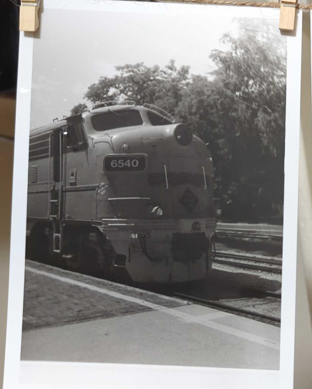

Success! My first good print.

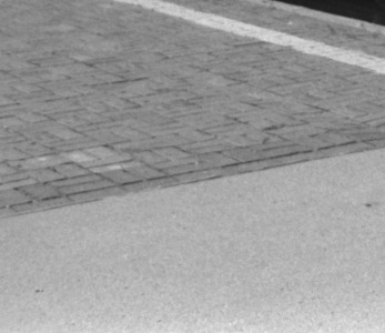

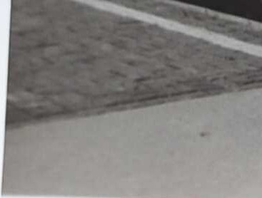

The first one. 99.99% sure.
Thanks This was the one I thought it had to be, as looking at all 3, it looks the one that has some fuzziness in the area Alex refers to. Of course I may be seeing a fuzziness that isn't there or is there equally in all three and have just been "conditioned" by Alex's post but I don't think so
What might cause this to be more fuzzy in that area I have no idea but you'd think that an enlarger with poor alignment would have affected all 3 prints equally
Others may have some ideas
pentaxuser
Yeah.
I cannot see the fuzzyness that you and @Alex Benjamin see, but I have another post with a picture of a train where I am convinced the image is very fuzzy on the corners, and I don't see that fuzziness in the DSLR scan. Below I include the scan (left) vs the print (right), and I also crop to the bottom-left corner.
So it is indeed a problem with the enlarger, not the negative.
But what do I do now? I have no idea how to adjust the enlarger plane --- I don't see any knobs to change its tilt... so either I hit the enlarger head with a mallet or I try to tilt easel so it's crooked the same way as the enlarger.
Just checking the basics: you do use a grain focuser, right?
@dcy - I should have expanded my post. I you do use a grain focuser, with the negative in, put a piece of white paper on your easel (not photographic paper). Get proper focus on the middle of the photo. Once you have that, move the grain focuser up, down, and sideways. If you're not getting the same focus all over, then you do have alignment problem.
If you are not using a grain focuser, the problem may just be that you're trusting your eyes and they are deceiving you.
Also note that the problem might have been with your old Olympus camera. I went back to your ealier post of the stop sign photo, and the problem is already there.
Yes, I am using a grain focuser, but I cannot guarantee that I am using it competently. I read instructions on how to calibrate it and I did my best, but it was finicky, and when I use it to focus, I find that the tiniest movement on the enlarger head is enough make the grains visible or invisible. What I usually do is get the focus in the right ballpark and then grab the grain focuser. I look through, see nothing, then I make the tiniest change to the enlarger that I am able to make, and then try again. Eventually I hit spot where I am able to discern the grain.
I have not been using a paper. I can try that. I also haven't been moving the grain focuser as much as I could have.
I am sure that the camera is a problem, and I'm happy that now I have a better camera. But the fact that the DSLR scan looks less soft than the enlarger shows that I clearly also have a problem with my enlarger.
Let's assume my enlarger is indeed misaligned. What can I do? Perhaps try to tilt the easel to compensate?
Oh... I have an idea: The one that came with the enlarger and a wide-angle lens I've been using lately. I got that lens to be able to make 8x10 prints out of half-frame --- with the original lens I cannot get the head high enough to fill 8x10. But the prints I've posted were all 5x7. To make those, the enlarger head had to be very close to the easel. I didn't think it made any difference, but perhaps it exacerbates any misalignment and/or focusing inaccuracy. I should use my original lens for 5x7 prints and the wide-angle only for 8x10 prints to keep the enlarger head high up.
It's always a good feeling! I still remember my first good print. It took at least 2 years of hard work. Back then, there was NO internet to help guide us along. Consider yourself very fortunate.

Yes, lot's of simple tests you can do before fiddling with your enlarger. Start by making prints with negatives from your new camera; do the grain-focusing test across the print surface; use another lens; use better photographic paper. There's a good chance your enlarger is just fine.
Yeah.

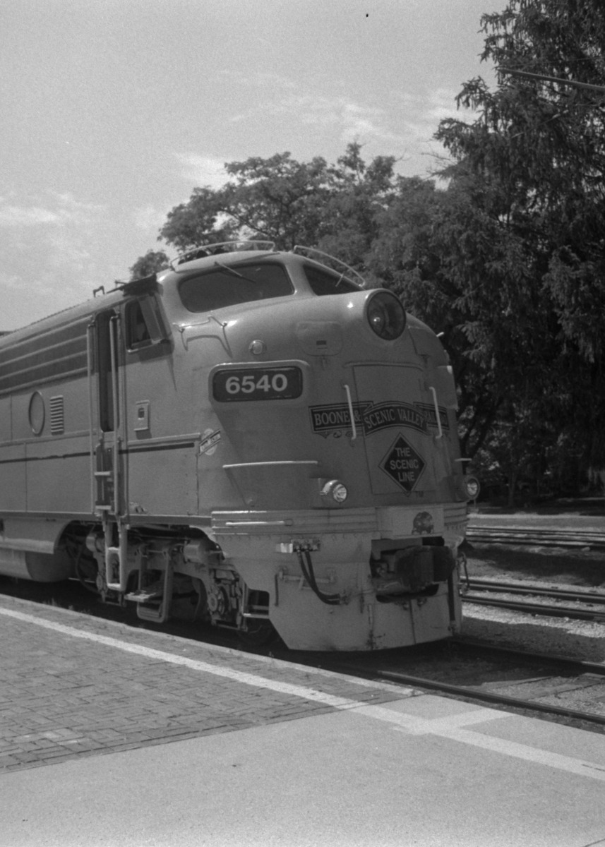

View attachment 402075View attachment 402076
View attachment 402077View attachment 402078
Yes there is no doubt that the DSLR scan on the left has produced a better picture It looks much sharper. However can I ask how you did the DSLR scan? Was this a straight scan of the negative in the sense that you used a DSLR camera to take a picture of the negative? If so then how was a straight picture by a DSLR able to sharpen the focus or alter the look of the negative
I know nothing of DSLR pictures or what a scan of that DSLR picture is able to alter However it seems to me that unless a DSLR and scan can turn a fuzzy out of focus negative int sharp focus then doesn't that suggest the negative is in sharp focus and is capable of being printed OK ?
You might ask me why I have said all this when you yourself have said the same thing, namely that the enlarger must be at fault. However is it that simple as in your case isn't both the blocks on the platform out of focus and the leaves on the bush at the top right?
Before you conclude that the enlarger is at fault it might be worthwhile to check the enlarger focus again with a grain focuser. If is of any help I too find that with my grain focuser a very fine.i.e. very slight movement of the focus knob is enough to make the difference between the grain being fuzzy and in sharp focus It can take a bit of practice to get this right
Can I assume that on your enlarger you have a knob that raises and lowers the head which alters the size of the print but is much too coarse to be used for fine focus and for this you have a focusing knob?
You may well have an enlarger that is out of alignment but if that were the case then why is your other picture, the one you are rightly proud of in terms of the enlarger produced prints in much better focus?
Just some thoughts on my part Let us know yours after reading some of our replies. Thanks

Alignment issues can originate with the negative holder as well.
But whatever the cause, it remains a fact that small prints mean that the range of best focus is going to be small.
Yes.
It can't.
My point exactly.
I saw that the leaves looked out of focus, but I wasn't sure because I'm not confident I can tell the difference between that and motion blur if the leaves are moving in the wind.
But if it was just out of focus, wouldn't the entire image be out of focus? If the image is sharper in the middle than in the corners doesn't that mean that the easel and the enlarger head have slightly different planes of focus?
Yes, except the focusing knob also feels fairly coarse. But that might be my fault again for using a wide angle lens. Tonight I'm going to put back the original lens and move the head higher. I imagine that that will make the focusing knob less coarse.
Oh.... !!!!
I didn't think of that.... And that picture was taken with the exact same lens, and the head at the exact same height...
Ok. I'm stumped now.
Thank you for bringing that up. I need to think more.
