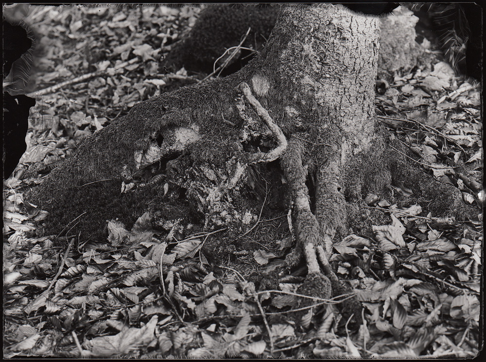

The best plate regarding tones until now (I have already had better coatings):
Best,
Sebastian
