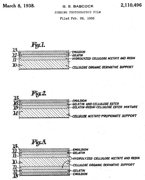

1949 US2461474 A
A film base of cellulose acetate was coated with the following gelatinous substrating composition:
Parts Gelatin 0.73 Water 1.33 Acetic acid 1.20 Diphenylsulfone 1.34 Methanol 75.53
An anti-static gelatin composition suitable for the subbing of a photographic film support, which comprises a gelatin subbing composition containing from 0.5 to 1.5% of gelatin, from 1.33 to 15% of water, from 78 to 95.4% of a solvent for said support, and from 0.5 to of a diphenylsulfone of the following general formula: which comprises a gelatin subbing composition containing from 0.5 to 1.5% of gelatin, from 1.33 to of water, from 78 to 95.4% of a solvent for said support, and from 0.5 to 10% of diphenylsulfone.
1939 US2196775 A
A cellulose acetate photographic film base made from cellulose acetate containing about 40.5% acetyl was coated with a solution having the following composition:
Grams Polymerized methyl acrylate 1 Acetone 10 Methyl alcohol After this coating had dried the following solution was applied:
Grams Cellulose nitrate 1 Methyl alcohol 40 Butyl alcohol This layer was dried and a gelatin sub was then applied having the following composition:
Gelatin g 1 Acetic acid g 1 Water cc 25 Ethyl alcohol cc 25 The gelatin layer was dried and a photographic gelatino silver halide emulsion was then applied in the usual manner.
1938 Mr Babcock US2110496 has the coating speeds and formulas! Enjoy!
Russ
Photo Engineer
Apr 19, 2005
29,018
Rochester, NY
There are several things to learn here.
1. Subbing was applied to the film as it ran over a large metal roller which kept it stiff and flat until the solvents evaporated. Thus, the film was flat. Doing it by hand loses this advantage. The support can develop wrinkles or kinks.
2. Latexes are often used as subbing layers.
3. Many supports are just bombarded electrostatically, and then plain gelatin is laid down on this charged support. It adheres wonderfully. Sometimes a latex layer is laid down instead of gelatin.
4. Metals in the subbing layer can be used, but many cause severe defects such as total fog. Tin and Iron are among them.
5. Using formalin is ok but remember it is a gas in water and is also a carcinogen.
I just buy pre-subbed film support and avoid this hassle. Or, I use plates.
PE
