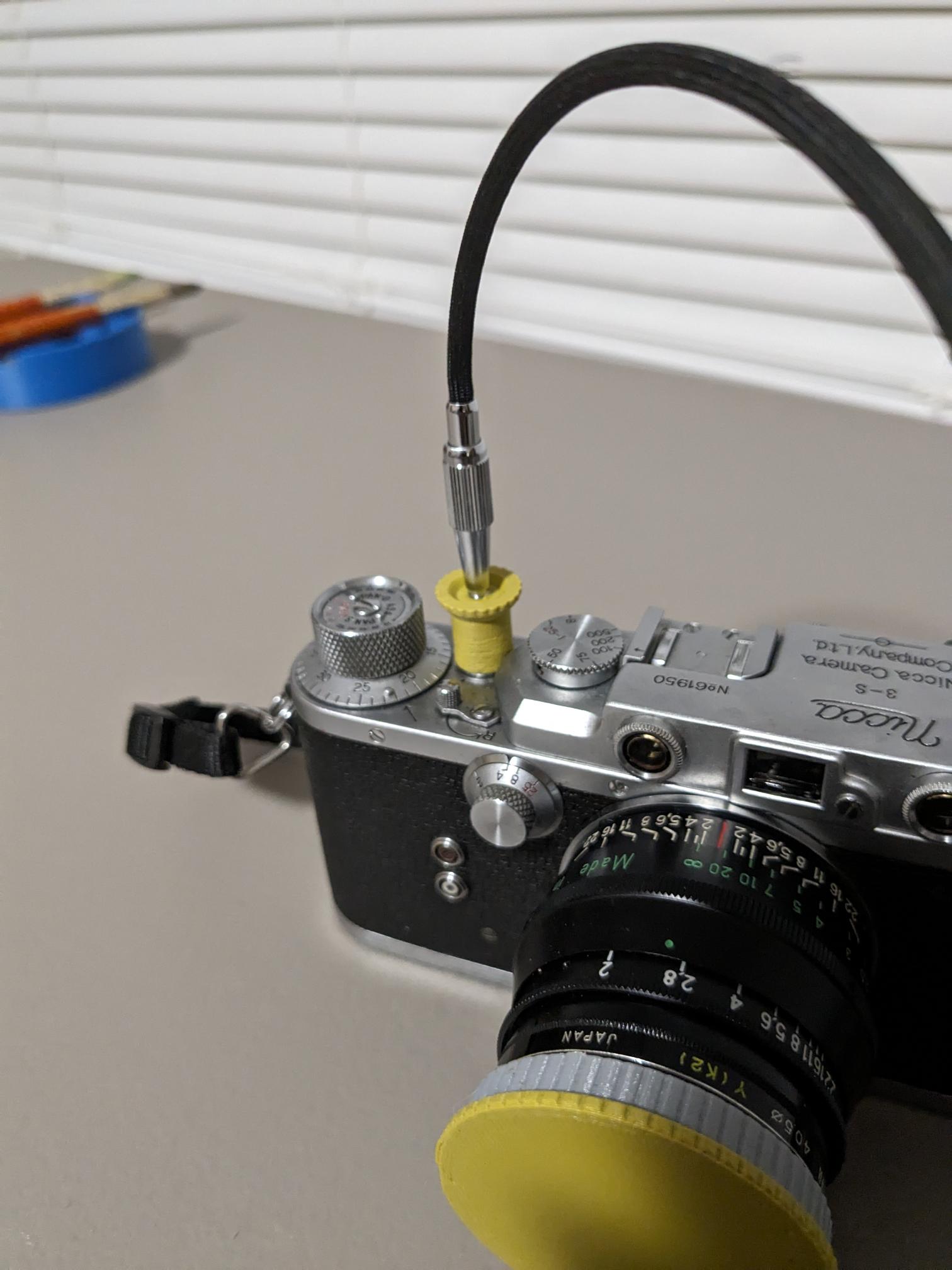

Perhaps this would work for you. But I can only say it is good on my Leica copy, not the real thing.
STL file available at https://www.printables.com/model/637289-nicca-leica-cable-adapter

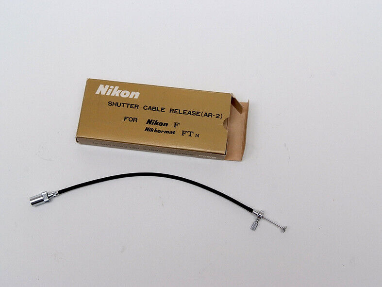

This 'nipple' should be the same for Leica as for the original Nikon F and perhaps can easily be found on ebay...
The whole thing, cable and attached typical nipple has the Nikon reference AR-2 and I saw one for about € 4,50 in Germany.
I agree, I use my Nikon F cable release with my Leica IIIf cameras and it works like a dream. You don't have to unscrew the collar on the camera, the end screws on inside the collar, equally if you've lost the collar it will still screw on to the shutter button surround.
