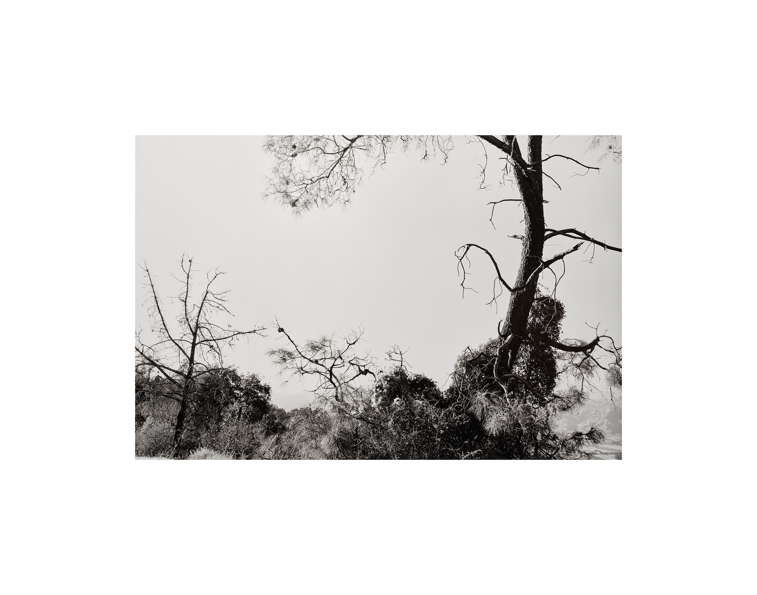

Hi! I have a negative that I really love and would like to make a print for an upcoming show, but unfortunately the negative has a bit of uneven development in a blank area of the sky that shows up in the print and I find it distracting. My first thought was to locally pre-flash that area of the print and then print as normal and hope that lowers the contrast in the highlights enough to hide the marks, but I haven't been able to test it yet. I was curious if anyone has any other tips or techniques I can apply in the darkroom to minimize the marks in the print. I'd love to get that part of the sky to exhibit an even grey while still maintaining the natural gradient of the sky.
Attached are two screenshots from scans of the negative. I did print this and it does show in the print, but I don't have the prints handy at the moment. I played with contrast to show how the print looked to my eyes (top) and then I enhanced contrast so the development marks are easily visible (bottom).
And yes, I've worked out the uneven film developing issue since encountering this, thankfully!
Perhaps print it split-grade and use the low end filter to try and overcome the uneven-ness of it. It seems to overcome it you need to print it down but that it might progress to a dull thud type of gray. But maybe cut the low end filter short and print the sky to a higher Dmin, not sure.
Thanks Chuck! That sounds pretty similar to what I was thinking re: flashing, right? Essentially printing to a higher contrast (sky brighter) and then "burning the sky in" with low contrast, or via flash, to get the tone, but hopefully without going far enough to exhibit the darker tones of the marks? I think I'm lucky that this is mostly a silhouette of trees, I'm not really terribly worried about maintaining any highlight detail in the branches since there aren't any. FWIW I was planning on printing the sky to around zone VII, but I could see this print working with the sky at zone VIII or maybe a little higher, as long as I can maintain the illusion of gradation around the outside edges of the print.

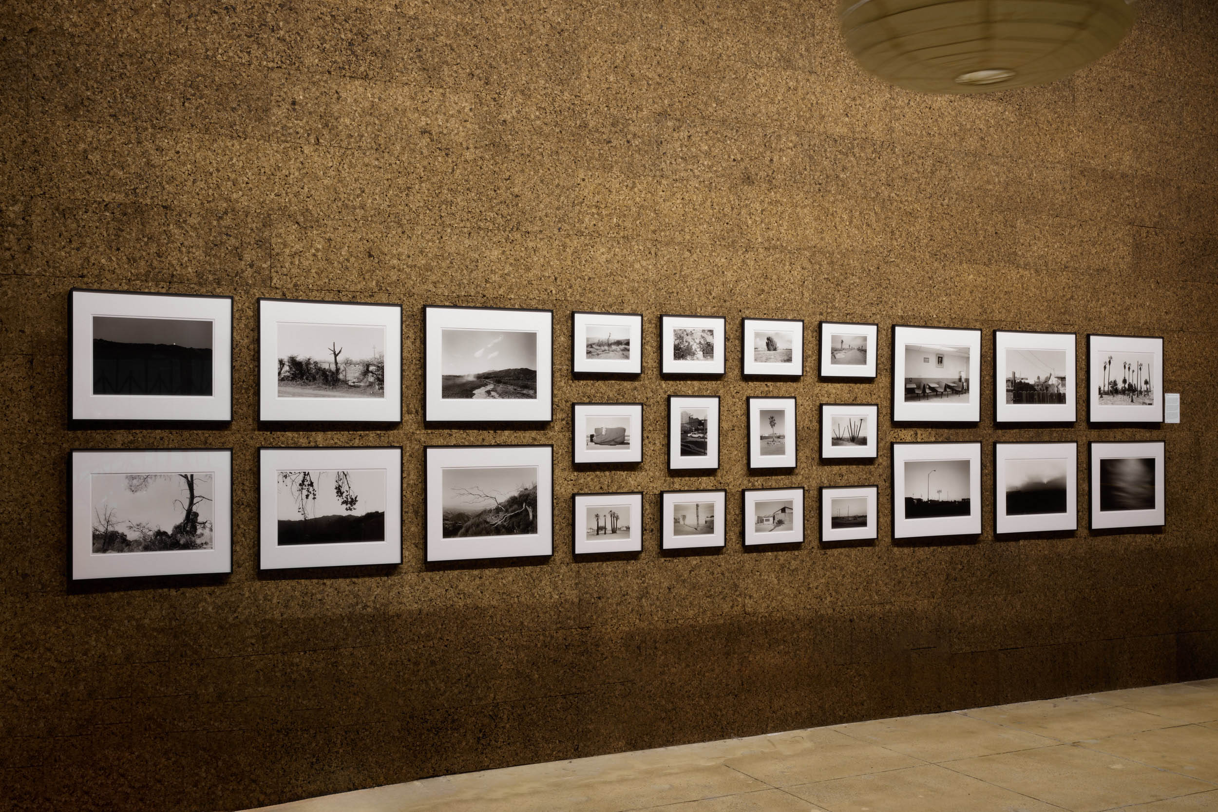

Finally got a chance to scan the finished print. I was able to flash the problematic area and then print with a high contrast filter to minimize the streaking. I'll try and post my print notes, but it was around 7 or 8 steps to get to the final version with everything balanced. Also attached a photo of the installation!

That's very nice, congratulations! The unevenness seems to be totally gone; very effective. More importantly - the entire installation is gorgeous!
@koraks Thank you! I have to admit that I was surprised at how well it was hidden while still maintaining the luminosity of the sky. Flashing really can be a miracle tool! And thank you, the show was a lot of work to put together but I'm really proud of the result. Here's a link if anyone would like to view the show virtually - https://www.jonstars.com/photographs-2018-2025
