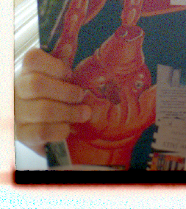

I just picked up LS-8000 scanner. I scanned slide film and I noticed strange color noise. I tried with my other Minolta 5400 II and it didn't have the issue. I am using VueScan and checked Fine mode. It seems to be noticeable when zoom in. Anyone experience the same problem? I would like to make sure that this isn't user error before I am returning the scanner to the seller. Thanks.

I did couple more testing. The above image is Slide. I tested with negative this time.
This is with Infrared off
and this is with infrared on:
Turning on and off on slide (provia above) doesn't help much.

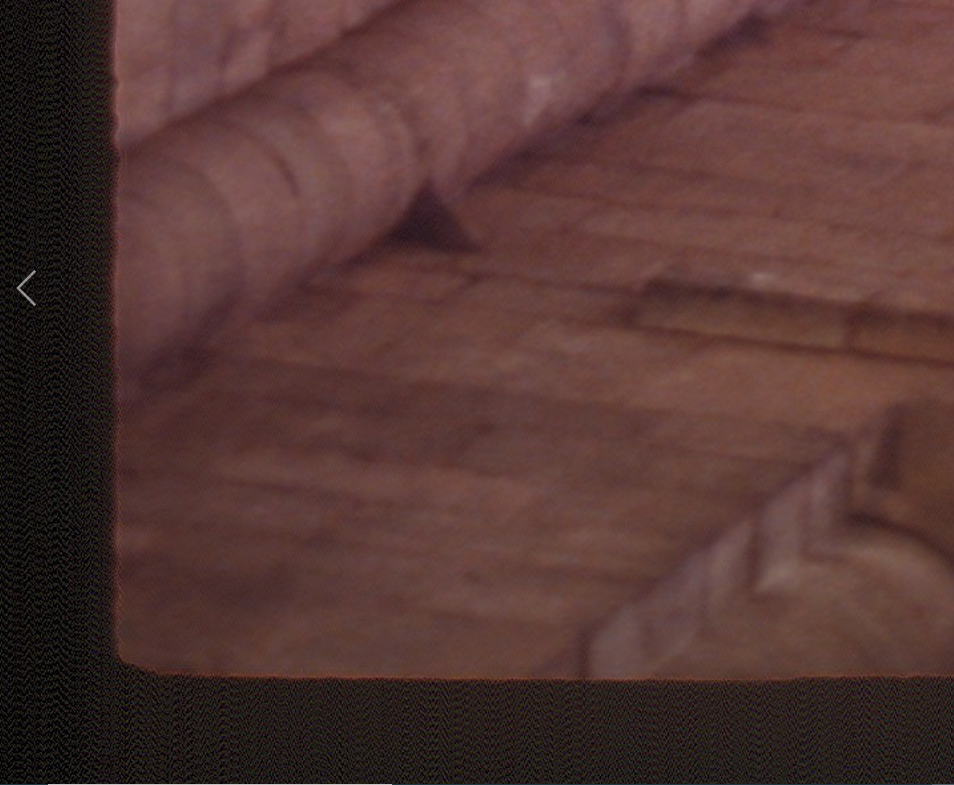

Sorry, for the confusion. The pattern is still there on negative but it's less obvious. If you look at the second negative image where I have ICE (infrared setting on Vue) on, the pattern is obvious in the film edge (white area). When I turned off, it looks much better , but if I added sharpen, I start to see it again.
um.. I didn't try multiple scanning passes. I did try multi-exposure only to slightly increase the issue. I can try multiple sampling tonight. Just curious, what can be the issue that multiple scanning passes help?
I did 8x sampling and it seems to be more obvious:

For those having difficulty seeing the pattern:
Based on what I understood about electrical noise, it should be more gaussian random. I can see pattern for each motor stepped here (so, I incline to think that this is not really noise). I joined Nikon Coolscan facebook group last night (they actually have very good info around these scanners). One of the post stated that this may be due to CCD wearing out, though, the pattern seems to not exact what I and cramaj have.
Updated: Look like the group has some fix by replacing A/D capacitors. In case, you have problem and handy with electronics.

Have a look at the pattern; the conclusion that it was electrical noise likely from the stepper motors interfering with the sensitive A/D conversion circuitry sounds really plausible to me. I'd replace the power supply decoupling caps at the A/D chip(s) and check all electrolytics as well.
