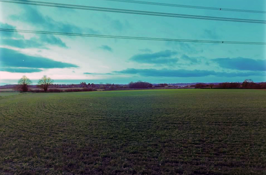

Strange low contrast in middle of negative Fuji gsw690ii

Have you looked through the back of the camera to see if the leaf shutter is actually closed? I had a lens on the RB that wouldn't close completely... It acted like a pinhole camera. 😁
Okie doke I have a film in it currently so will look when I’ve finished the roll
A partially open central leaf shutter would illuminate the entire frame, just like a diaphragm.
My guess would be a really faint light leak. Try leaving the camera out in bright light after firing the shutter with a lens cap.
Yes with both make eye and loupe on two different light boxes. Photo attached of marked spot
OK that's what I saw as well although in the one with the now attached red circle the issue looks fainter that in same scan you showed without any circle but I don't know why except that the second scan of the original meg may be slightly different

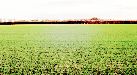

The designation "GSW" identifies the model with an extra-wide 65mm lens. Some illumination falloff is inherent to this lens out toward the corners and far edges, with the center appearing a little brighter. This effect is more apparent in a high contrast scene like you provide than a lower contrast one. You also have a somewhat higher contrast film involved (Ektar). Nothing wrong - just get used to it, and be aware when it might pose a problem versus a creative opportunity.
Light leaks look nothing like that.
Experiment shooting with different f-sops (at corrected speeds) an evenly illuminated neutral target, like a large sheet of gray matboard. I suspect you'll find that the very widest f-stops exhibit more falloff than smaller stops. But I don't own this actual lens; my own cameras are
GW690's (ii and iii) with the 90 mm lens, which has very little falloff.
Experiment shooting with different f-sops (at corrected speeds) an evenly illuminated neutral target, like a large sheet of gray matboard. I suspect you'll find that the widest f-stops exhibit more falloff than smaller stops. But I don't own this actual lens; my own cameras are
The OP's issue does appear to produce a faint purplish mark where he indicated by means of his red circle How is this explained by your answer?

I can't tell much from that web image. I'm very familiar with the film involved. But properly shading a wide angle lens is tricky, and it's entirely possible that a certain amount of flare was involved. If there was condensation or lens haze involved, then much or all of the image would be fuzzy, which is not the case.
Why would portions trend purple? (looks pinkish purple on my screen) - it's exactly what I'd expect when the usable range of Ektar starts getting bounds. But maybe that was truly there in the scene, and simply exaggerated a bit by the nature of lens falloff in relation to the native film curve.
Otherwise, I'm reluctant to repeat for the upteenth time why Ektar needs corrective color temp filtration at the time of the shot. The cyan shift in the sky is quite evident. Use the search engine to look it up, or under my own posts in relation to Ektar.
It doesn't. But the color balance of the entire image is so out of whack that it's virtually impossible to see. However, if you look closely, it trends white. This is consistent with a light leak along the lines suggested by me earlier and also @Andrew O'Neill based on his hands-on experience with a conceptually similar leaf shutter.
It's evidently not a faithful capture of reality (do you have vague white blobs in your landscape all the time? time to call Ghost Busters!), it has nothing to do with Ektar's crossover behavior at overexposure (just notice it also happens on the grass area that is not overexposed) and it certainly has nothing to do with normal wide angle lens falloff.
"Ghosts" could just be scanning artifacts. The whole color balance is out of whack toward the cyan, which could indeed be characteristic of unfiltered Ektar, or again, maybe just another post-shot symptom. Falloff is inevitable, and visible in the corner of the sky. Light leak? Very unlikely given the high reputation of the camera lens and shutter involved, and my own substantial experience with these models (and not just "conceptually similar" leaf shutters). And if that had happened, I'd expect much more dramatic evidence of it.
Another web "Whodunnit" crime mystery. Hard to say, when the evidence is so second or third hand, passing through various questionable hoops to get here. It's not like viewing the original neg directly on a lightbox using a loupe.
He should take my advice and shoot a blank gray background, and see what happens.

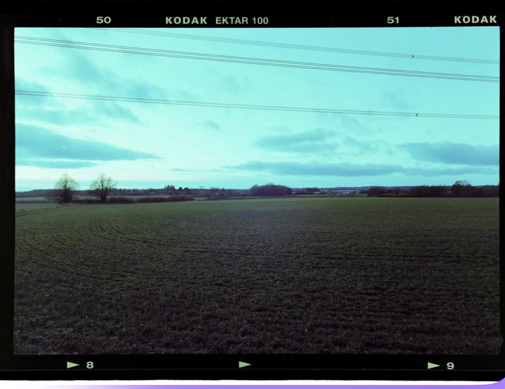

As seen in post 1:

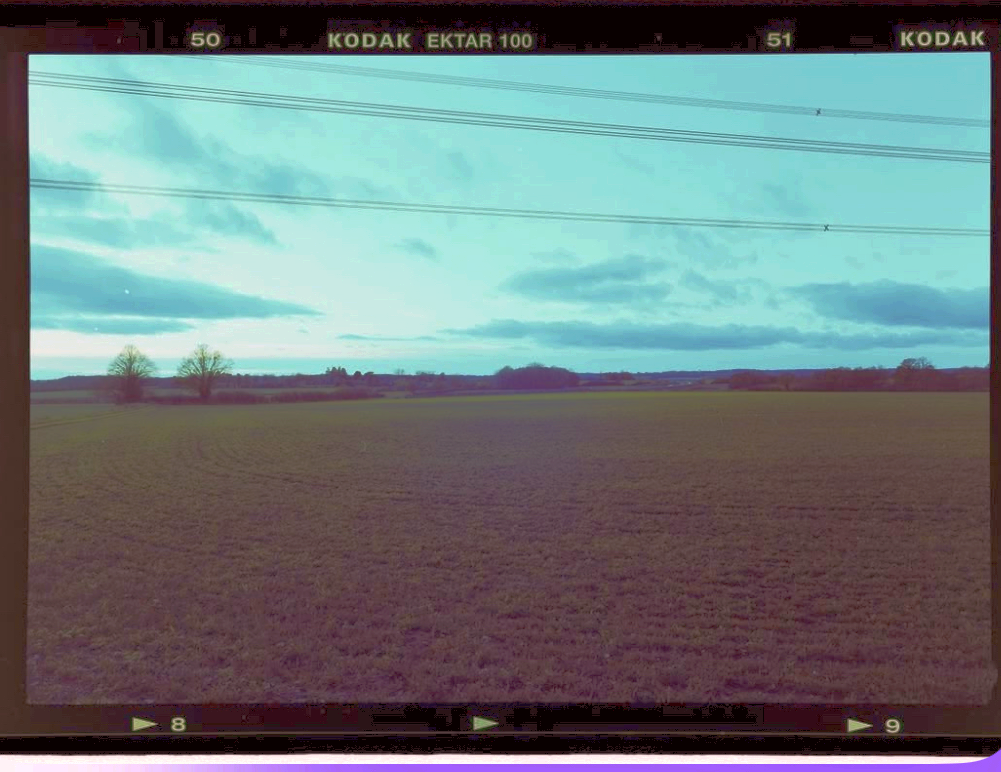

After a bit of editing which adjusted the overall cyan cast, and reveals more of the flare:
Whatever you do though, you are going to struggle with crossover - fix the cast in the sky, end up with more cast in the foreground.
On the original question though - yes, I see lots of flare, and the image chosen will make dealing with it a challenge.
Is the colour balance in his #13 OK?

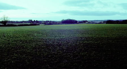

#13 is much better, just a little low in contrast. If you don't see the problem in #1, I wouldn't bother and just live long & be happy. To me it's kind of like asking "what's wrong with that guy" while pointing to someone with one leg and one profusely bleeding stump.
IF that is what the original neg shows, and is not just some incorrect scan or other digi web accident, then the atrocious mismatch I see, at least on my screen, between a hyper-cyan sky and purplish foreground, could indeed be due to incorrect color temp balance at the time of the shot, combined with crossover - something difficult to post-correct, but fairly easy to do at the time of the shot itself if one has the right corrective filter along.
I know, I know ... I get push back all the time. The difference is, I actually know how to correct it, and my RA4 prints consistently prove it. Futz around all you want in post-scan whatever. It's far easier to do at the time of the shot, and sometimes the only way to efficiently do it.
If you haven't finished the film yet, take a photo with the sun at your back and see if the spot is still in that frame. That should eliminate the possibility of lens flare.
