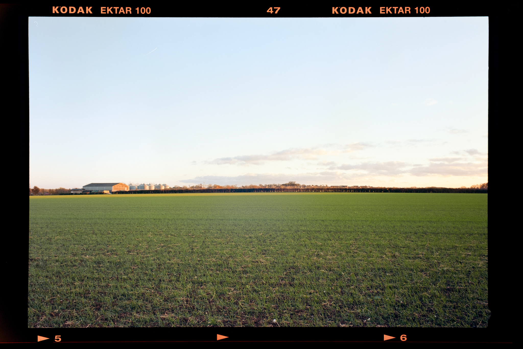

Picked up a new to me Fuji gsw690ii, on first inspection the negs that came out of it were good but after scanning (which I’ve attempted with different light sources and different cameras) I’ve noticed a strange low contrast circle in the middle, it seems to be around the middle of the roll on both rolls I’ve shot with it so far, any ideas? I’ve edited the image to accentuate problem. Some of the images are perfect

Flare perhaps?
Try setting the shutter to T, open the shutter and then shine a flashlight through the lens and look at it backlit. It's amazing how a lens that looks good will look hazy when the light is shone through it.
I am a bit confused. You say the flare is in the middle frames of the roll? Do you think this is related to the subject matter or light? Or related to development? Scanning? Any ideas why it is the middle frames on a roll?
Anyway, looks like lens ghosting. Light source like the sun, along with wide open skies, coming into the front of the lens but maybe not having the source directly in the frame. A wide angle lens will be more prone to this. You may have just found that combination of lighting to create this.
Or the rear of the lens is dirty/hazy.

Hi thanks for the reply, I mentioned the middle of the roll because I noticed it was same frame numbers on 2 rolls therefore wasn’t sure if it was a case of slack in the film or something. 1 frame was with sun setting on left and the other was with sun rising on the right.

Have you ruled out scanning? Scanning the negative in different positions to see whether the problem "moves" with film or not?
I once had a similar problem but it wasn't as localized as yours (mine had a larger affected area and was less defined). It was because to the lens haze. Well, not exactly haze inside the lens, but some stuff accumulated on the rear element and it was easy to remove.
Looks like lens flare from the "hot spot" in the sky. Is that the Sun setting, causing that bright spot?
Do you have another photo to post for further assessment?

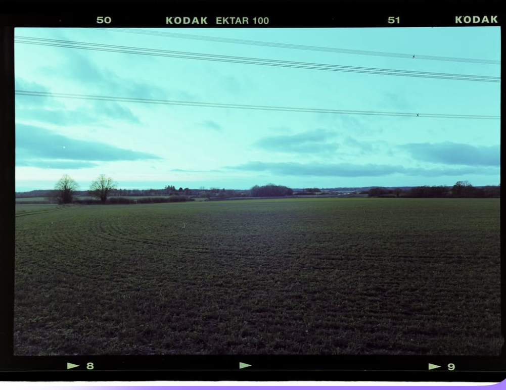

Hi there here’s a couple more with sun at different heights and directions

Are you really using a lens for scanning that has such severe distortion? If this is a result of negative not being flat at scanning this could maybe create internal reflections at scanning (although it does seem a bit much).
The first thing to exclude is a scanning/digitization problem as noted above.
I'd expect lens haze/flare to not be isolated to such a small area. Is there any sign of damage to the front or esp. rear elements of the lens? Look at the lens also from the back of the camera with the back open.
Another thought that comes to mind is the shutter on the lens not being perfectly closed; inspect in a dark room by shining a light onto the lens with the shutter closed and see if there's a pinhole of light coming through the shutter.
Statistically, a problem during digitization seems the most likely culprit.

second pic didn’t upload, yes the neg is denser in the middle so showing more exposure
Taking a photo of a evenly lit, out of focus wall should better demonstrate the extent of the problem, although it looks like there is some problem in or on the lens, like a smudge or coating worn off.

Yes with both make eye and loupe on two different light boxes. Photo attached of marked spot
