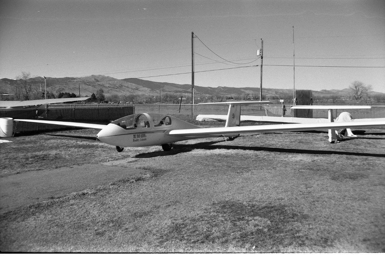

Hi,
I was out shooting with an F1 I recently got and noticed this strange light line across my negatives near the top ( fairly faint ). I use a squeegee on my film and have never scratched a negative Though this would not be a scratch, is it possible to smear emulsion and not scratch it ( not sure that makes clear what I'm thinking ). When I look at the negative with a loupe, I can see the very fine dark line going across the frame. This shows up on many of the frames. The only thing I'm doing different from the past is I have been trying XTOL instead of HC110 with my FP4+. Any ideas?
Thanks
Joel

It almost looks like a water mark, were water has dried on the film surface and left some mineral deposit of some sort.

If you look close, one end is at an angle and the other is straight up and down. I doubt this is a scratch. It is very strange. I am gobsmacked.

I think its a drying mark too.

I second the drying mark theory. I find this a problem if you use recommended concentrations for wetting agents in the final rinse, or the stabilizer solution for C41 that comes in various kits. I also use much lower concentrations.

Looks like a drying mark to me as well. I am guessing that it could possibly have been complicated by the squeegee if it left a "ridge" of water.
Even though you've never scratched a neg with it, it's inviting trouble, especially for 35mm.
As for smearing the emulsion, I've never seen that happen, it could if your wash temp is very high, I suppose, but it's unlikely at normal temps for products like Ilford and Kodak.

I agree with water marks. Rewash using distilled water and just a few drops of Photo-flo concentrate per roll of film. If you see foam, there's too much.
Sometimes it helps to make sure they don't dry too fast. The water needs time to roll down and off, but if they're in a dry place (typical in winter), then it might not roll off quickly enough and you get marks because it dries in place. I also agree that a squeegee is asking for problems. I let mine dry hanging in a shower right after I run hot water to make some steam in it. It helps to get the dust out of the air as well as letting the film dry more slowly.

I went back and rewashed the film using my tank and the line was still there. I washed it again using my fingers and some soap ( seems a bit aggressive but I wasn't too concerned with potentially losing the negative ). Anyway, after washing it this way, I stuck it back into the photo flow and let it dry ( no squeegee last two times ) and all is well, the line is gone. I do as many suggest and not use too much photo flow, typically a few drops into my tub which is 500ml or so. Anyway, good call, it seems it was a drying mark that I was able to remove. I'll have to rethink the squeegee, I have always used it because it seems to reduce such issues. In Colorado it is very dry and I have gotten large water spots before. Maybe I'll revisit building a film drying cabinet where I can better control the drying.
Thanks
Joel
