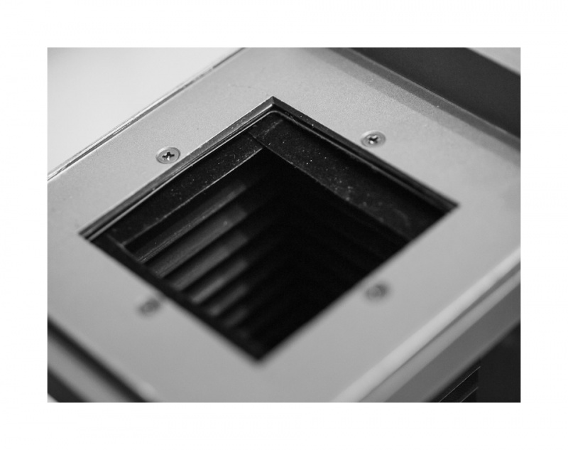

Notice how the bellows show up in the two pictures. They would be pitch black if they didn't reflect. It's images of the bellows that you see. Light goes down through the negative and bounces off the inside of the lens stage which "lights up" the flats of the bellows.
Thats what I was suspecting too. But with the enlarger on, negative in the stage and room dark I tried poking and moving the bellows up and down from outside from different sides to see if that would move or shake the stray lines. It didn't.
The bellows do show up in the two pictures when there is no negative and the opening "lights up" the flats of the bellows. I don't see the parallel lines reflecting off the bellows when I have the negative in. I see just 4 stray lines in a square pattern no matter what size of negative I put in, 6x4.5, 6x6 or 6x7.
However when I mask half of the negative off, the stray lines disappear from one side. This definitely points to the fact that the light is reflecting off of some edge on the negative stage, doesn't it?

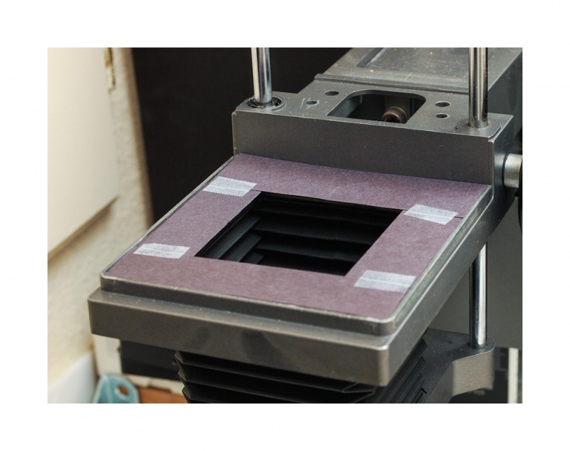

More update.
A mask with flat black craft paper that closes the opening in the negative stage (below the carrier) by 1/8 inch on each side significantly reduced the intensity of stray lights. Making the opening of the mask any smaller encroaches into the projected image from 6x7 negative.

I made a temporary mask consisting of 2 L-shaped parts that forms a square opening and that fits just above the first folds of the bellows. This pretty much got rid all of the stray lights. I just need to find the right flocking material that will fit in that space and I need to cut it square to very precise dimensions because its tricky to fit the mask in between the folds.

I owe a final update. Hopefully it benefits someone having the same problem in the future.
Two L-shaped masks made from flocking material, tucked above the first fold of the bellow provided the best solution to eliminate the stray lights. Here is a picture of the mask:

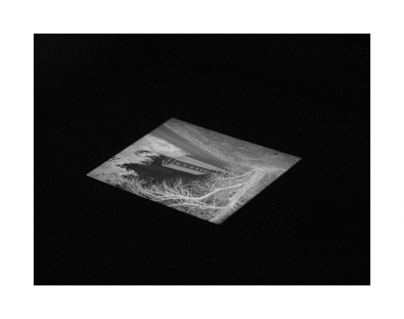

And here is a view of the projected image from a 6x7 negative. No stray lines of light visible after putting the masks inside the bellows.
