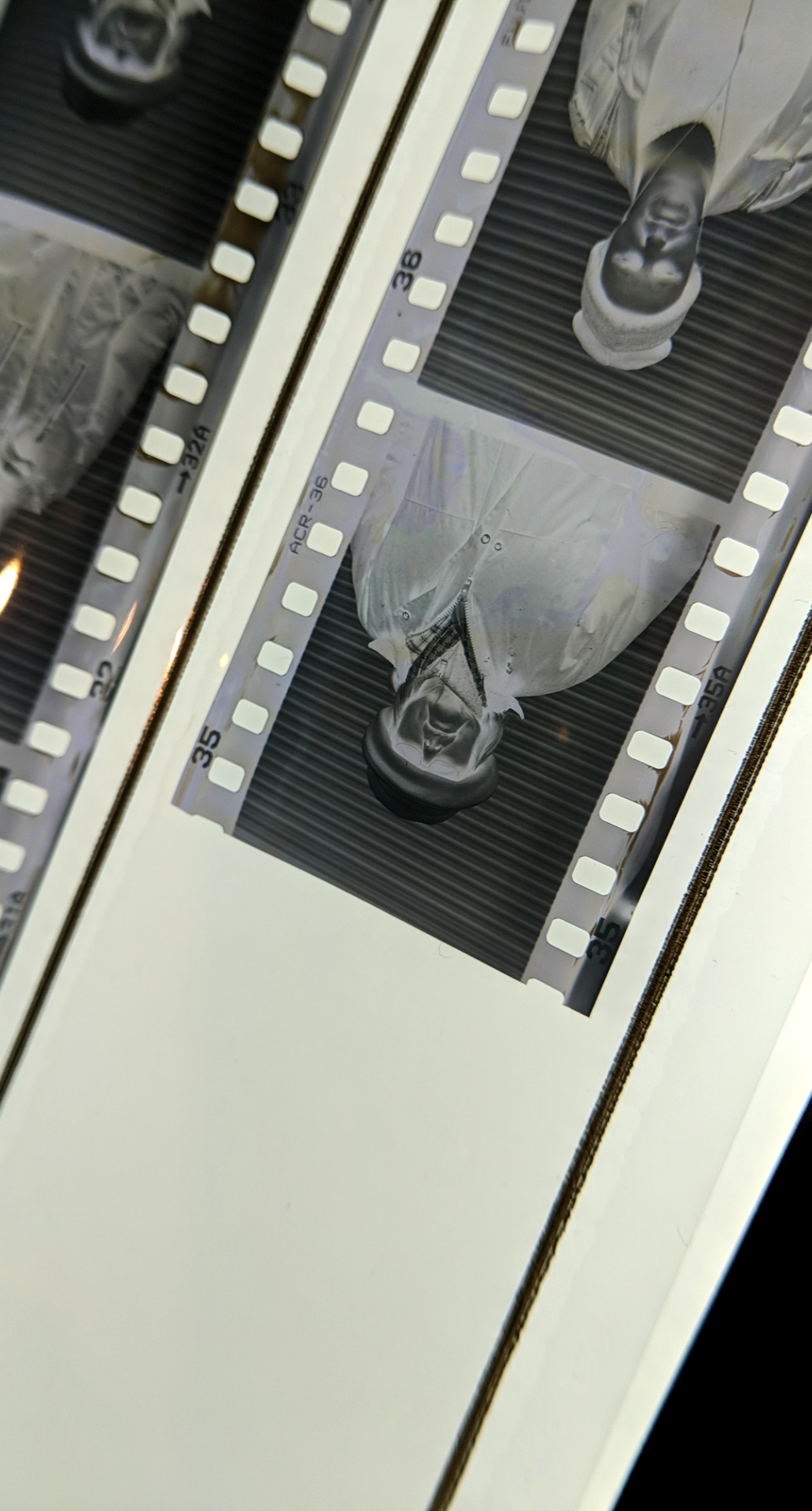

Has anyone ever developed b+w negatives, when washing them the water has come out slightly pink, and when looking at the negatives the violet cast has faded somewhat, with some patchy spots being completely clear, yet the exposures haven't been affected? What's gone wrong!?? (Acros @ 100 dev in Rodinal 1:25 6m 30s). - only happened with acros on three rolls now...

Acros wash water always comes out pink at first. I wash Acros continuously until the wash water is clear. The fixer comes out with a deeply pink color too. This fades away over the course of a few minutes.

The negs aren't streaky, but have variations in the levels of violet and are in places, clear. It's patchy, why could this be?
Do you think I should re-fix and wash them?
Also, is it normal for acros negatives to seem very grey?

I think you need more washing to remove the pink color. I wash Acros film extensively until the water drains colorless. At the beginning of the wash, the drained water is VERY pink.
Acros negatives are grey.
Hi Will,
That's your anti-halation layer coming out post-development as the fluo-pink dye.
Have you tested your fixer's capabilities to make sure it's not inadequate? Even if it hasn't, cold tap water rinse washing sometimes locks in the dye, even if you agitate wash vigorously. Wash at the same temperature range as development if you can. If you're using a fixer like Hypam [Ilford], it tends to be more prone than Rapid Fix [Ilford] and you might have to do what I do, and resort to a two-bath fixer method, preceding the fixer with a hyposulphite bath.
Depending on which negatives you're used to reading, Fuji Acros can seem strangely bland as a negative. It does have a grey base (most films do: some reversal ready films like Rollei RPX25 are clear).

I soaked the film and washed it extensively, yet the result was still the same. What else could I try?
As I said in your thread... are you sure the emulsion isn't touching each other on the reel during development? Did you try fixing it again? Dip and dunk it in some fixer to see if that helps.

Ive noticed if you use a hypo eliminator, I use Heico Permawash, the color disappears at that point. My Across negs are always nice and clear toned, no tints. Looking at the picture you posted though it looks like your fixer is not doing its job from the mottling and the edges. Do check how the film is wound on the reel.

The TO has decided to open a second thread on the same topic here, where it turns out he used Ilford Rapid fixer undiluted at "room temperature", so this appears to be a fixing failure.
