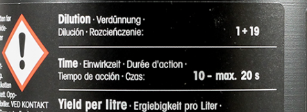

Is stopping to much possible ? I use Tetenal Indicet, there is no manual that I know of, but it says on the bottle : "Time : 10 - max. 20s"
