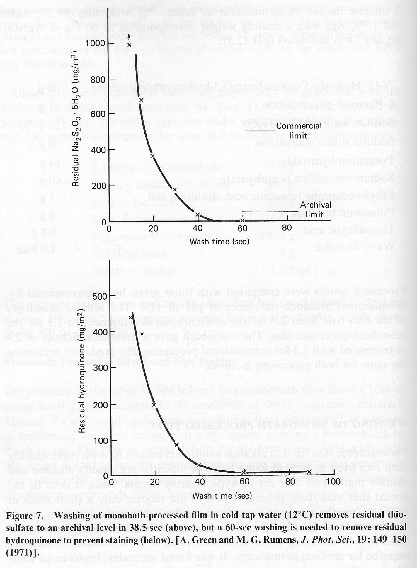

As you noted, the figure on p. 204 of volume 2 deals with monobath processing. Presumably similar principles would apply more or less to conventional processing. For those who don't have access to the book I am posting a scan of the page as other readers may find it helpful.
As shown in the figure and also noted in the text on p. 203 it takes about 40 seconds to remove the thiosulphate using cold tap water (12 degrees C, which is about 54 degrees F). It takes a little longer, about 60 seconds, to remove the hydroquinone in order to prevent staining. Presumably it could be a little faster at higher temperature, but he does not address that issue.
