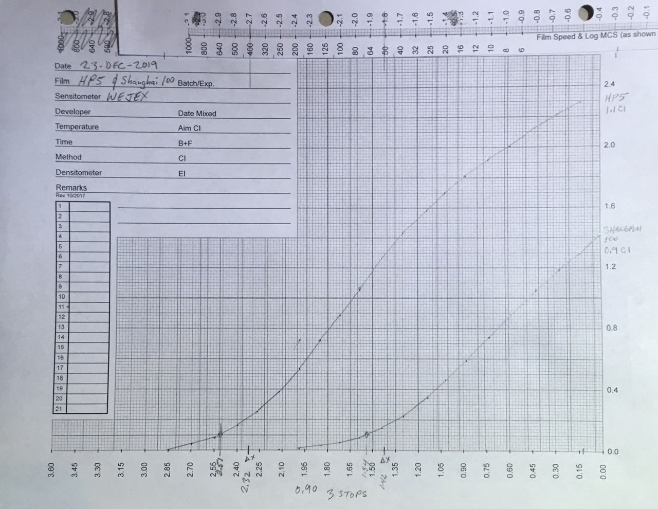

Found an HP5 curve. Not sure whose data it was (Someone like ic-racer with a Wejex).
It’s got long toe and sag in midtones. So Drew’s probably not wrong on that description.

Now per Lachlan - I have multiple binders filled with densitometer plots, all on classic translucent Kodak plotting paper. My transmission densitometer has seen a LOT of use, including plotting the characteristics of D76 on multiple films. And there is no way on earth that an HP5 or TX toe profile is going to match what you get with TMax film unless you specially tweak the development for an odd sag. That's sheer nonsense. Even the first few pages of any late classic Kodak b&w film guide spells out that categorical distinction.
TMax films were indeed designed to be relatively malleable depending on development in order to replace multiple films destined for the chopping block, including Plus X pan, Tri-X 320 (which survived), and most notably Super-XX with its "straight line" classification. But you're NEVER going to get that kind of steep toe out of the characteristic curves of Tri-X or HP5. That's why people are forced to significantly overexpose those in order to push the exposure further up the curve. That comes with side effects.
Did you ever hear of anyone trying to make serious quality color separations using Tri-X or HP5? Of course not. That's because neither can achieve a decent straight line long enough. Don't believe me? Even Ilford implied the same, and recommended only FP4 for that application among their own film selection. Kodak had Super XX and a similar special Color Separation Film, and then switched to TMax 100 for that application, which was once a significant part of the industry. Those varieties of color printing have diminished, but the characteristic curve of TMax hasn't changed except with an improvement on the shoulder of the curve between the original and latter versions. All this is common knowledge which anyone can read for themselves if they take the time to look it up.
Firstly, that's for a 1.1 CI, so of course on initial visual inspection, the curve shape looks a little off kilter. Secondly, if you properly normalise the data against other 400 speed general purpose B&W films (e.g. 400TX, TMY-II, Delta 400) you'll find that they all have very similar (to the point of near identical) toe shapes, which are regarded across the industry as 'short toe' for these purposes (if not in Drew-world). If your sensitometry is up to scratch, you should find that 400TX's toe will plot in line, if you allow for the shadow speed differences. They also have similar mid-tone characteristics, with HP5+ tending to sit in the middle between 400TX's slightly bumped up mids and TMY-II's slightly darker mids - if anything, HP5+ plots a straight line between them - this is also clearly obvious if you print them in the darkroom. Finally, D-76/ ID-11 seems to still be the reference developer that was used for these materials, so it should deliver the optimal results that the materials were designed to deliver. And finally, much as it will shock those who are desperate to clutch their pearls, Pyrocat HD is effectively a D-76 derivative too, so there are no excuses allowable in that direction either.

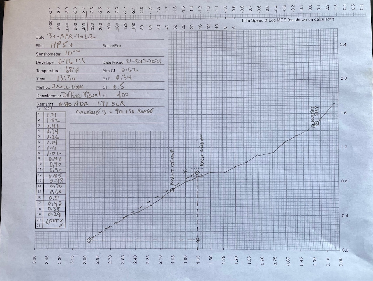

Found another HP5+ curve, a little low of normal and toe data was lost (I exposed the test strip a little into the leader and wiped out some steps.)
13:30 at 1:1 is a good time though.

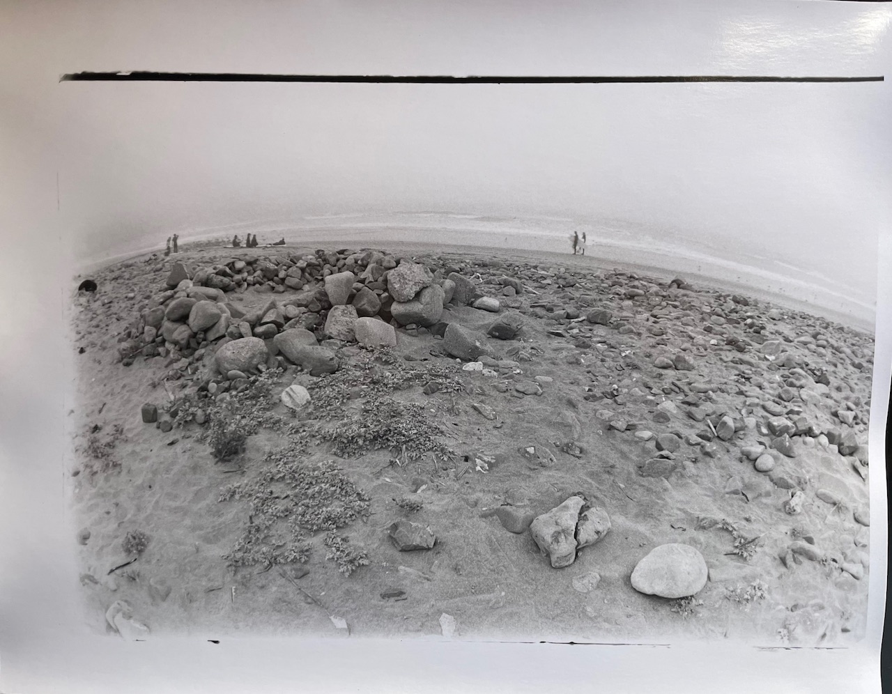

Here’s a print from that roll.

Lachlan - the first HP5 plot Bill posted (the smooth professional looking one) looks exactly like what one should expect. It's even how the published curve would look if it was bigger and if Ilford didn't lop off the shoulder in those tiny graphs. Less development would further exaggerate the sag and the toe length. Otherwise, the proof is in the pudding. I've simply printed way too much HP5 to a very high level of success to be fooled by certain rants.

Now if you mean Grade 3 diffusion enlarger, see my print. That’s what you get with 0.5 Contrast Index.
If you mean Grade 3 Condenser Enlarger, I would have qualms about mottling or uneven development unless diluted or otherwise soft-working developer were used, because now you’re aiming for 0.38 Contrast Index. You need to be careful under 0.4 CI
