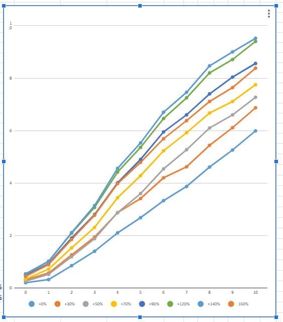

I've made a controlled lighting setup with a light box and gray scale pattern from 0 to 10 stops.
I was doing single shots of HP 5 with same exposure parameters but different development times.
I was doing single frame development in 12,5mL of stock DIY D-76.
12,5mL comes from my approach, that I normally develop 36 frames in 0,5 L of stock D-76.
I just divide 0,5L / 40 = 12,5mL of developer per frame.
I found that when I develop for 7:30 minutes, my negative comes with dynamic range of about 5 stops.
I gradually increased development time up to +170%, and found that dynamic range goes up to 9,5 stops.
I built some sort of H/D curves and at max dev time, curve look quite good, I would say.
There details in both shadows and highlights.
Did any one tried to go that far with development time?
Does it make any sense to any one?
160% shows lower performance, probably because developer was 24h old and was stored in a bottle with a lot of air

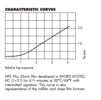

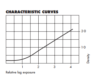

Looking the characteristic curve of HP5 Plus film
I can see that maximum density is around 10^2 = 100 times ~ 6-7stops
to achieve it 10^4 exposure must be provided ~ 13-14stops
to achieve it 4-1.5 = 2.5 log exposure has to be done, which 8-9 stops
in my test I was able to provide 10 stops of exposure, which is around 10^3 = Relative log exposure = 3 and expected density according to datasheet is 1.5 = 5 stops.
looks like my 0% curve is very close to one in datasheet
Your curves for +140% or +160% seem, by eyeball, to have a contrast index of close to 1(!!!). The response of enlarging papers being what it is, even a flat-lighting scene would require grade 1 or 0.
What is the goal of your tests?
What do you call dynamic range? Seems that what you call dynamic range is the range of negative densities (the vertical axis in your plot, counted
yes, on vertical axis range between min and max densities is shown.
this range is measured in log2's (steps) instead of log10's (density D values)
on horizontal axis represents expected values of densities (stops)
the closest match between expected and actual densities looks to be at +120-140% of recommended development time by Ilford.

I'm just trying to fit as much information as possible into the negative, to have lots of details in highlights and shadows.
In my understanding, most details are captured at 45% degree inclination of the curve, when scene is mapped 1:1 to the negative (at least 9-10 stops of scene, whole scene is much wider of course).
Isn't it "good" to try to achieve this goal? To map most of of the scene to linear part of the curve and have contrast index lose to 1?
I think I've got my problem. There is no need to mach 1 to 1 scene dynamic range to film densities.
Scene dynamic range should match film exposure range, that film can accept and produce density on linear part of the curve.
from this curve, Dmax - Dmin = 2.5-0.25 = 2.25 = 10^2 = 100 = 7stops, but this value is irrelevant
exposure range is Emax - Emin = 4.5-1.5 = 3 = 10^3 = 1000 = 10stops, this is how much scene dynamic range can be captured on the film.
My question is (was) do I develop film correctly in D-76, is 7:30 correct time, do I get same curve?
At 10 stops of exposure, I should get 7 stops of density.
I didn't, I get only 6 stops of density, that means film is underdeveloped.
I do get 7 stops of density at +30% development time.
My correct development time for HP5 should be 9:45.

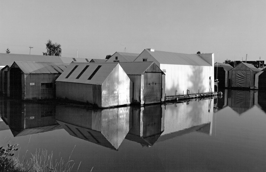

Yes, a print can never come close to capturing the full range of a typical scene. Of course, a photo of a black cat in a coal mine taken in total darkness would be an exception. And of course, light emitted or reflected is still....light.
In some ways, a measure of a print's quality is how well it- the print - recreates the effect of real life "capture".
Our minds translate what we see in a print into a perception of range - sometimes incredibly effectively.
This digitized facsimile is of one of my prints that does that fairly effectively.
Objectively, I realize that the print doesn't physically have the same range as the original subject. But the subjective perception created by the print does emulate that range.
Very nice Matt, you have captured the elusive "luminescence" in the print. I have tried for years to get that and failed.
There is no "dynamic range" in photography.
"High-dynamic-range photography" is a commonly accepted term. I believe we all understand that the dynamic range of the negative (or a print) is the range between the lowest and the highest density. Similarly, it could be used as a broader term for the Subject Luminance Range.
Great photo! Could you please share the technical details of this image (film, metering, developer, paper, etc)? It would be both instructive and relevant to the subject of this thread.

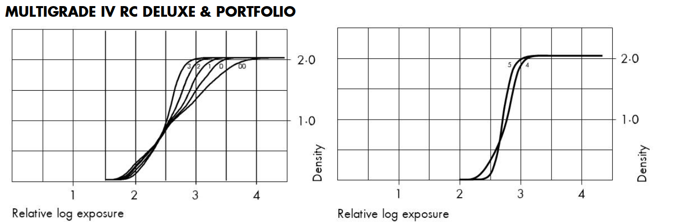

Looking at these curves, paper is only able to represent 6-7 stops of SBR/SLR.
While film is able to capture 10 stops and compress them into same 6-7 stops of density.
If paper was able to capture same 10 stops of densities, then we would get completely different results on paper.
It has been in the Gallery here since 2009 :smile:
Some of the technical details are listed there.
I have made a number of different prints of it over the years. My current favorite is on Ilford Cooltone RC Glossy, and has the benefit of some sepia toning, which tends to cool the image tone even further. The most recent prints are also slightly lighter.
But most importantly, and perhaps most frustrating for those interested in technical details, I don't think its success depends a lot on those technical details.
The success comes mostly from the subject - its wide range of reflectance and the near glass-like water - and the nature of the light - direct and low in the sky, and slightly warm on a clear day. That and my visualization of the result.
I probably just used an incident meter reading, because my location on the shore was bathed in the same light as the boat sheds. I generally meter at or near box speed, and my development times are at or near manufacturer's recommendations. I think this was before I started using HC-110 replenished, but I'm not sure. In any event, the light, the subject and the lenses on that Koni-Omega (which I now regret selling) would have meant that I didn't stray from my "normal" development.
The image benefits from careful printing: just enough low contrast burn to give a hint of detail in the near specular highlights, just enough high contrast burn to deepen the shadows slightly, and just the right amount of moderate contrast overall printing to give the mid-tones the "snap" that rewards.
