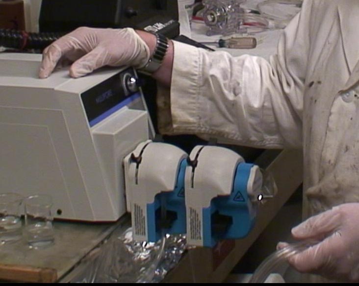

Dual pump delivery system
Here are two quick load heads on a Masterflex pump set up to deliver silver nitrate and salt solution at equal rates to a making kettle.
This dual run can approximate a controlled vAg environment without computer control and can give highly uniform emulsions.
PE

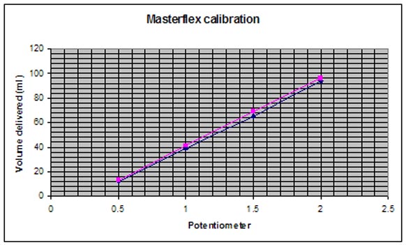

Calibration
Once you have a pump, you must calibrate it in terms of voltage (potentiometer reading) or RPMs (timing rotations) and measure the output in milliliters.
This is a calibration curve of the Masterflex pump shown above. The two lines show the curve for both heads pumping distilled water.
Every pump head and tubing combination must be regularly calibrated to insure exact flow rates. And, as tubing ages, the flow rate, due to softening of the tubing, changes gradually. Tubing under the rollers of a peristaltic pump must be flexible and must be replaced regularly.

Interesting...
How do you set it up for voltage (potentiometer) reading?
Is it really necessary if the device has a speed controller (1-10) ?
Would a speed controller (1-10) be the same thing as a voltage or potentiometer reading control?
I think so but I might need some sleep.
What is the (time) unit in the graph?
One Minute?
(mL./min ???)
All data is collected over 1 minute. The potentiometer is the speed controller. All pumps must have one. I was half asleep when I posted that after doing most of the work and running the plots all day on and off in the DR.
PE
PE
Perfect,
I was half awake when I read it!
Just curious though, what is the unit of potential(?)
Does it have meaning or is it just a guide, like the numbers on a volume controll knob.
Is this range of possible flow rates typical of the what one encounters in professional work?
The potentiometer setting is a vernier knob on the Masterflex pump that merely connects to a variable pot in the device to alter voltage. It has no bearing or relationship to RPMs or flow rate other than what you physically measure. Flow ranges in professional work range from flows that are barely measurable to flows that cannot be controlled by any pump, and must be physically dumped in for the proper effect. The range over which a given pump and tubing setup works is called its turndown ratio.
If a pump has a turndown ratio of 1:50, then the nominal minimum controlled flow must be 1 (something - RPM, ML, whatever) and the max is 50 of the same unit. A ratio of 50:100 is measured the same way. At Kodak, we keep a stock of various pumps that have different ranges and that measure in either ML/Min or G/Min (volumetric or gravimetric).
PE
