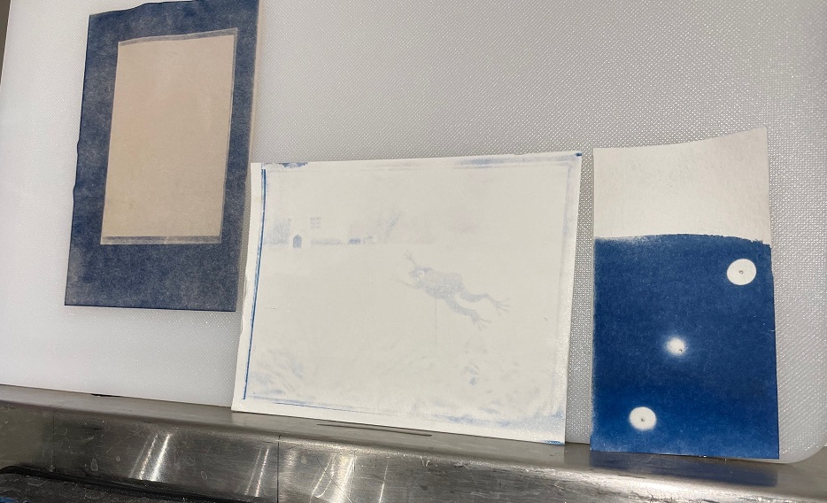

I grabbed the paper out of the water as the image floated off and took the above picture, but the image washed out completely in 5 minutes.
The Canson XL is practically blank because the negative covered the entire paper surface; only a few details managed to register and those pretty much disappeared with washing.
View attachment 361895 View attachment 361896
The Crown Jewelz is on the left, the Canson XL is in the middle and on the right. The rightmost bit of paper was a scrap I coated and stuck push pins through as a test strip for 10 minutes. As I said, the clouds are blowing through with pockets of bright sunlight occasionally; the test sheet was in full sunlight.
I kept checking exposures on the Canson, but it never seemed to increase beyond the density above, so I threw caution to the wind and processed them both.
BTW, all were splashed with Hydrogen Peroxide after washing.
All in all, not a success, but now I at least have a notion of what it takes to coat the paper and expose it.

XL is a particularly "hard" paper meaning it is sized to retain watercolor on the surface longer. May be that's why student like it - if you make a mistake you can just lift it off. You might need to use a surfactant like T-20 which will help the sensitizer to sink in the paper better reducing the probability of it being carried off in the wash.
:Niranjan.
Agreed. Some papers are a lot of hard work to get to work well.

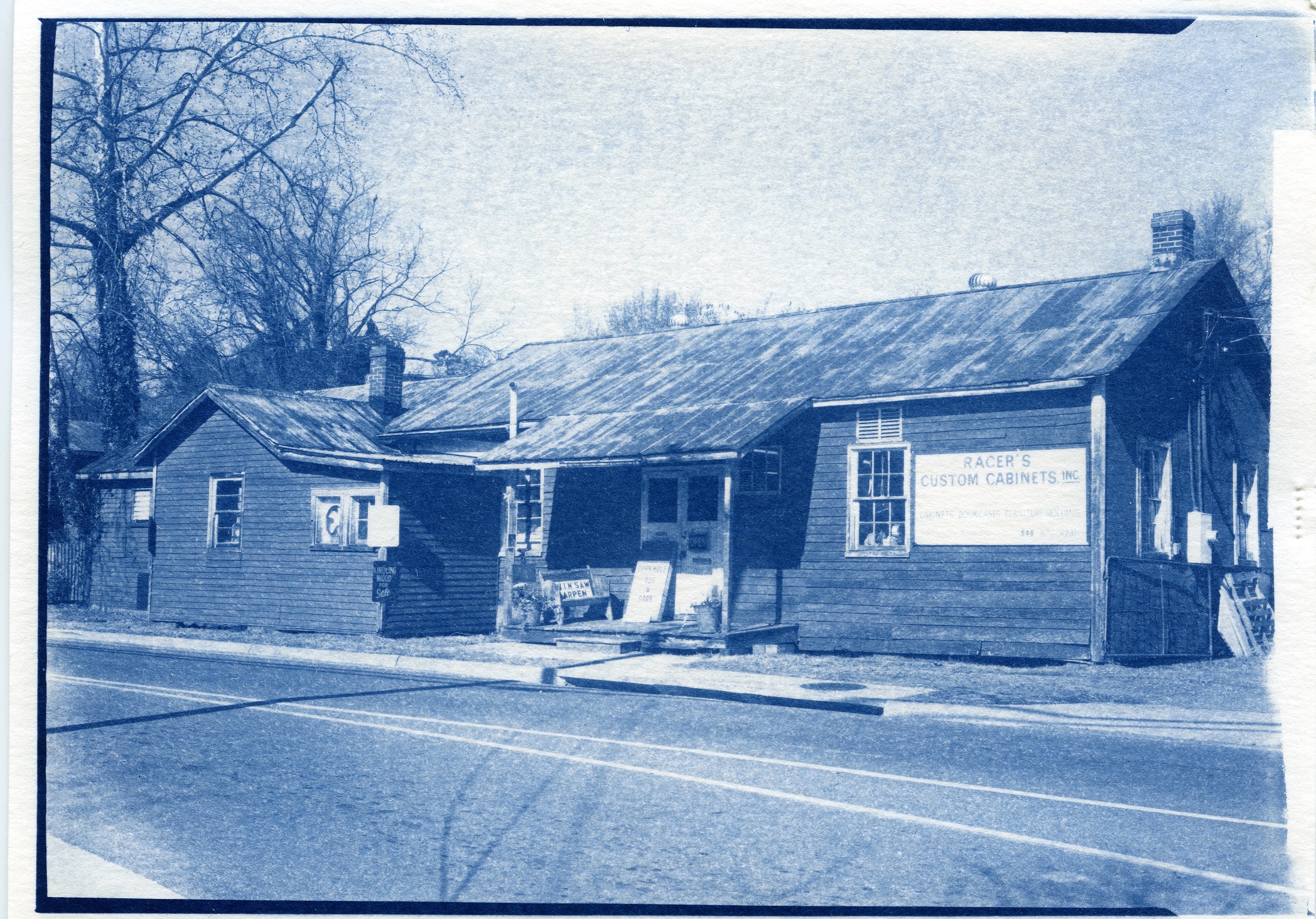

Better results today. 35 minute exposure direct morning sun. Same chemistry and paper, so it must have been the cloud cover...

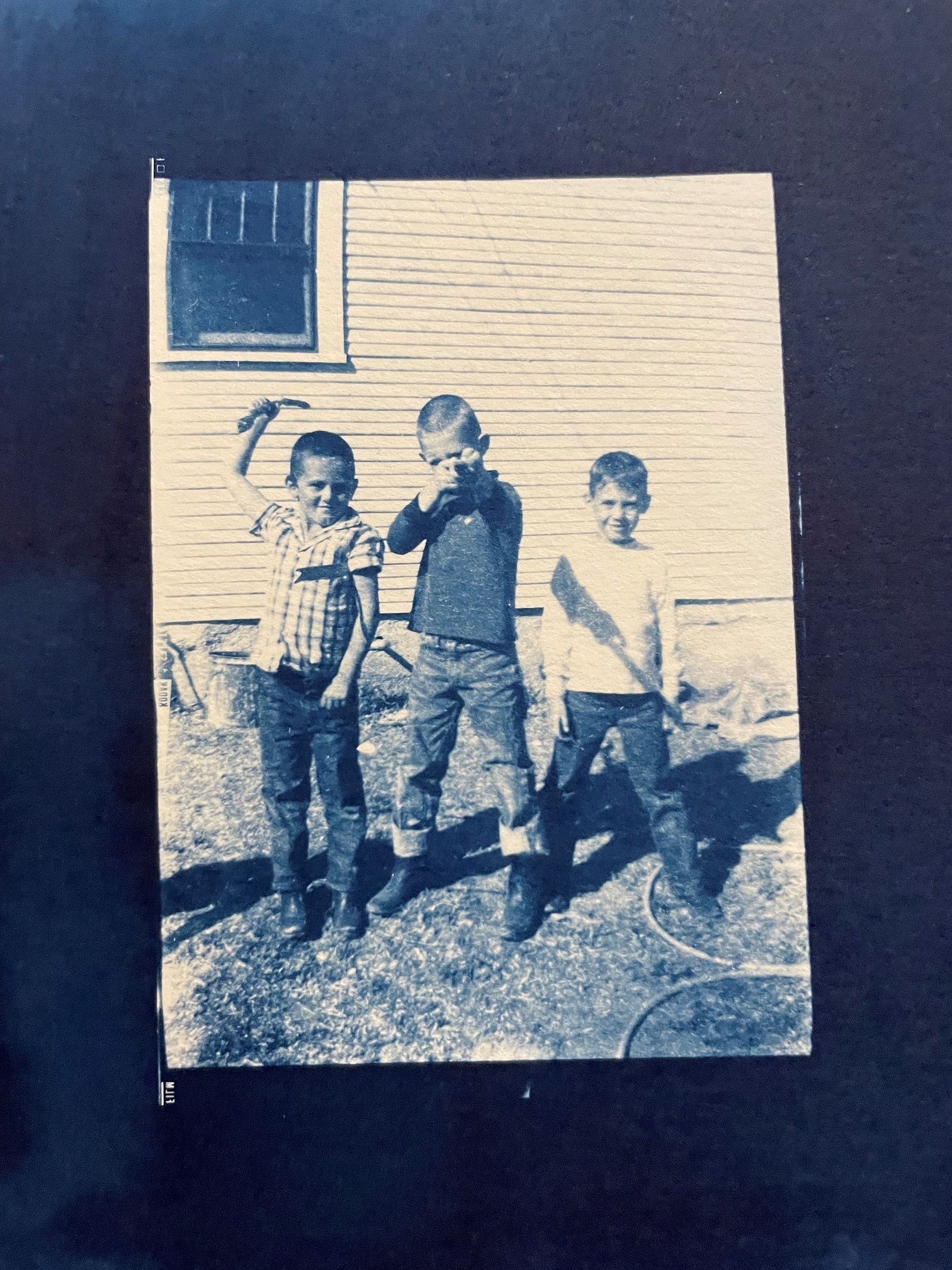

One thing I discovered today about Canon XL paper (at least for my circumstances); don't pre-soak your paper in water and ascorbic acid; don't even soak it water before you coat it.
The ascorbic acid kicks-in a sort of fogging and blows your contrast range; see below. The image looks highly solarized when it comes out of the printing frame. Actually, it looks better unprocessed!
I had the best results just coating the paper dry. I actually triple-coated the paper this time and plan on doing so in the future.
Ascorbic acid treatment on left and dry coating on right.

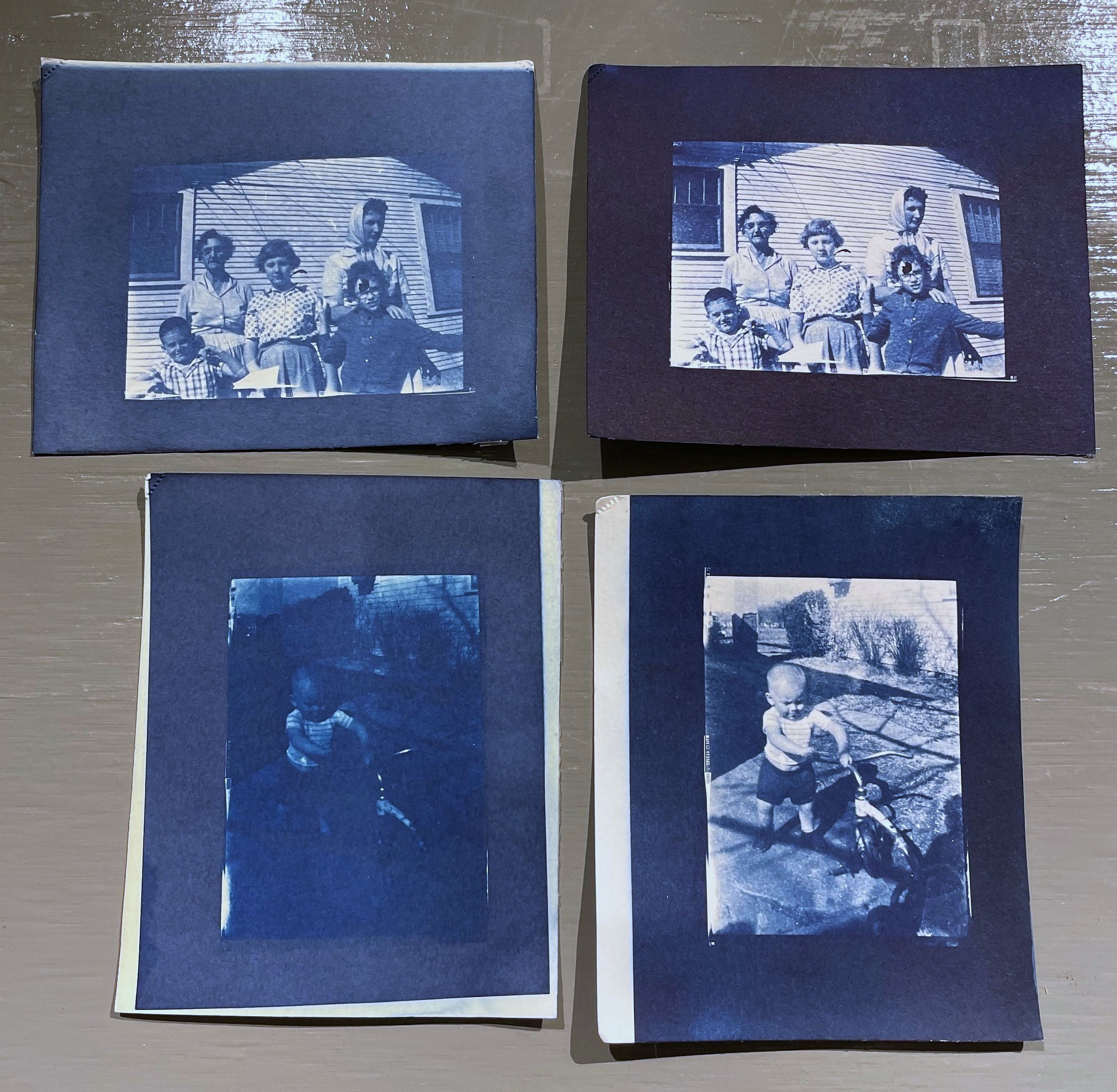

Getting closer to what I want.
After ordering fresh chemicals from Artcraft, I left the Ferric Ammonium Citrate at 100 grams for Solution "A", but increased the Solution "B" Potassium Ferricyanide - Green to 80mg from 40 (500ml total each solution).
I did not dope with 1% Dichromate this time, but will try that tomorrow to see what happens.
Both shots were coated on dry paper; no pre-treatment.
30 minute exposure direct evening Sun (LED strips are still on order).
Still would like a bit more density, but the detail seems to be there.
Will try extending exposure to 40 and 50 minutes tomorrow, provided we have clear skies and no clouds.
First photo is with Canson XL cold press 300gms and the second with Strathmore cold press 300gms. Both exhibit a bit more texture than I like, but I was surprised the Strathmore surface held-up better than the Canson, as it appears more textured before coating.
Sorry for the same images again and again, but I am trying to dial this in for my situation and need apples to apples.
