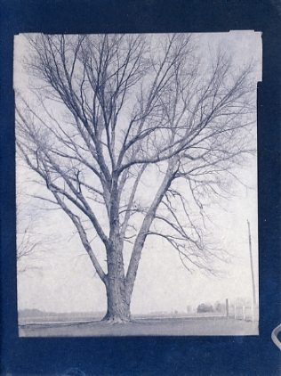

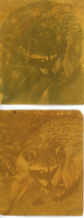

Edit: adding an unadjusted scan of a classic cyanotype on Canson XL. FP4 4x5 contact print.

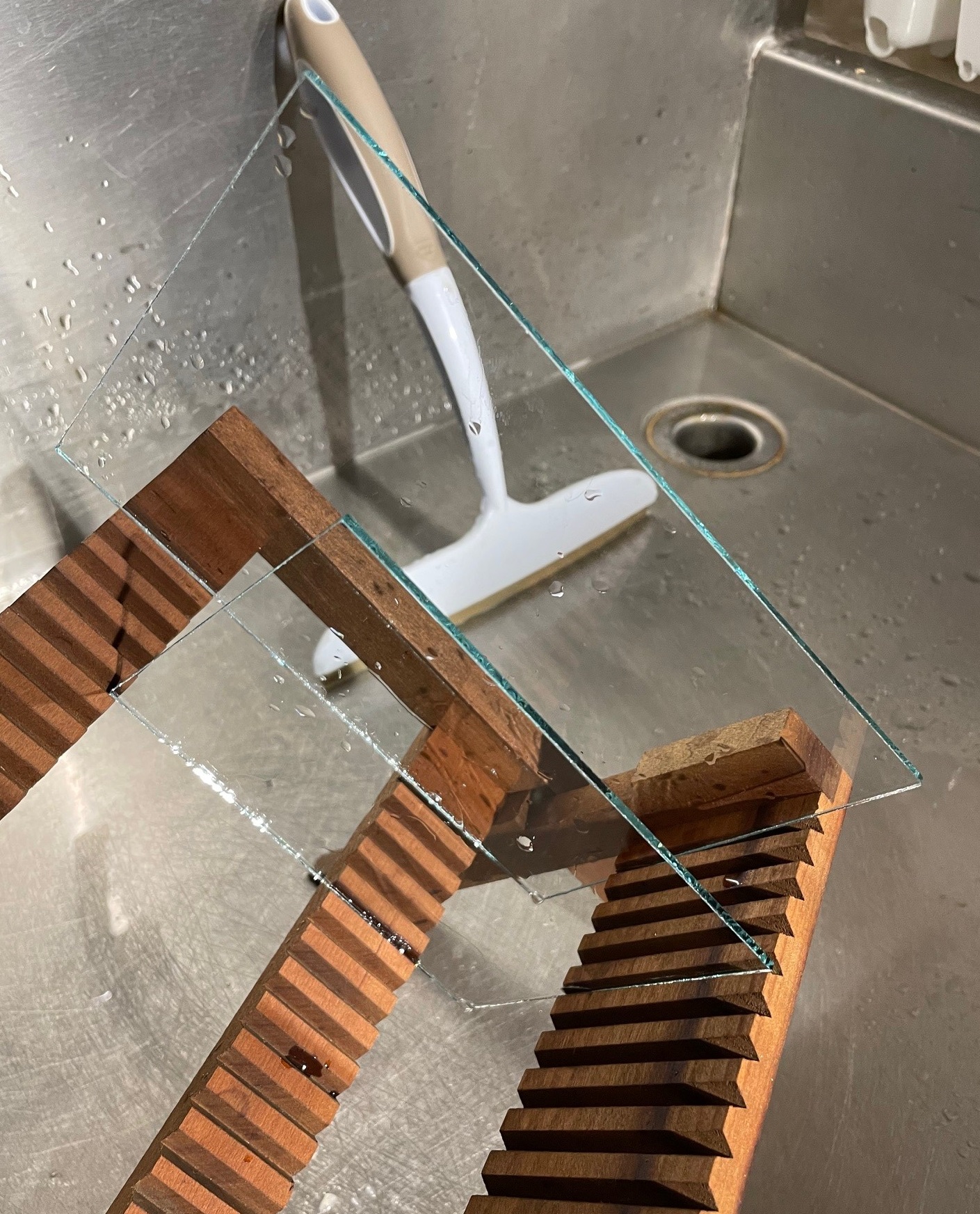

Got some Canson XL cold press paper (it was the only name brand mentioned above), sheet glass to refresh my printing frames, and found Alum, Gelatin, Arrowroot, Xantham Gum and Citric Acid at a "Amish" bulk food Store. While not all of the supplies apply to Cyanotype, I keep seeing them mentioned in alternative printing processes and they were much cheaper than ordering from a photo chem store, so I grabbed a sample to keep on hand.
Boiled and bottled the Arrowroot sizing (messy stuff) and cut the glass for my printing frames this afternoon.

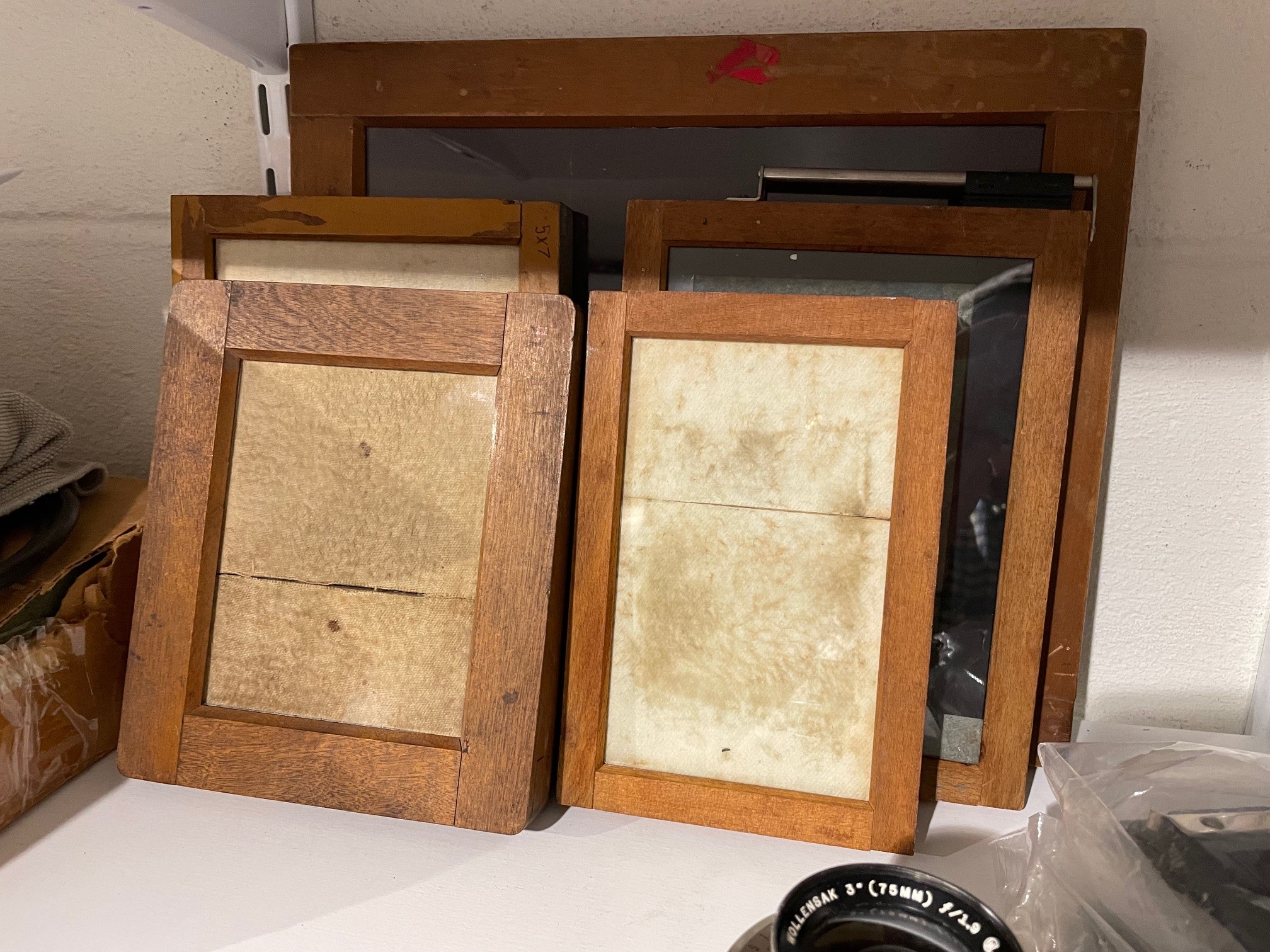

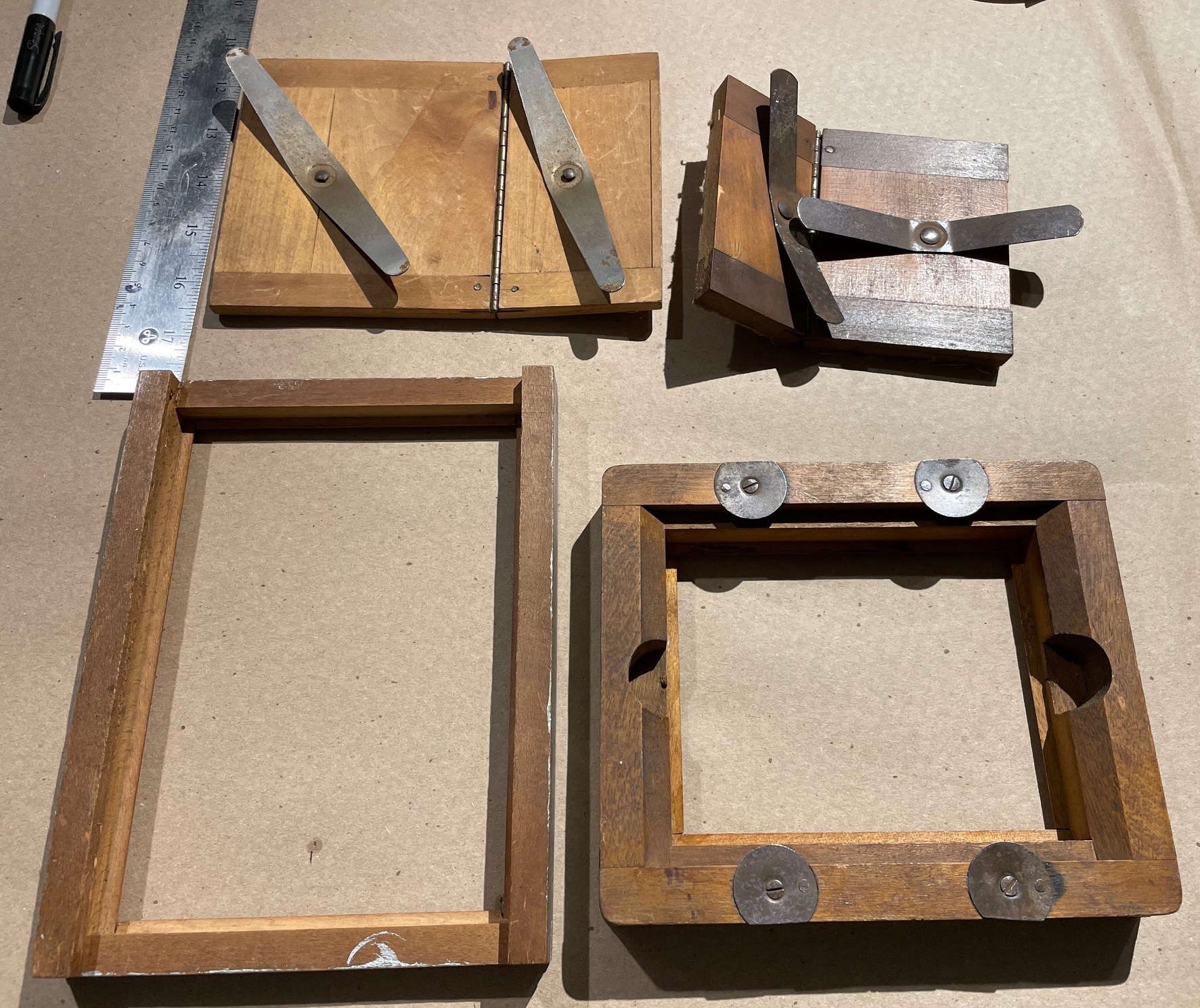

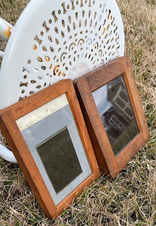

I have quite the oddball assortment of printing frames that I have collected over the years. Glad I kept them...

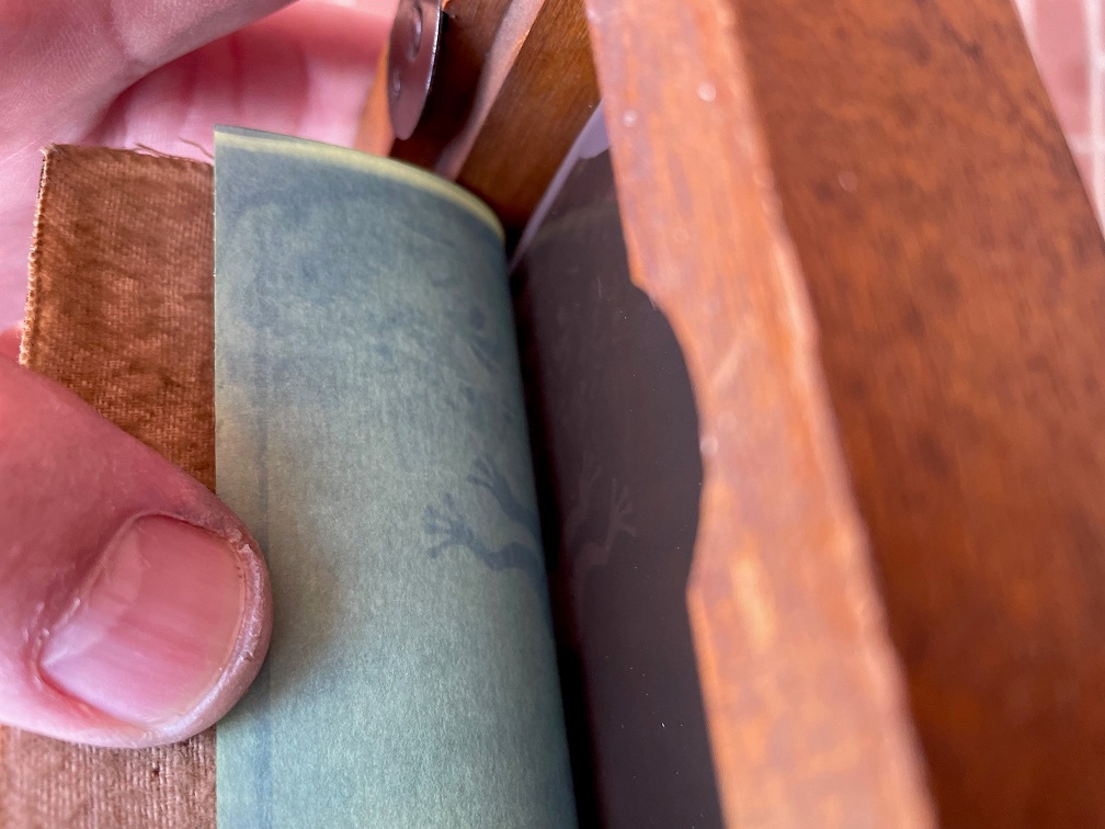

No luck today. I don't know if it is the old chemistry, the uneven cloud cover, the paper or my negatives. Probably a combination of the old chemistry and not enough UV. When I mixed the A&B solutions, there was a murky residue in the bottom of the cup.

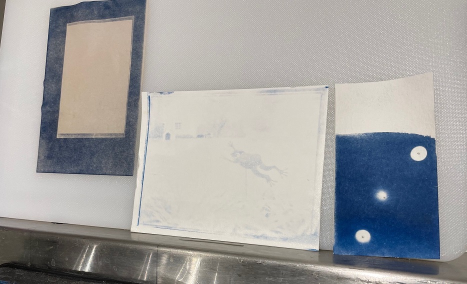

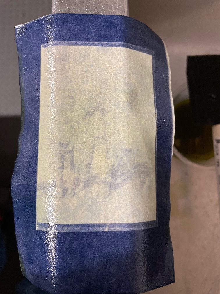

Tried coating the two papers in the below photos; had no faith in the cheap, dollar store paper, but wanted to try it anyway.
Surprisingly, it probably would have worked out if I had got a good exposure on the paper. I put an Brownie negative in the contact frame with the "Crown Jewelz" Sketch Pad Paper, and the borders came out fairly even, but clearly not enough through the negative at 35 minutes.
I grabbed the paper out of the water as the image floated off and took the above picture, but the image washed out completely in 5 minutes.
The Canson XL is practically blank because the negative covered the entire paper surface; only a few details managed to register and those pretty much disappeared with washing.
The Crown Jewelz is on the left, the Canson XL is in the middle and on the right. The rightmost bit of paper was a scrap I coated and stuck push pins through as a test strip for 10 minutes. As I said, the clouds are blowing through with pockets of bright sunlight occasionally; the test sheet was in full sunlight.
I kept checking exposures on the Canson, but it never seemed to increase beyond the density above, so I threw caution to the wind and processed them both.
BTW, all were splashed with Hydrogen Peroxide after washing.
All in all, not a success, but now I at least have a notion of what it takes to coat the paper and expose it.
Edit: the paper I used...
Yeah, more light. You'll get there.
Winter is an unfortunate season to try this with sunlight. A proper exposure unit will make things far easier.
And Cyanotype is a slow process by all accounts.
