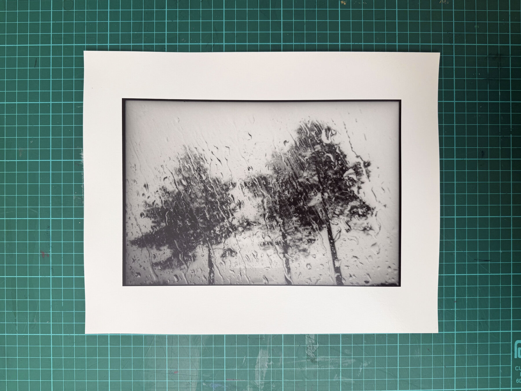

I’m currently preparing an exhibition of my work and would really appreciate some input from those of you with more darkroom and exhibition experience.
The plan is to print both 35mm (2:3) and medium format 6×6 negatives on fb paper, primarily in 8×10 and 16×20 inches. I like the idea of having variation in print sizes across the exhibition, rather than everything being uniform.
Where I’m unsure is how to handle borders and aspect ratios.
Since 35mm doesn’t match the 4:5 ratio of the paper, there will naturally be white space if I print full-frame. Part of me really likes that — both visually and conceptually. There’s something honest about preserving the full negative and the original paper size. At the same time, I’m wondering whether it might look awkward or unresolved to have images “floating” on the sheet with uneven borders.
So I’m trying to decide between a few approaches:
- Keeping the full paper size and embracing the white borders
- Trimming the paper after printing to match the image
The other option for 35mm is file out the negative carrier so that when printed there is black edge showing that the negative was printed without cropping, then printing the negative full frame trimming the paper to match the ratio of the negative.

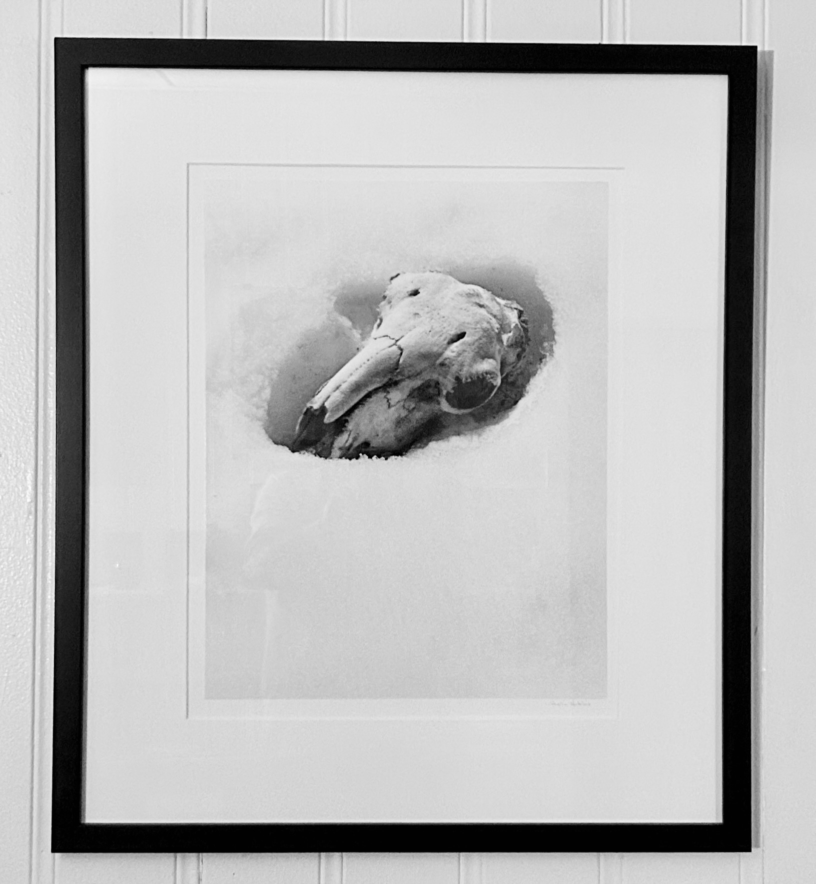

For years I matted and framed 16x20 silver gelatin prints 20x24...more to save a little money at a time when there was not much. It's okay, but (IMO) the image needs more space around it.
I tried 22x28 which works nicely for verticals, but not for horizontals (too much side mat relative to top and bottom), so I went 24x28, and that looks sweet. Full-frame 35mm enlargements probably work well with 22x28.
Example below...a quick iPhone image, its on my wall (Sheep Skull, Snow, Upper Mono Lake Basin, CA). Image dimension is actually 15x19 (from 4x5), the window 16x20, and the frame 24x28. The print is trimmed down to the image and dry-mounted with-in the window. Black wood frame. A very clean, nothing-hidden-by-the-mat, and mixes well with different size frames of the same type and matting style.
