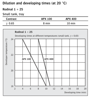

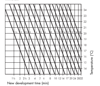

Nice and fine when there is a specific temperature compensation table/graph given by the manufacturer for film "F" in developer "D", as shown by Matt King in https://www.photrio.com/forum/threads/standardizing-at-75-deg-f.197438/post-2648674. But one should not assume that there is a universal temperature-time compensation law, as, e.g. published by Iford
Not all reducing molecules have the same rate of change of activity versus temperature, and when --as commonly happens-- there are two reducing agents in one developer, the balance between the two might change with temperature.
A counter-example showing that temperature compensation is not universal can be found in
Technical Data Agfa B/W Chemicals – Film processing
Going from 24 to 18°C. APX100 time ratio 10/4=2.5; APX400 11/8=1.375. Significant! In the same document, APX400 in Studional 7.3/4=1.825. etc... Some or all of films/developers being obsolete is not the point. The point is I put a counter-example on the table.
As for myself, I aim to be within ±1°C of a 20°C goal, and compensate for the residual difference (measured in-tank at mid-processing time) at a rate of 10% per °C.

It's also not universal when it comes to developers, somewhere I have a similar graph showing different slopes for Ilford developers.
