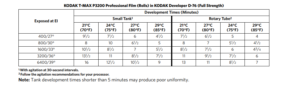

FWIW, in one section of f the D-76 datasheet:
The development recommendations for the other films listed all have 24C/75F at the top end.
With T-Max developer (and the discontinued T-Max RS) it is similar.
The X-Tol datasheet offers times for 80F for many dilutions and films, but not all.
In some cases, a particular Kodak film and developer and dilution combination would most likely lead to a very short developer time, so probably isn't listed for that reason.
So I would conclude that it is dependent on many things.

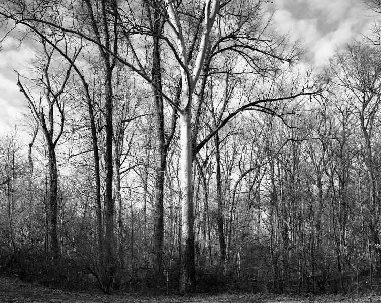

Here is a negative scan after developing the negative for 5 minutes at 75 deg F. It's a poor negative, imo, I don't like it, due to a poor choice of lens filter leading to too much contrast. That aside, the negative seems well developed to me. The grain does not appear any different from my negatives developed for 7.5 min at 68F in Xtol stock . The fb+f of the rebate is the same (0.05) at both development temperatures. I see no reason not to carry-on with it.
