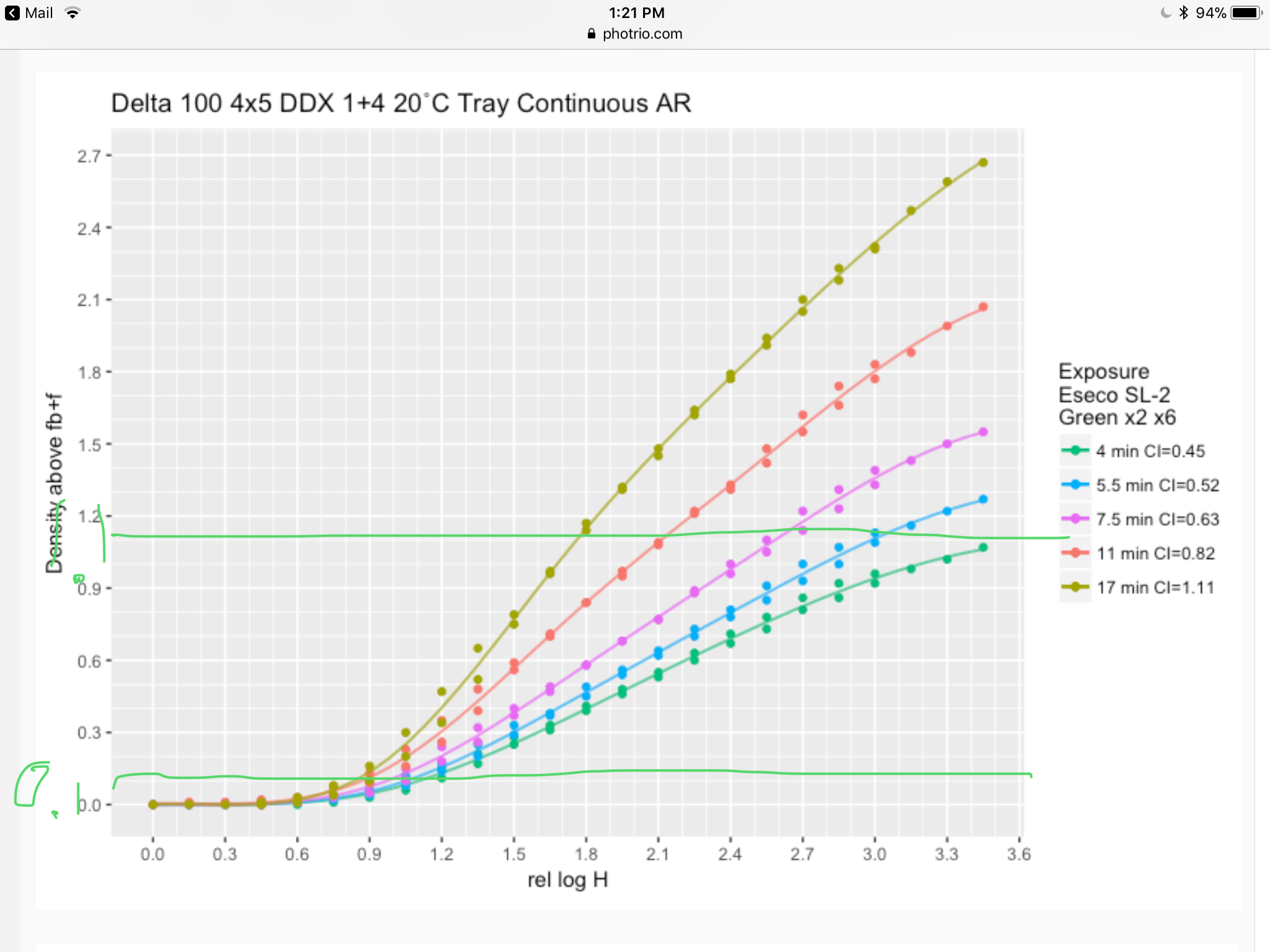

Look at the curves here:
https://www.photrio.com/forum/threads/delta-100-in-ddx-1-4-tray-method-film-test.154810/
Draw lines across them and you can see how the steepness of the curve and subject placement can be manipulated.
With regard to wanting a bit more toe development the one single data point we have seems to suggest that is reasonable, but it's just one data point and on a film that you may not be using.
With regard to expansion, no. Your thought is a bit muddy.
The steepest curves stretch a shorter range of scene data (low contrast scene like overcast day) across the paper's range. Steep curves produce snappier results.
The flattest curves squash a long range of scene data (clear day shooting into the sun and wanting shadow detail in the fore ground) into the paper's range. Flatter curves produce less snappy/more gray results across a wide range of scene detail.

The log scale on the bottom represents how much light bounced off a subject in the scene and made it to the film. If we say we want detail in the clouds and the light that reaches the film is at 2.8 log, using normal development (purple) we won’t have detail in the print unless we change something.
If we reduce camera exposure we lose shadow detail but the highlights slide down under the white point.
If we increase enlarger exposure instead (move my lines up to say 0.3 & 1.3) we again lose shadow detail in print but the highlight detail prints.
The effect of either of these on the print is the same.
If we use the blue curve development (minus or pull) we can get more of the highlights and shadow on paper. This makes the whole photo look less snappy.
If we stick with normal development and use a softer paper my lines separate a bit (say from 0.1 to 1.2) and the rest of the photo gets a bit more gray.
