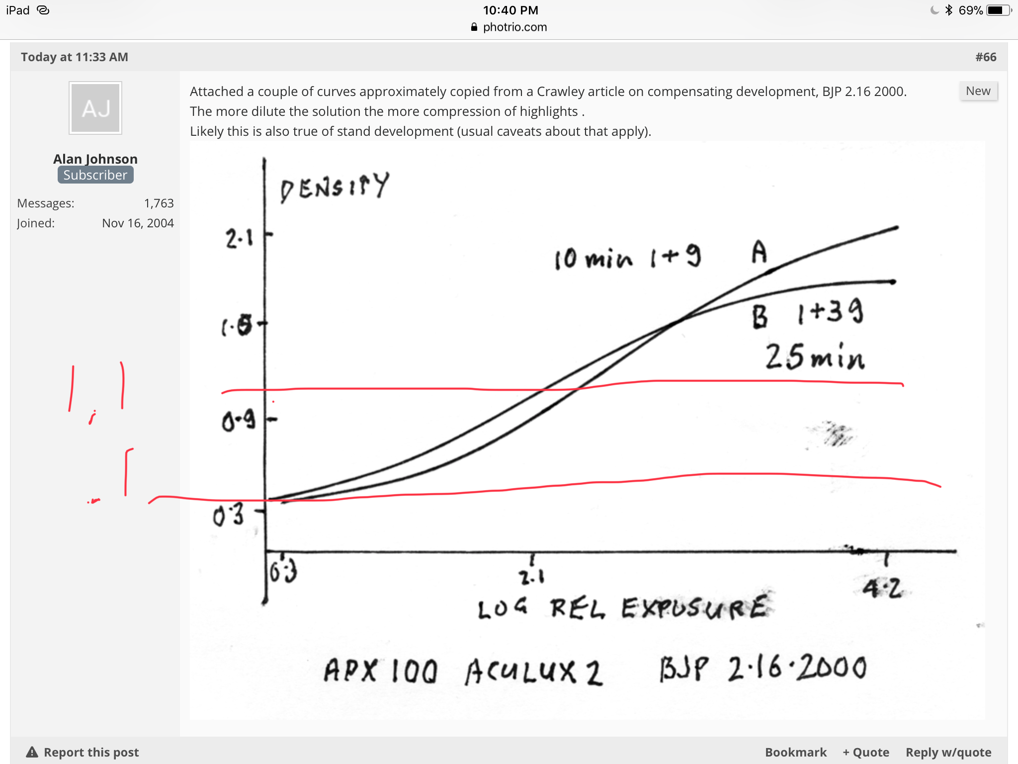

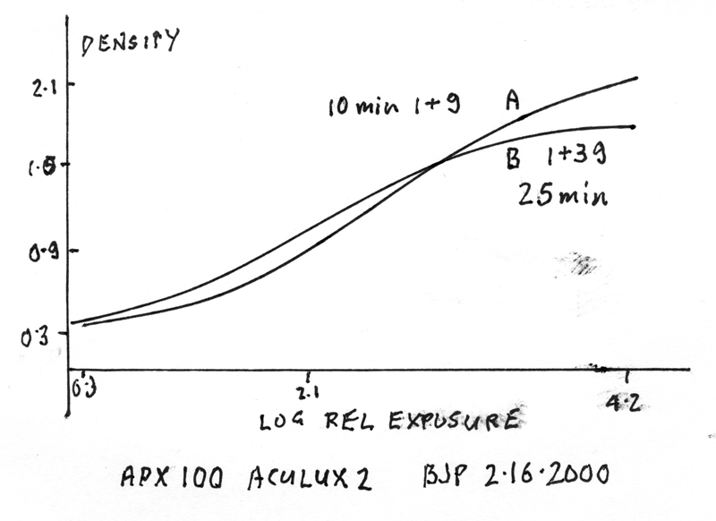

Attached a couple of curves approximately copied from a Crawley article on compensating development, BJP 2.16 2000.
The more dilute the solution the more compression of highlights .
Likely this is also true of stand development (usual caveats about that apply).
markbarendt
May 18, 2008
9,422
Beaverton, OR
So I added two red lines. They are defined by the range photographic paper can reproduce. These lines move in tandem up or down depending on the exposure of the paper. The spacing between the lines is fixed by the grade of the paper. At grade 2 the spacing is about 1.0 vertical.
The lower line (@0.1) is print black, everything below that line has no detail or tone in a print. The upper line (@1.1) is to represent print white everything above that line has no detail or tone in a print.
In this example nothing on the curve above 1.1 shows in the print. That fancy shoulder has no effect on the print.
To take advantage of that fancy shoulder on that 100 speed film you would need to use EI 25 or 12 or 6 Or ... and correspondingly more enlarger exposure (scanning moxie) to tease out what you want on paper (or screen).
Between the lines in this example note that the 1+39 line is flatter, that means it has lower contrast, just like a pull affects a print.
surely its the other way round and 1+39 is more contrasty that 1+9 (unless i'm being totally thick here which cannot be ruled out)
markbarendt
May 18, 2008
9,422
Beaverton, OR
The steepness of the curve is what indicates contrast, the steeper portions of line indicate more contrast.
1+39 is slightly steeper (more contrast) at the shadow end (at the toe), but less contrasty in mid and higher print tones. In the ultra highlights 1+39 goes flat, low contrast. So, it could be said that in this case better (not more) shadow detail was available but the cost was that the mid and higher print tone/contrast was sacrificed to get that.
1+9 should print snappier/better looking faces, in this case.
Another thing to remember is that the detail outside the lines is usable/printable, it simply requires burn and dodge to get it to print; the very high tones on the 1+10 curve are going to be much snappier if burned in than what the 1+39 curve offers.
This type of analysis/doing the math allows you to choose which curve suits your needs.
cheers mark - so more shadow separation, mid tones running basically parallel to each other then compressing highlights after 7 or so stops. Printing on harder grade and you should get even more shadow and midtone separation and highlights becoming more like 1+9 is what I am taking from this - which sounds no bad thing. After around 10 stops either way its going to a lot of printing jiggery pokery either way to get those details onto paper but that very shallow shoulder at 1+39 is going to make those highlights pretty dull even at high grade so one would actually be better printing normal scenes at 1+39 (if you want a lot of separation between tones) and high contrast scenes at 1+9 so those extreme highlights are still on straight portion of film before the shoulder.

Your red lines seem to validate a common practice, for contrasty scenes overexpose (cf average metering) and underdevelop..
This would appear to mean that a curve on the top right hand corner would then fall between the red lines.
In curve A the highlight would be blown out, in curve B it would print OK.
Harder paper moves the lines closer, that means there will be even less range printed from the negative. You lose highlight or shadow detail. There is no free lunch. If it’s outside the red lines it is black or white and shows no detail period.
That is the general way it works. Reducing development enough to get what you are suggesting though will provide a very ‘muddy gray’ print though. Also to get the top of the curve in would be a huge pull well outside the range of normal use.
Burn and dodge are the appropriate tools to get the details off the upper end of the curve.
Hmm yes. I looked at those curves for ages too and still didnt understand the implications.
So its maximising shadow separation v highlight separation according to dilution.
Cheers mark that was a battle for me to get my head round. Thanks for your help
With regard to the shadow separation, it depends on the EI you use when shooting in the field, placement on the curve is a variable. If you open up your camera a bit more when you shoot all the tones move right correspondingly.
The practical effect of this is that tones that may have been on the toe are now up where the film curve is steeper, so camera exposure can fix the problem too. With slightly more camera exposure the whole negative is more dense which then requires more enlarger exposure (different scan and adjust settings). That extra enlarger exposure moves the red lines (the black and white points) up higher. With that change you are off the toe and the shadow tone separation issue is moot.
Ample camera exposure is a more reliable fix for shadow detail problems than trying to overdevelop the film toe.
