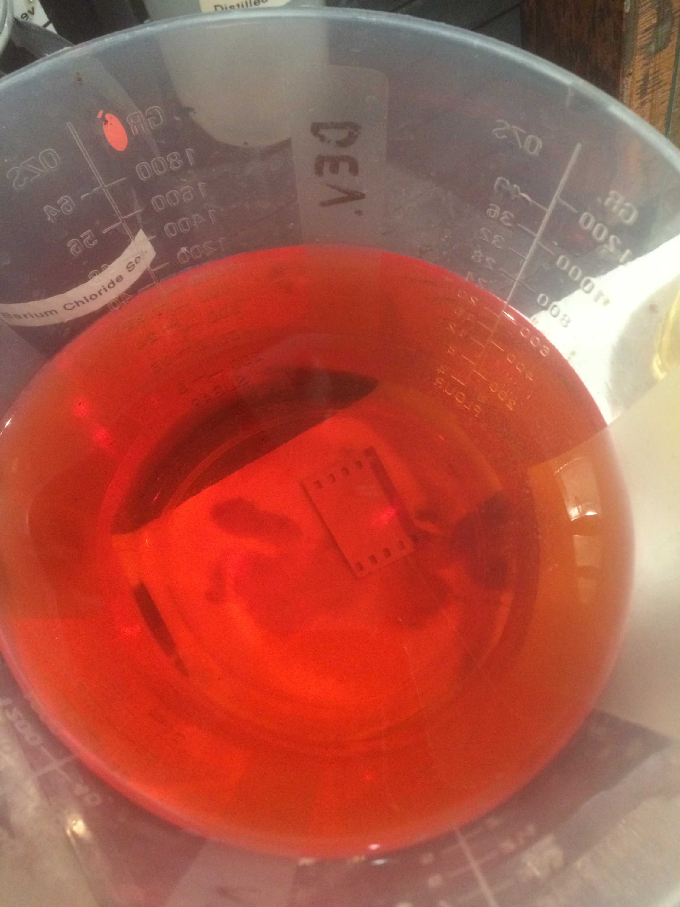

Here is how the dev looks. Burgundy in concentrate but irn bru orange when diluted 1+100. I left a piece of exposed leader in a litre jug of developer and after an hour nothing has happened. No darkening at all.
Your bottle of Rodinal has expired.
