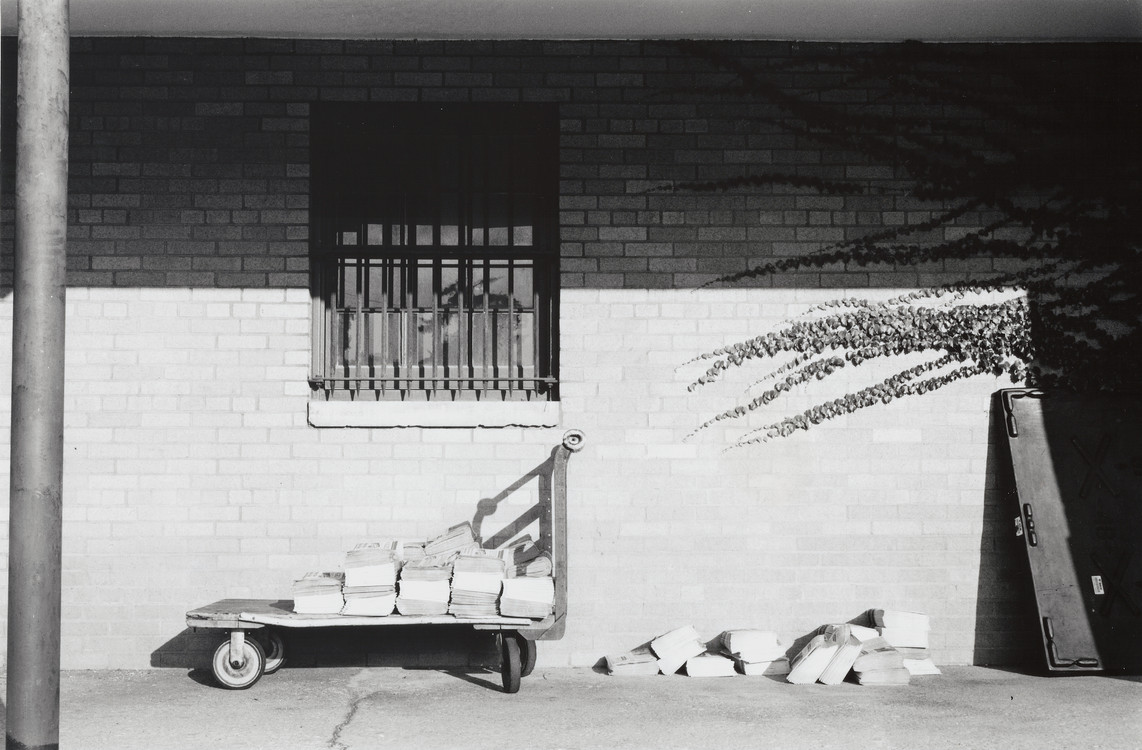

You are shooting a scene with an overall long SBR. However, the principal subject of the scene (the dominant geometry) is, say, in a flat lit shade - the mid-tones are all muddy. Mid-tone contrast is essential to make a print "sing" in a great many, dare I say most, situations.
If you use contracted development to hold both the highlights and shadows, you clobber mid-tone local contrast. (This is the #1 sin committed by strict Zone System use.)
If you use expanded development to build mid-tone local contrast, you blow out the highlights.
If you use a strict compensating development scheme, you'll hold the highlights but you won't expand the mid-tones (see the first case above - exact same problem.)
There are only two ways I know to attack this problem:
1. Use SLIMT to calm the highlights down and then do expanded development.
2. Use semistand/EMA to hold down the highlights and simultaneous expand the mid-tones
So much of a print's vibrancy depends on those middle-tones, I find myself using this more and more and my prints are the better for it.
Here's a scan of a print by way of example . Huge SBR but the interesting stuff was in the mid tones:

As to the loss of highlight contrast, this was actually somewhat of a choice in the printing process. I actually burned the highlights down a little bit as I recall. In this case the burn geometry is relatively easy and I could have split VC printed the highlights "up" a bit.
Notice that however the highlights ended up though, there is really good tonal separation in the mid to dark tones as seen in the shadow areas in the upper third of the image.

Bromide is a reaction product, and local accumulation of it can cause local slowing of development; bromide dissolving out of the film into the solution makes the solution locally denser.
But in that title, there is lightening both above and below the bracket shapes. Bromide would 'drag' downward; but up?
There is also the simpler adjacency effect, where an area of the film not consuming much developer leads to a locally high concentration of it, which can diffuse across to a neighbouring area where the demand for developer is higher (that is, driven simply by concentration difference, not gravity). Correspondingly, the presence of that high-demand area would rob the low-demand area of some of its developer, and the result, by diffusion alone, would be acutance. If it were driven by diffusion alone, that shouldn't be directional, but it clearly is vertical, so I wonder if there has been slow circulation moving the developer from the bracket pattern, driven by the gravity-flow of solution due to differences in bromide density.
I have a couple of photos with slight pale streaks upward from dark chimneys on a bright sky. In the negative, that dark chimney is a clear area, consuming little developer and releasing little bromide; maybe there's upward 'drag', as the low-bromide solution becomes buoyant relative to the liquid around it, which is getting denser. I'm just thinking aloud.
Consider the fact that this strip of logo has been copied over and over, processed many times, in both negative and positive form, and likely fed through processing tanks in both directions. The repeated copying would tend to accentuate any density differences. I remember reading that the intro to Gunsmoke had to be re-shot at least once because the film had worn out.
