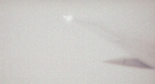

Sorry, I don't have a macro lens nor a light table. Too poor for that.
This is the best I could do with the crappy 2MP Stupid-o-phone:
Sorry for the quality.
Even at naked eye the negative looks properly exposed and developed to me.

Well....that was worthless to carefully examine the negs for details but thanks for trying. I've found (and this could be just me) that looking at negs with the naked eye isn't even close to what value you get in examining them with a loupe or high def picture. The reason is that all those little details like "how do the highlights look?" and "how is the shadow detail?" get mushed together unless you are able to look very closely.
I'm not dissing stand development, I only said that what process will yield a scannable negative doesn't necessarily yield a great negative and so folks go off to do things and never take a close look at their negs. Then they tell noobs how wonderful a certain process is and the noob (like me) never realizes how bad their negatives really are. (like me)
I had to go back to the manufacturer's recommendations for time, temp, and agitation to get to a good starting point for creating a good negative. I started the process of developing backwards, I was doing all of the OTHER things first thinking that I was doing fine, and after getting a light table and loupe, and printing my contact sheets until D-Max I realized the truth, that's all.
No worries if anyone wants to stand develop or anything else, I don't care, I only mentioned my experience as one point of view.

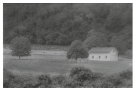

these are both enlargements / prints
1/2 frame negative (1st )
(2nd ) is a 35mm negative.
stand developed about 30 mins in coffee and a splash of ansco130
not sure how or why stand developed film is inferior, maybe i am not doing it
for long enough and i know when to stop ?
i don't evaluate with a loupe and a light desk. i just look at the film
with my naked eye and it seems to work out for me.
