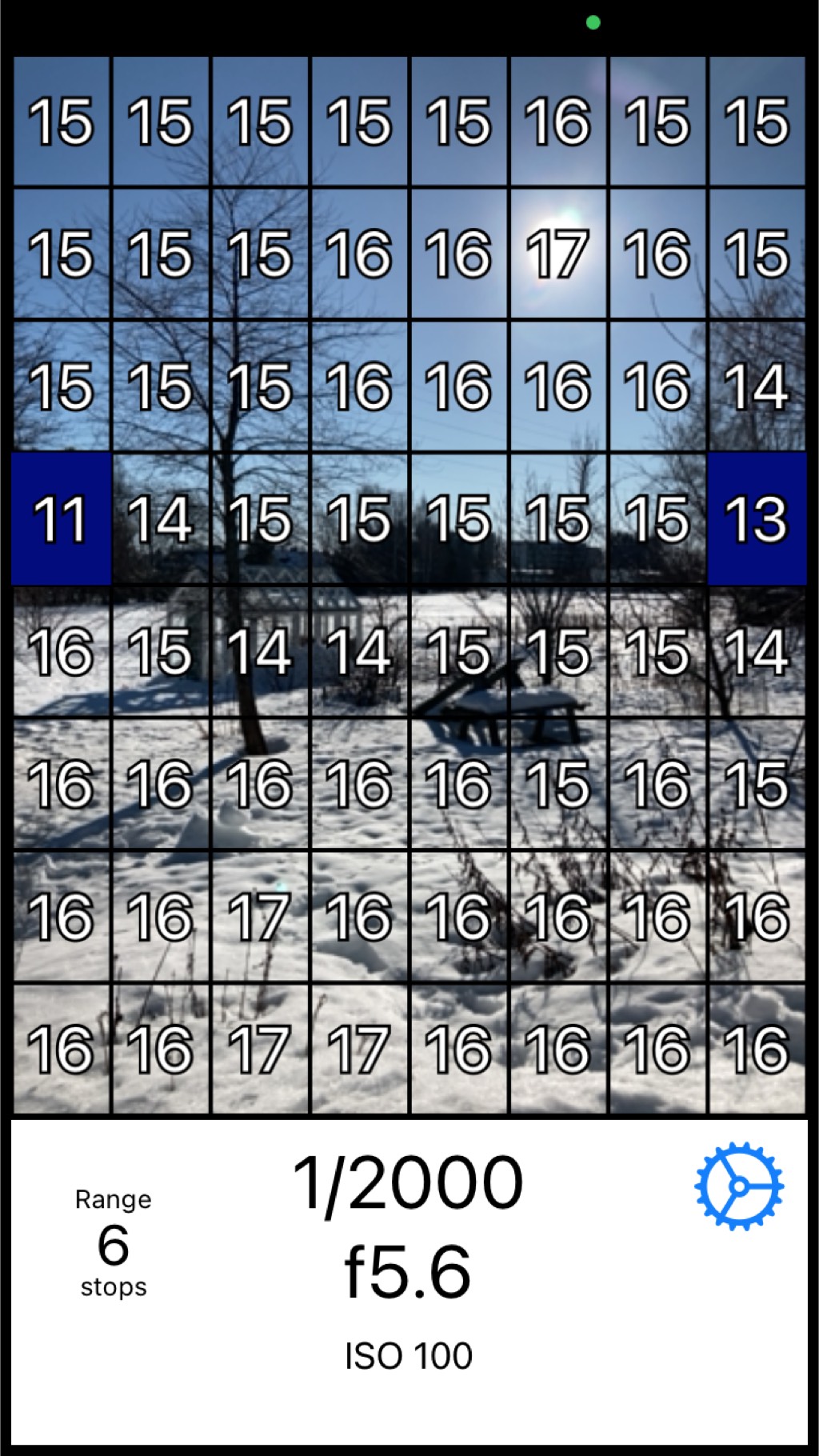

Latitude 61'29' North - today 1st of March 12:30 - EV(100) 15-16.
Weather: bright sky, lots of snow.
(shadows at 11 EV100, range 6 stops)
It would be interesting to see a scene without snow. White on white scenes need an incident meter and are very misleading when a reflectance meter is used.
That was incident reading. The photo was from different app just to show how the EVs looked like around.
Still I would like to see that same thing done with a scene without snow.
I welcome you here, I can loan snow sleigh shovel (if that is the correct word). There is about 40cm of snow everywhere.

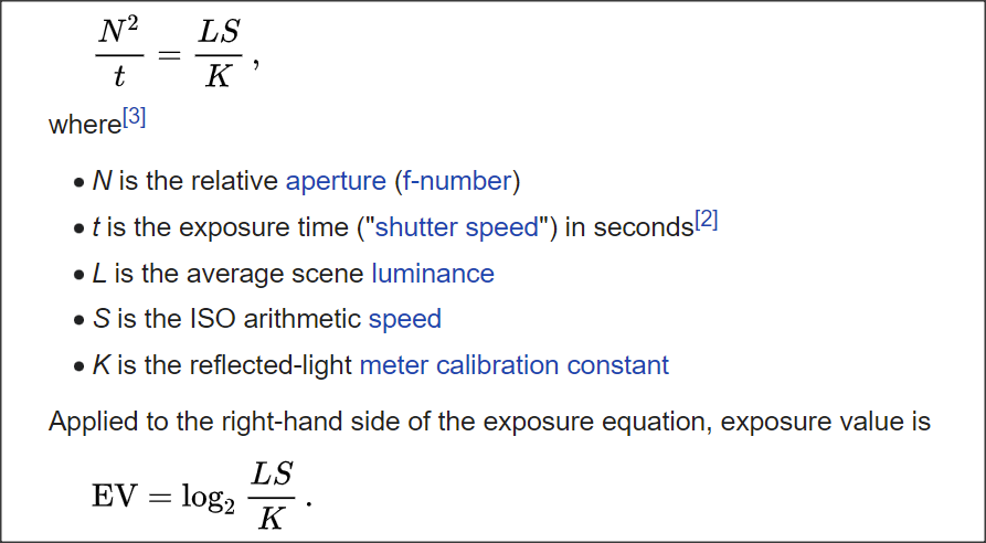

The exposure meter uses:
and modern nomenclature:
So for the exposure meter to arrive at an EV for the meter's calculator it uses the LS/K equation and you need an ISO. Most, if not all, exposure meters use a fixed ISO 100 for the EV and then use the exposure calculator to work out the f/stop and shutter speeds based on the user's ISO setting. Most exposure meter manuals state this. For example, Pentax Digital Spotmeter:
