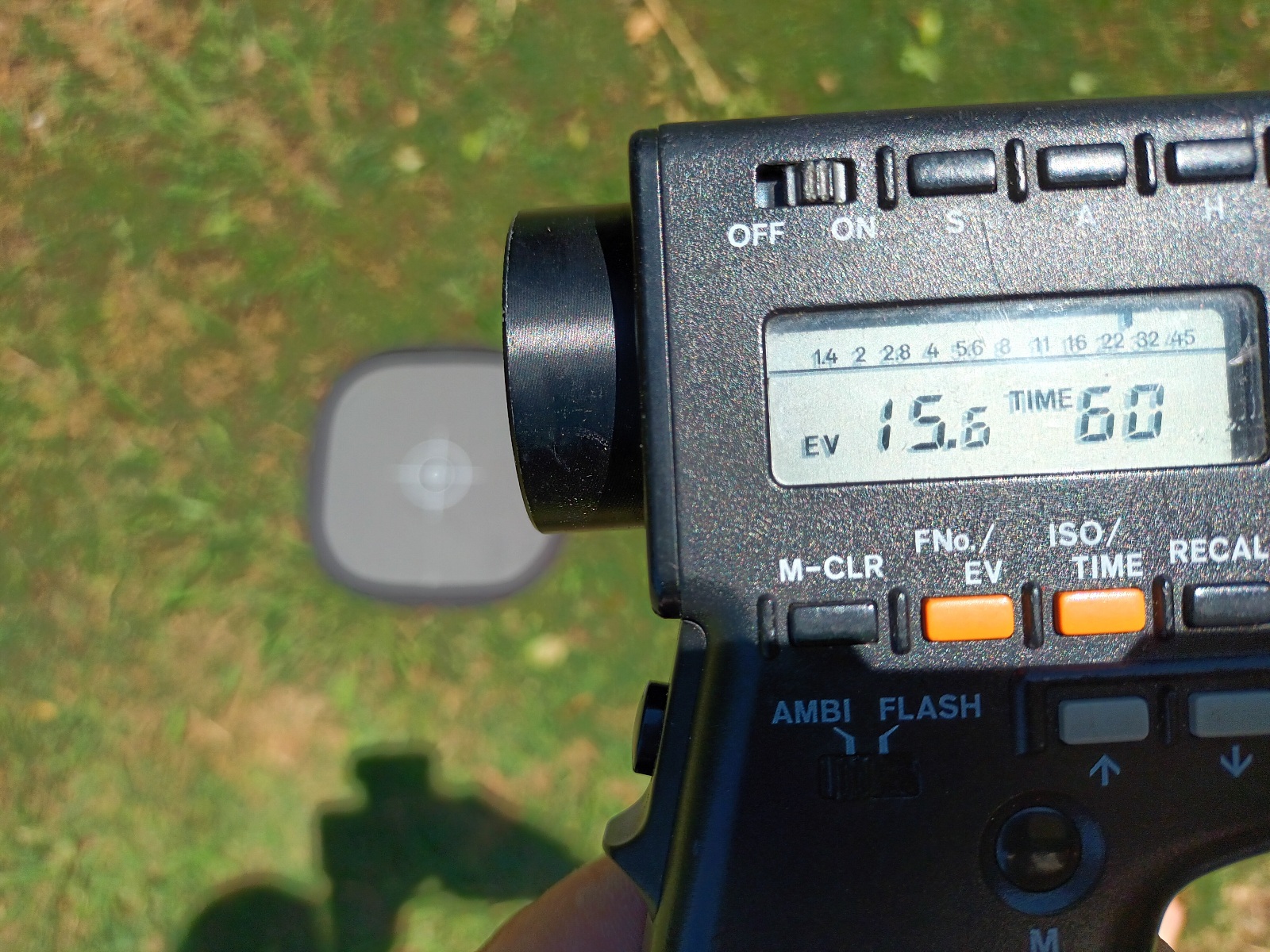

updated! I made the measurement yesterday at around 2:00 PM and pointing the dome directly at the sun gave me 15.0. Pointing it horizontally like making an incident reading for an object it read 14.7.
At 4 minutes past solar noon, incident meter pointing directly at the sun I get EV14. Latitude 51N, long 114W.
EV is also dependent on the ISO film setting and the design ISO. For example the Pentax Digital Spot Meter is designed assuming ISO as the basis and then the film ISO is set for the measurement. One takes the f/stop and shutter speed, then the EVs are adjusted fir filters on the camera, not the light meter. So without the design ISO and the film ISO setting, EV14 means nothing related to anything.
