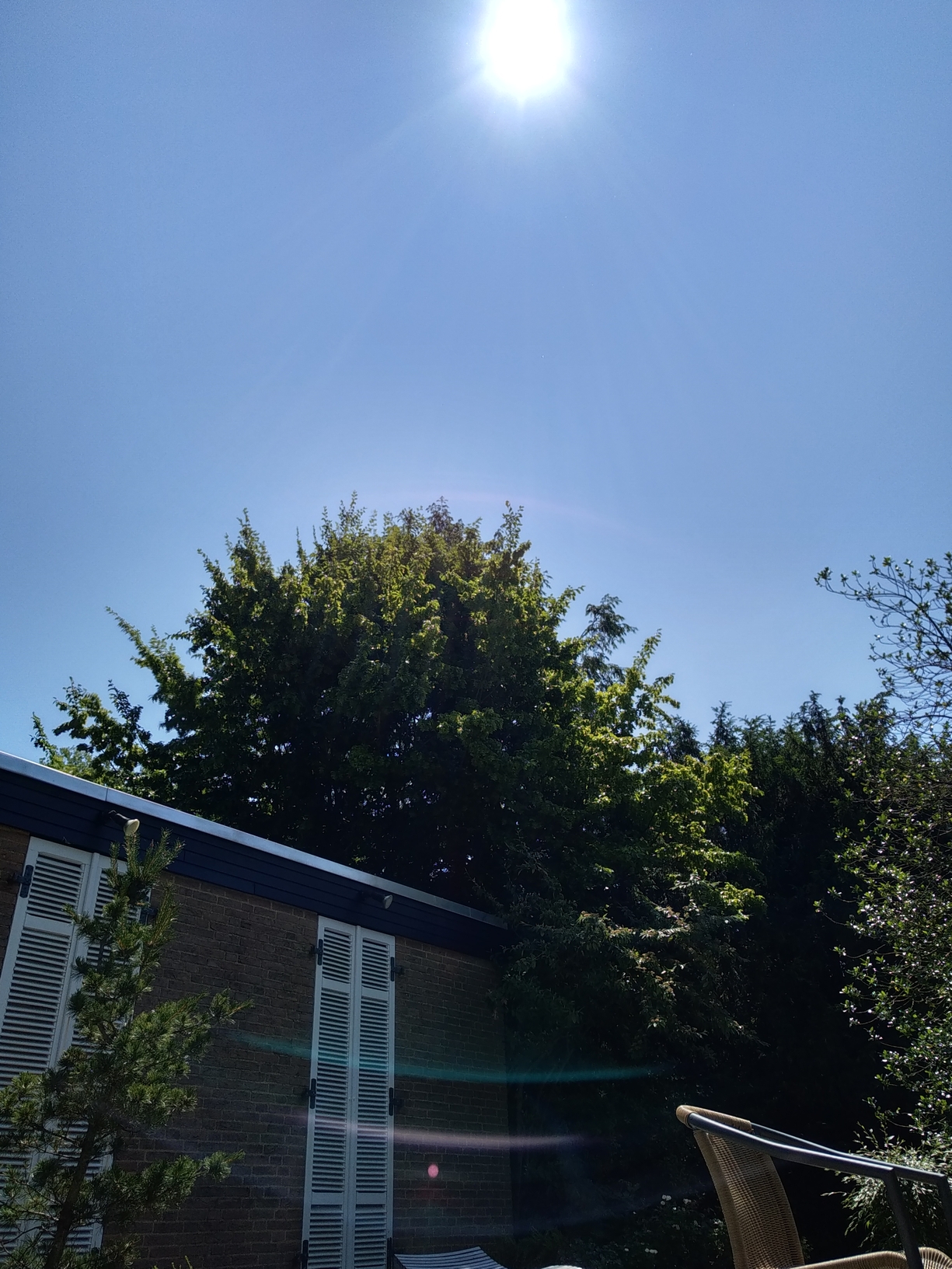

What I can't figure out is that alleged Smartphone reading on the previous post. With Minolta and Pentax real spot meters, 14-1/2 EV is just a stop and a half above a typical sunny day midtone reading.
That's easy to understand. EV 13 is about 35% as bright as EV 14.5, so if you have 14.5 directly against the sun and EV 13 against the reflections, this means that 35% of the sunlight is reflected. It is said that about 30% is the average reflection in the landscape (averaged from fresh snow 80-90% to grass 25% to fresh asphalt 4%). So it fits.
I admit I don't know how various cell phone cameras either think or don't think. If this particular case is true, then not only is it not a spot reading, but a very questionable averaging if the sun is in fact in the frame - which would totally overwhelm the rest of the reading. But those gadgets are so absurdly prone to flare and so forth, that it makes little difference to me personally. I'll never take pictures with them unless it's a burglar's vehicle or something like that.

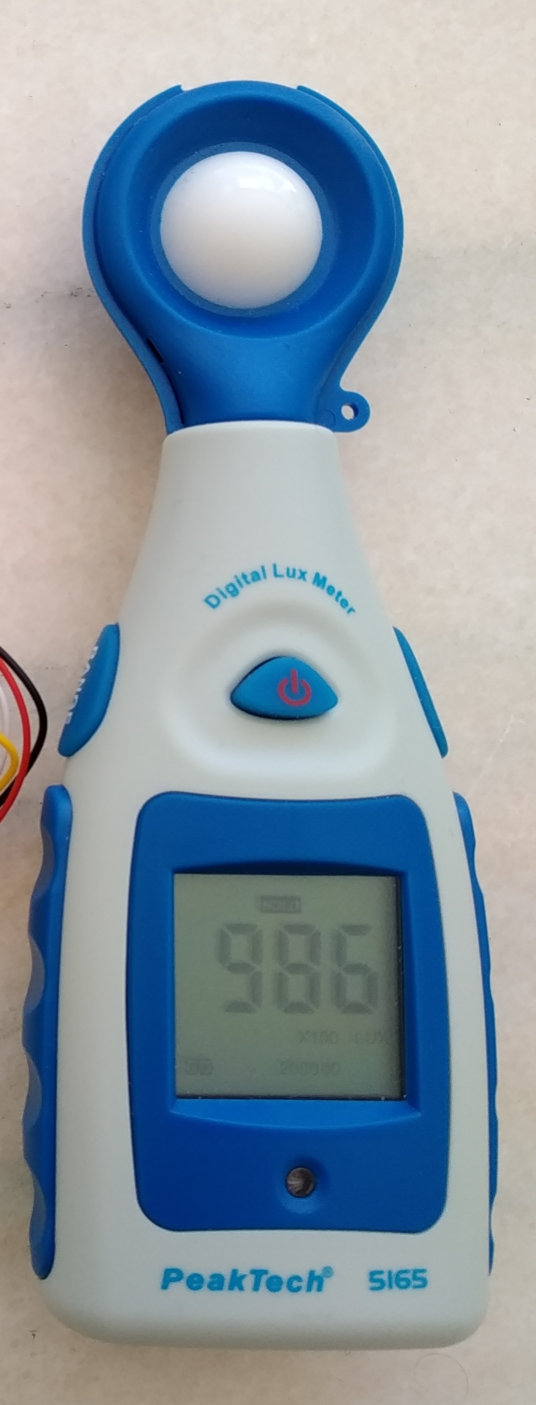

Midsummer noon 2025
Here are my current measurements taken with a calibrated lux meter today. Cloudless deep blue sky. We don't often have that on this particular day.
Aachen, Germany, June 21, 2025, 12 noon, 160 m above sea level, alignment of the measuring dome towards the sun: 98600 lux, EV 15.3
