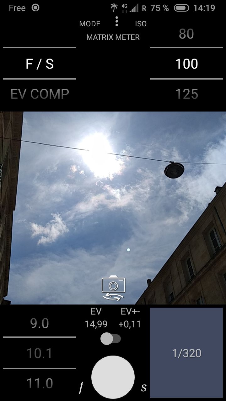

So today April 14, 2025 at 2:19 pm in Bordeaux, France: EV 14.99 in full sun. Measured with my smartphone app:
Since I shoot a lot with the Minox A, sunny 16 is a cool thing for me. This camera doesn't have a lightmeter and I would find it ridiculous to take an external device with me that is twice as big and heavy as the camera itself.

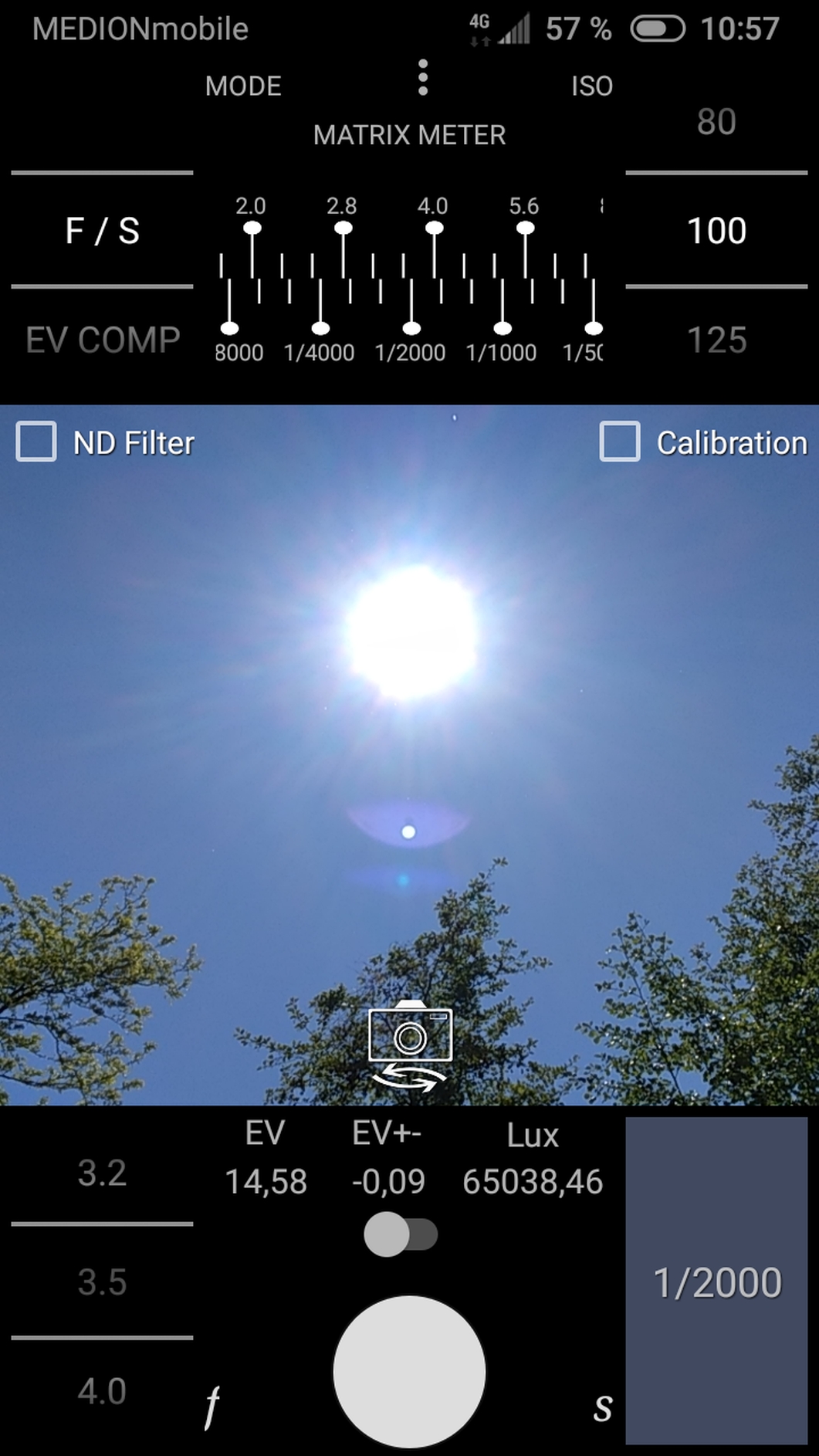

Today May 11, 2025 at 10:57 am in Baesweiler, Germany: EV 14.58 in full sun. Measured with my smartphone app:

What I can't figure out is that alleged Smartphone reading on the previous post. With Minolta and Pentax real spot meters, 14-1/2 EV is just a stop and a half above a typical sunny day midtone reading. Maybe that cellphone just went daffy due to being "blinded" by a direct sun reading. Or else its averaging in everything else in some schizophrenic manner.
I believe the phone took an incident reading as it displays the illuminance in Lux.

138 m
