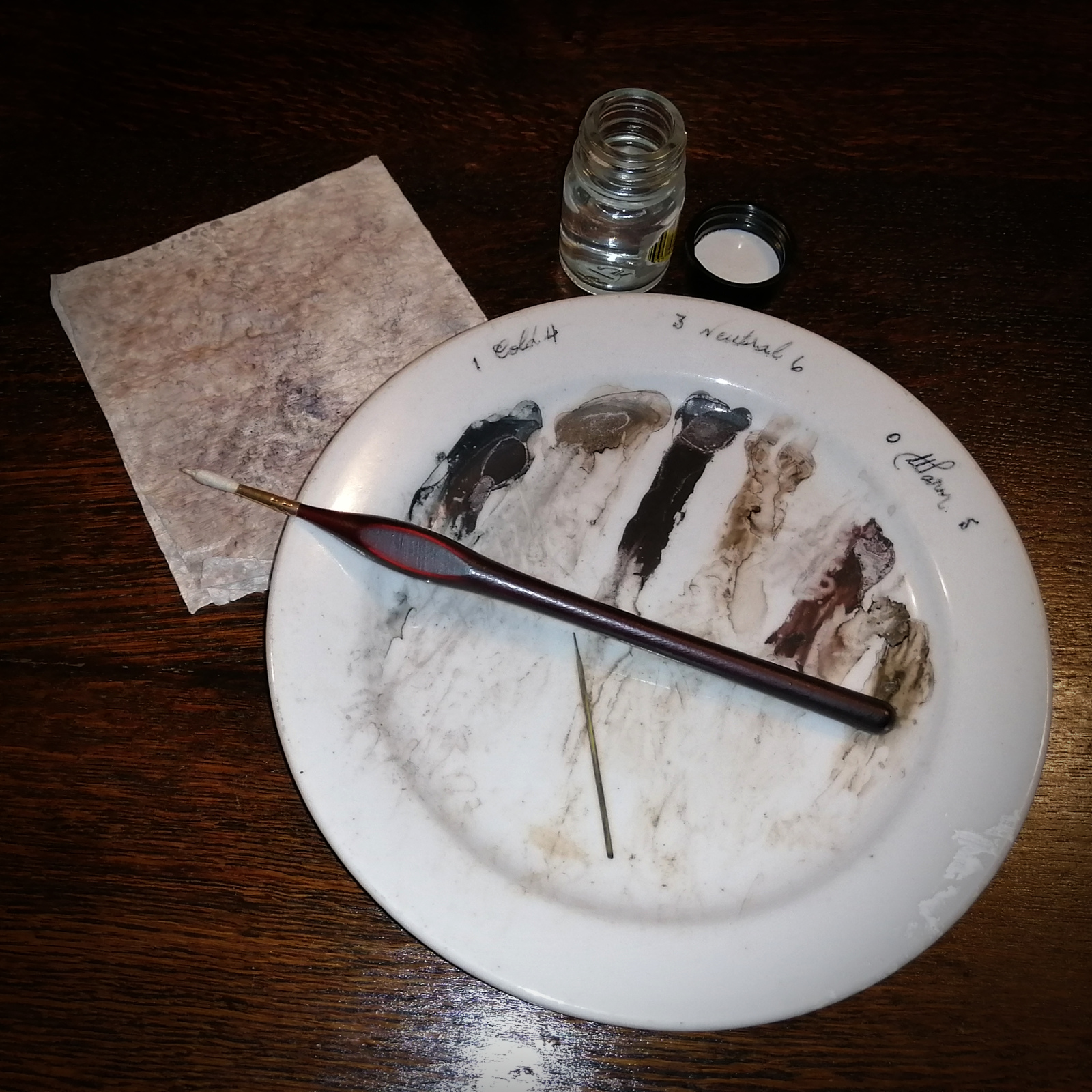

I use a plate with dried splotches of Spotone. This is a decade old, or thereabouts, now.
Granted, I don't get to do much spotting despite having a carpeted darkroom. It's a shame, because I find it really relaxing and would happily do it for others if I had any confidence in my abilities.
My little water jar has a drop of Photo-flo in it (one of those "I read somewhere that it helps the dye absorb into the paper" sort of things).
The key thing for me was to learn to use an almost dry brush and to dot/stipple the dye - don't paint it on.
