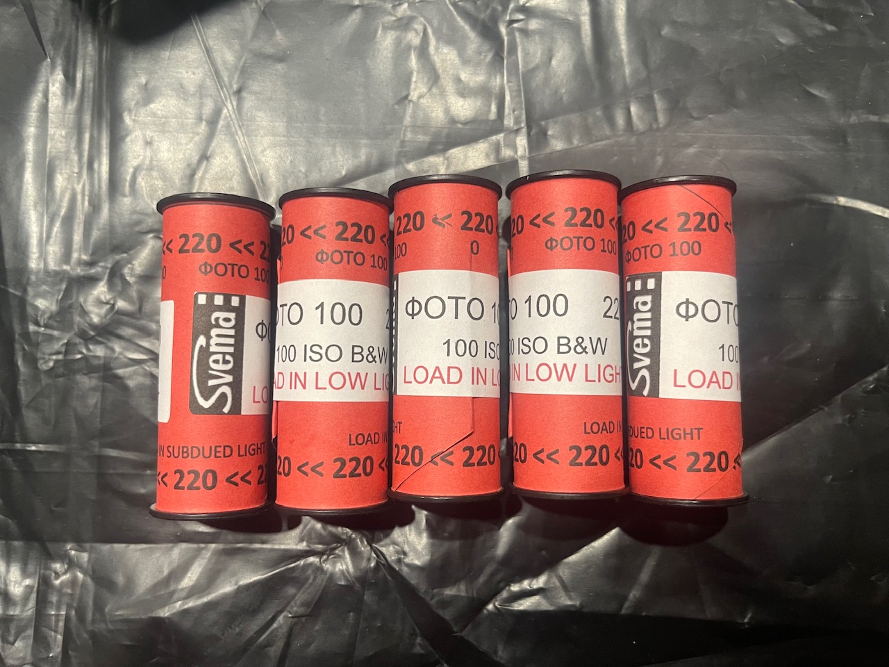

I do lol. I still have 200 ft of the stuff… thinking about just keeping the rest and selling some of it off as 120, even though that’s more of a PITA

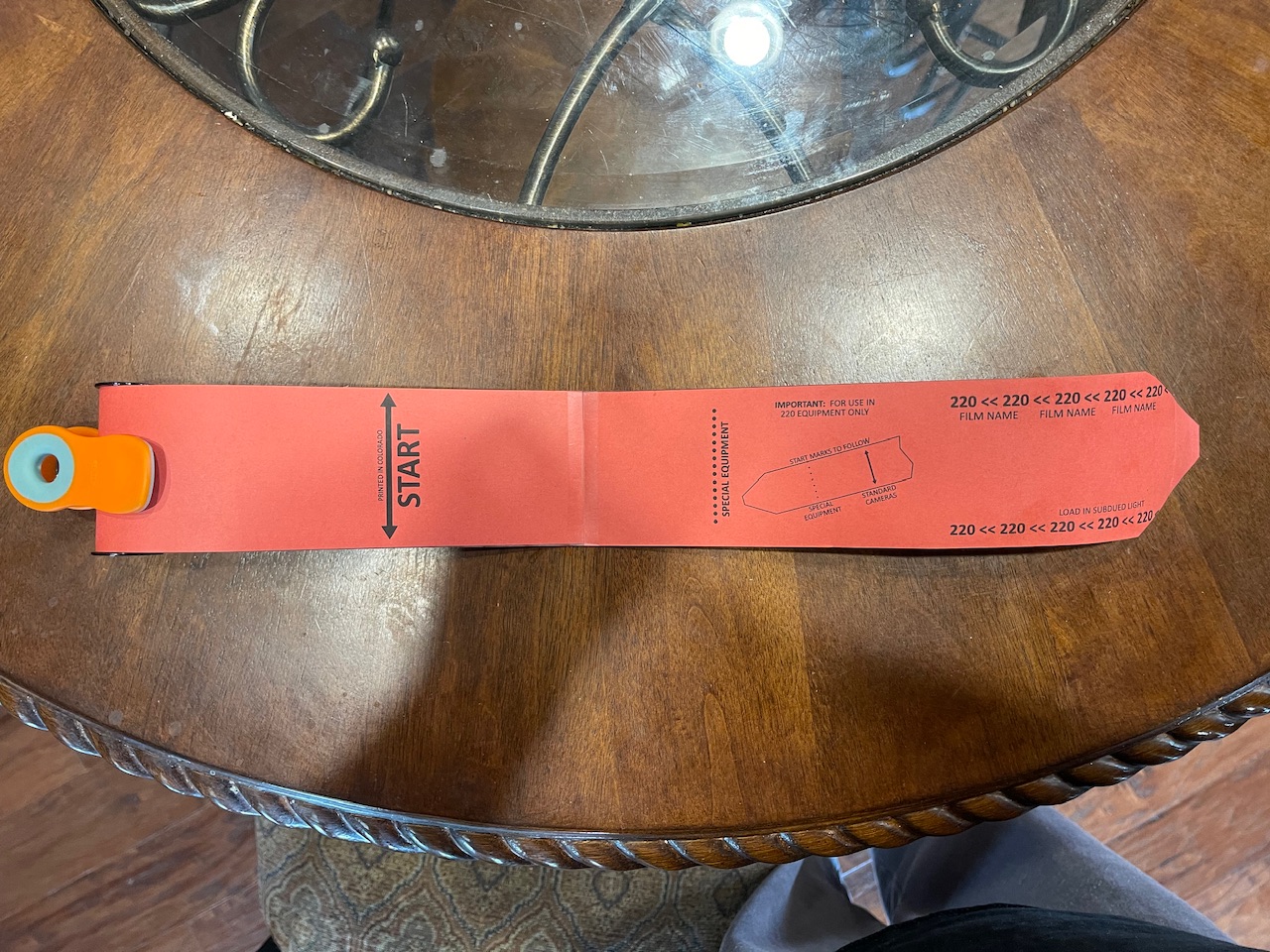

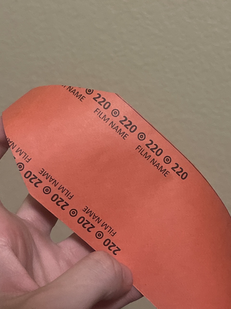

Sorry, no answers as to the backing paper other than 'scavenging old film rolls'. Ask your camera club members to save the backing paper of the film they shoot, then reuse that. Spindles/cores etc. can be 3D printed.
FWIW I do actually make my own 220 paper, but that’s only because I want it to look nice since I sell it. It’s a bit of work, but I made a template that prints on a single page and cut that into 63-ish mm strips, and the ink doesn’t come into contact with the film so no worries about wrapper offset. You absolutely don’t need to do this, you can just cut up 120 paper to the right lengths.

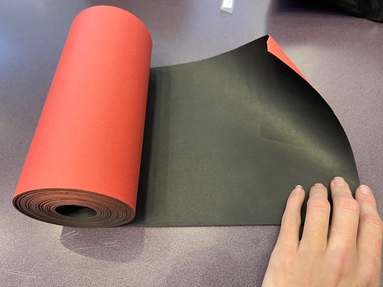

The red paper is from a giant roll from Astrum. I don’t make my own 120 paper.
