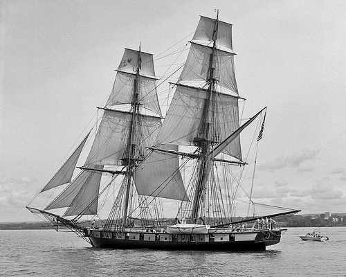

The image I want to split grade is attached.
Bob, you say that split grading adds to the perception of detail in telephone lines. I imagine that the same holds true for things like ship's rigging.
Hopefully, this is just what I need to take this image from a "9" to a "10," so to speak. :smile:

Also if you are burning in those cloud areas, the bottom of the clouds will become more defined and any mid tone within.

I am thinking about burning the clouds and I'm considering whether or not to split grade the print when I make it for good.
I was showing some work prints to a woman who manages a gift shop and gallery. This one was at the back of the book. She flipped through and thought a couple were good but, when she got to the ship she asked me to make a print to sell. I told her I would have a finished print in a week or so.
In the mean time, I am taking a couple of days to look at the work print I have and just think about it. I put the print on the table and look at it when I walk by. I'll have a beer and just sit there, print in hand and consider options and things I like and don't like.
Tomorrow is Sunday and the shop is closed on Monday. I want to work on it between tonight and Tuesday.
I also use Photoshop as a way to experiment and preview different ways to compose, crop and choose other options before I go downstairs and burn up paper. Thus the reason I am asking about parallels between Photoshop and the enlarger. (The negative is on Tri-X 120 format, shot with my Yashica Mat.)
I think I'd like to burn in the clouds but I really want good detail in all the rigging and in the sails. I'd be willing to forgo the sky if the rigging really popped. As Bob Carnie pointed out, this is one of the reasons I'm considering whether to split grade this print.
If luck is with me, maybe I can turn this one into a money shot.
Try for 11.
Tastes differ, but I think this image would make a killer van dyke print if you can make a big digital negative or if you shot it big to begin with. The dark hull and rigging would really show nicely. A toned cyanotype would be nice too; see what Sandy King has been up to on lfinfo. The historical subject matters usually look good on a historical process too.
The alt process option can come in handy and creative when you have a nice B&W image that doesn't seem ideal for normal gray silver.

I usually selenium tone but what about sepia? The local camera store doesn't have much in the way of traditional supplies anymore but I do remember they had a couple of sepia tone kits on the rack, still.
I would love to make a cyanotype or something. That would be cool!:cool:
All the galleries around here want exclusives. I've been getting away, sliding under the wire so far because everything I have consigned up to this point has been just post cards and small stuff like 5x7. (Catering to the tourist crowds who don't want to haul big prints home in the trunks of their cars.)
Although I understand the cyanotype and Van Dyke processes, I have never done them. I'd have to study up before I tried to make one for money. Still... the idea is still rattling around inside my head.
I've got a couple rolls of film to develop tonight. After that, it's time to hit the darkroom and get cracking on this print. :smile:

The ship in the picture is the Brig Niagara.
http://en.wikipedia.org/wiki/USS_Niagara_(1813)
It was rebuilt from the original after it was scuttled in Misery Bay after the War of 1812.
A photo of a vintage ship deserves a vintage treatment. Right?
Once I work up a good print, I plan to make a half dozen or so extra copies. I'll get the promised print to the gallery then I'll experiment with the sepia toning or other ideas afterward.

As noted a cyanotype would be cool, or IMO a very slight sepia then selenium would make this a killer.
If you are going to sepia, you really need to lay some highlight tone down so that the bleach then tone will be apparent. Without tone in the highlight you may go to paper white and usually that looks like shite.

Upon futher thought and actually looking at the photograph, I am hoping you have a frame or two without the power boat.
Otherwise the technique of period toning this image is wasted.
time for PS :munch: if you don't have an image without the power boat , send me the file and I will make you a Lambda Fibre.{ we will have to be dastardly sneaky and clone out the offending tell tale signs.}

She was going through the channel from Presque Isle Bay into Lake Erie. There was a fairly narrow window of opportunity. I took two or three shots to try to get one without any other boats but the channel was too busy. This is the one that is least cluttered.
I thought about tinkering, cropping or using some other chicanery to remove the boat but I decided to leave it in because it creates a contrast between "Old & "New" or "Big & Little."
Still thinking about this. Probably will start printing later on today. I'll make some extra prints so I can play with toner, etc.
