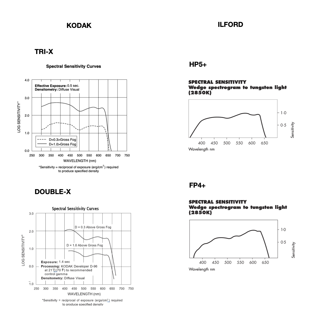

In the last year or so I've been experimenting with Kodak/Eastman Double-X. I like it in many ways, but in some ways it frustrates me. So I fell to wondering how it compares with more familiar films in terms of spectral sensitivity. Here are the spectral sensitivity curves as presented by Kodak and Ilford in their technical data sheets.
My first question is whether the curves are even comparable between the two manufacturers? Do they use equivalent methodologies? I'm not interested in the vertical scale, of course, just in relative sensitivity of each film across the visible spectrum.
If they are comparable, it looks as though HP5+ and (especially) FP4+ are a lot less sensitive (relatively) to the violet/blue end of the spectrum than are Tri-X and Double-X. Is that correct?
And if that is the case, what are the practical consequences? Does it mean that the two Kodak films will make shadows more luminous and pick out more shadow detail in them? Will the Kodak films show a more marked response to filters than the Ilford films, or vice versa?

The Kodak charts don't mention spectral distribution of the light source, whereas the Ilford charts explicitly mention a light source with a very strong emphasis on long red wavelengths. If Kodak compensated their sensitivity spectrum, i.e. recalibrate their measured curves against the incoming light spectrum, then Kodak's charts will appear more blue sensitive than Ilford's without actually being so.
Even if both makers use the same calibration and their films are indeed different, a suitable color correction filter should be able to balance out these differences.

The film's characteristic curves are more important to me, as it tells me more about how a film will render tones. But one cannot ignore the spectral graph, either. If you do a comparison between tri-x and hp5, you will find very little difference in spectral response. HP5 and say Delta 400, which has more red sensitivity, you will see a difference in how reds are rendered, although it can be subtle.
Mark J
Mar 23, 2023
438
Denbigh, North Wales UK
I hadn't properly thought about that before Jonathan, but it's clear to me now that Ilford's test is a bit simpler and cheaper using the wedge spectrogram method with essentially a normal lightbulb. The tests Kodak have used would require a proper way of calibrating and equalising the light output across the visible spectrum in order to provide a more scientifically accurate view of the film sensitivity. I'm sure one of our test engineers at work could explain the detail of the kit for me.
There is quite a big difference across the 400-700nm bandwidth as to how a Tungsten 2850K source looks, compared to a normalised flat spectrum.
I would say, just by eyeballing the two sets of data, that the apparent differences between the Kodak and Ilford films could very well be fully explained just in terms of the different test method - they may in fact be very similar.
If the differences were in fact real and inherent to the emulsions, then I would expect to see very different filter factors quoted for the two filmstocks.
Interesting Andrew. I pick one film rather than another primarily because of any differences in spectral sensitivity.
Characteristic curves tell me more about how linearly or non linearly one film in a certain developer will map highlight and shadows (the so called 'toe' and 'shoulder') and I will learn something about contrast from the curve slope, but I'd never be able to guess from e.g. Foma 400's characteristic curves in D76 1:1 that Foma 400 would render Caucasian skin tones and lips so pale - I can only tell that from the spectral graph, or even better from a test shot of a colour chart such as the Kodak Gray Card plus.

I somebody is keen and has the time and a bit of maths & Excel knowledge , it should be relatively easy to create proper objective spectral sensitivity curves for the Ilford materials by multiplying the Ilford graph data by the inverse of the 2850 K black-body curve, over a few points across the spectrum.
You can easily find a black-body curve generator on the 'web. I can get you a link if needed.
( ps. no .. I don't have time at the moment !! )
I could do that, Mark, but I don't understand the logic. Could you explain a little?
You're correct of course with how skin will be rendered, relative to spectral response. I guess I never thought of that because I never photograph people. 🙂

( Reply to Snusmumriken )
Installment 1 ( ! )
The reason the Ilford responses look biased towards the orange and red is that the output of a tungsten lamp at 2850K ( filament temp ) is a lot higher in the red than in the blue. In fact the emission hits the deck at somewhere under 390nm.
Here's one link :
I have just run it for 2850K and a band from 400nm to 700nm ( = 0.4 to 0.7µm ) -
Mark J
Mar 23, 2023
438
Installment 2 -
Unfortunately that mean little website expects you to start a paying subscription just to download a text file of that graph data !
( we can do better than that, give me a day or two ).
The idea is to take the Ilford graph, probably print it off big onto a piece of paper , draw more lines up from the axes to cross the curve eg. every 20nm, and collect a set of points & estimated values on the curve, that we can feed into some Excel cells.
Then you do the same every 20nm for the 2850K black body curve from 400 to 700nm. It doesn't matter what the units are , big or small - we can deal with that later.
Then we create a reciprocal ( 1/ ) of each data point from the black body curve .
Then we multiply each Ilford response point by the relevant reciprocal black-body data point, across the spectrum.
Finally, we can just adjust the resulting units to make the highest point on the graphed data be called '1.0' and scale the rest accordingly.

I think it's a little more complicated than that, because the panchromatic sensitizing dyes aren't necessarily linear responsive respective to each other. You'd have to ask an expert. It's a shame that only one type of spectrogram or another has been published, rather than both tungsten and daylight balanced, or at least a single common convention.
But if seemingly minor distinctions between at least matched light source spectrograms weren't important, why are the routinely included in technical spec sheets? For example, the difference between HP5 and FP4 is significant not only at the blue end, but in at the red end, if you notice that red sensitivity starts to crash at 650nm with HP5, versus nearly 700 for FP4. That might make a real difference in choice of specific red filters, if you're trying to push the envelope into sorta near-infrared.

No, it's not more complicated than that. The Ilford one is done with 2850K, whereas the Kodak one is a true emulsion sensitivity referred to a flat ( normalised ) spectral output. There is no 'daylight' involved. The bit about "the panchromatic sensitizing dyes aren't necessarily linear responsive respective to each other" is just confused irrelevant words, I'm sorry.
I don't need to 'ask an expert' because I thoroughly understand what I'm explaining here - it's the sort of thing I regularly do in my day job when we're looking at sensor profiles and spectral weightings for optics in various different wavebands.

Well, you are plainly just guessing. Sensitizing dyes and the kind of sensors you might personally work with aren't the same thing. Your sensors must have an already known, calibrated, and programmable set of parameters. But in this case, changing a sum Kelvin response a certain amount doesn't mean every illuminance wavelength will be handled in the same proportion by the sensitizing dyes. That's film engineer territory. Time for a second opinion.
You refer to "normalized". Normalized to what? There has to be a standard. In one case, we already know it's 2850K tungsten. The other must be equivalent to the manufacturer's idea of daylight, because that is how films are used, or at least adjusted to using supplementary filters, and what filter factors are also compared to. They aren't "normalized" to honey bee vision.
I've spent thousands of hours with spectophotometers myself, of multiple designs, and know that dyes typically don't behave as neutral linear profiles. You merely have to look at the spectrograms for dyed gels like in a Wratten filter handbook to see that achieving certain changes can occur in various ways, often involving discontinuities. Combine that fact with potential idiosyncrasies of pan sensitizing dyes themselves - what is the net effect - specifically? Probably NOT a simple answer.

The average photographic lens isn't going to image or transmit that well blueward of say 350 nm, and for some or many lenses the cutoff will be closer to 380-390 nm or so, depending on the types of glass used. If you have a UV or Skylight filter on the lens, virtually guaranteed to have low transmission shortward of say 390 nm ("UV filter," not just a sales term). For ex the common Nikon "L39" UV filter starts to cut off around 390 nm. (And a Nikon "Y48" yellow filter cuts off blueward of 480 nm. Nikon labeling is sometimes comprehensible.)
See for example: https://www.makarovns.com/INTERESTS/Photo_Filters/index.htm
So basically I think the bluest end of the Tri-X curve is irrelevant unless you are doing UV photography with film, and you should really just be concerned with the slope of the transmission curve between about 400-700 nm, and there the question is whether Kodak and Ilford have followed similar methodology to normalize the sensitivity curves to the light source used, which is what Mark is saying.
the curves are comparable but your conclusions are a bit iffy. All I can see is that the films are very similar as far as spectral sensitivity goes and should respond similarly to contrast-enhancing filters.
Sounds like you're plainly just guessing.
This is, with all due respect, meaningless word salad. "Wavelengths handled in the same proportion." What mean does even that LOL having.
Ah, the mother of all f*ups - the assumption. A confused one, at that. In this case, Kodak is actually specific about what the basis for their normalization is:
So Kodak has plotted density against actual exposure energy. Since exposure energy correlates with wavelength and a tungsten light source very closely approximates a black body radiator, you can in fact fairly easily convert the Ilford plot to one comparable to the Kodak plot. Mark J is right. But then again, this is his day job, so he knows what he's talking about.
That's where the wavy bits in the relatively flat plateau of the plots originate in. None of that, however, stands in the way of converting the data in one plot to the other. There are (small, practically insignificant for our purpose) methodological problems, but they are in entirely different areas.
I wouldn't be too quick in dismissing what @Mark J said. What he proposes is fairly simple - and quite robust.

All we are doing here is taking out (reversing) the known effect of a tungsten source at 2850 K.
It's fairly simple maths if you do this sort of thing at work.
Jonathan, I have just created a set of black body data on Excel at work.
Your part of the bargain is to blow up that Ilford density/wavelength graph and get me a set of points every 20nm - that's the tedious bit !
OK, I'll get onto that straight away. I could have handled the Excel stuff too, I just didn't understand the reasoning for taking the inverse of the 2850K black body data. I've thought about it a bit since, and now I get it!
Also, surely the answer to @DREW WILEY's insistence, that emulsion characteristics need to be taken into account, is that they are taken into account: that's exactly what the Ilford sensitivity curve illustrates.

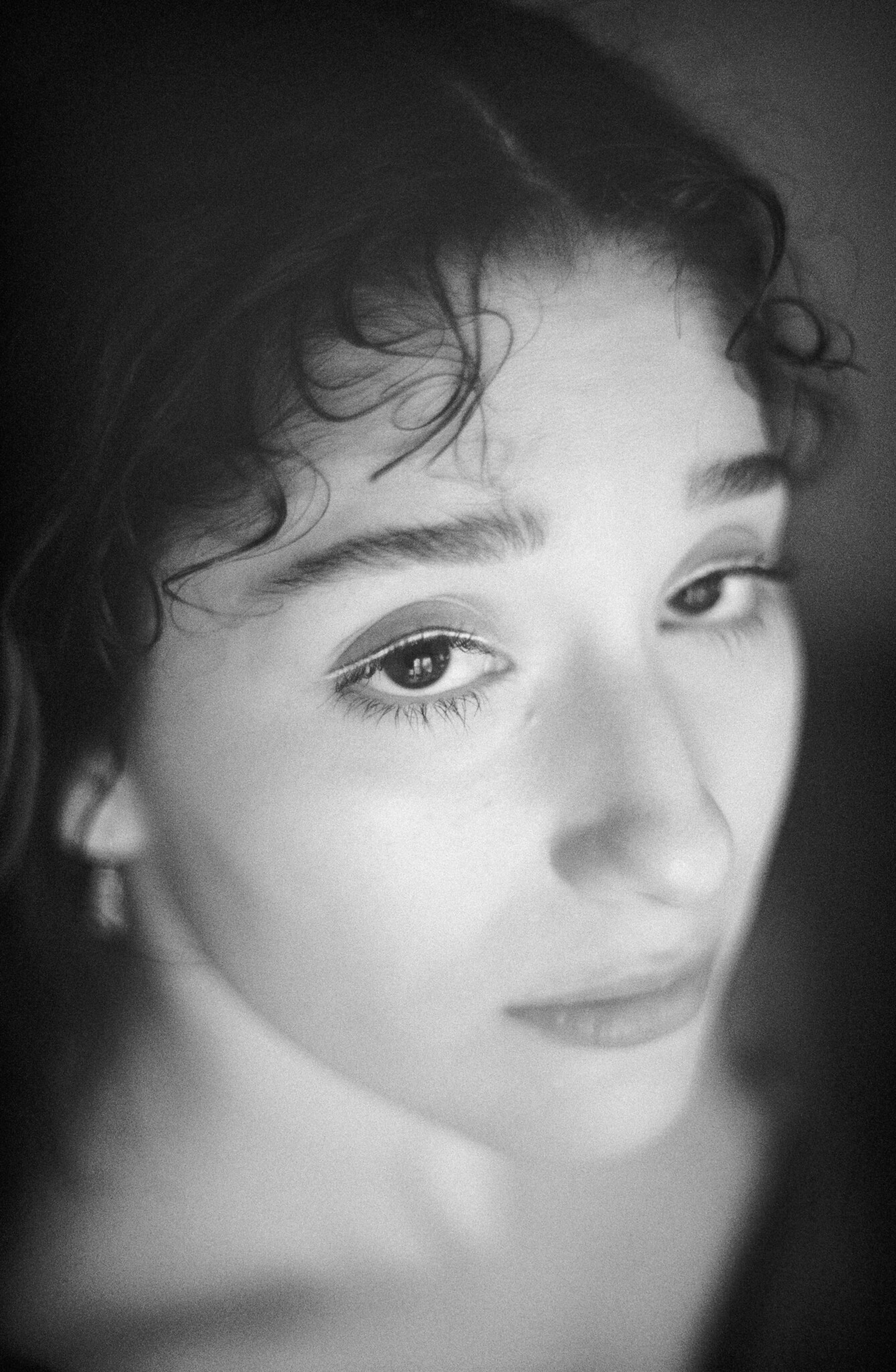

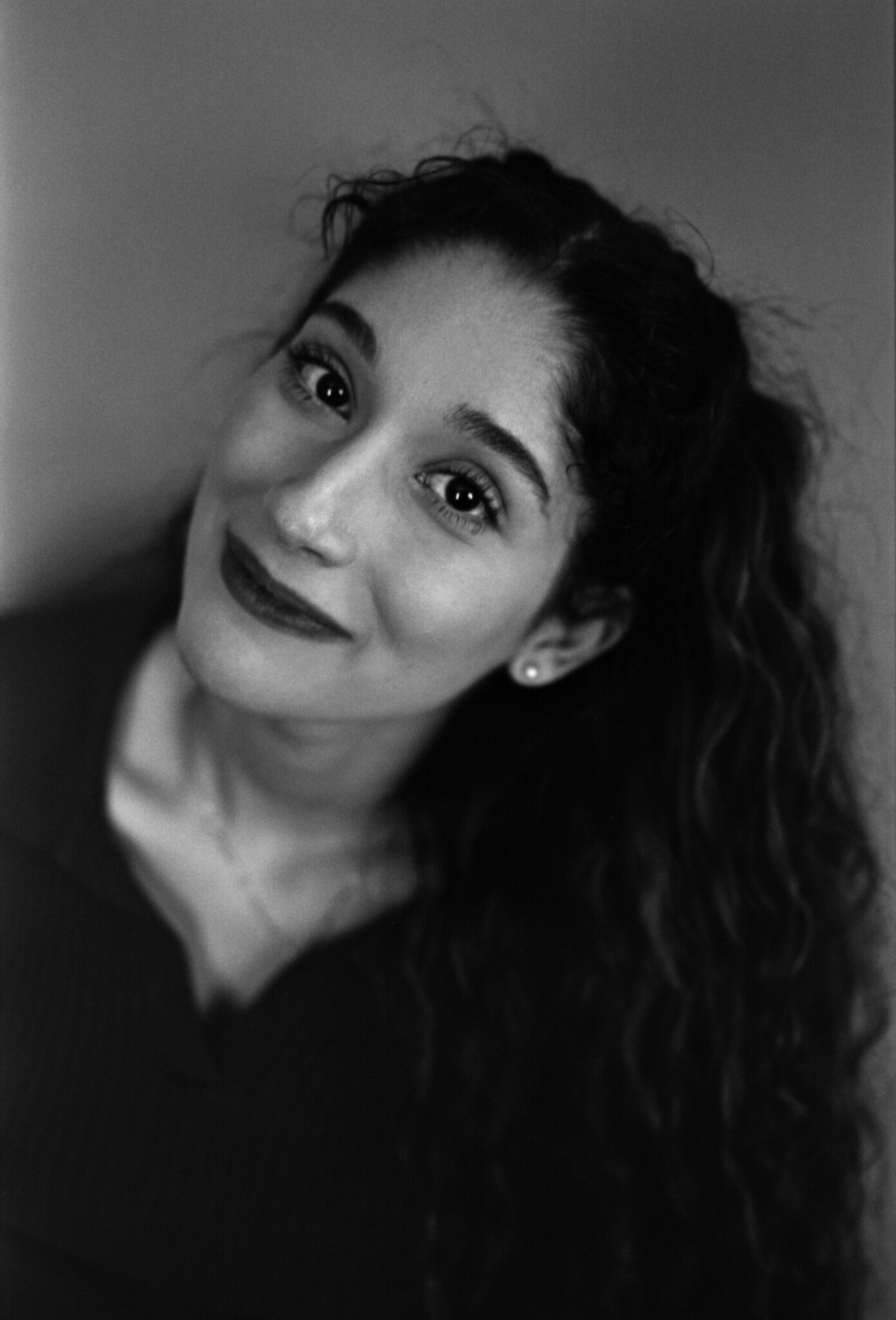

Regarding the OP's spectral sensitivity inquiry generally, I prefer the way films with more red sensitivity, like Fomapan 400, render skies in a more contrasty way, as if you used a filter. But you don't incur the loss of light or potential for additional flare that a filter would introduce.
Red sensitive films tend to make skin go paler, green sensitive will make it seem more tan with more contrast to freckles and the like. A note if you do portraits, they used to give actresses lipsticks with odd colors when they shot them on films with less balanced spectral sensitivities.
Check out the portraits below: Fomapan 400 @ 1600 (red sensitive) vs. Ferrania P30 @ 80 (red insensitive). Which renders a face better? I personally like both effects.
Yes, color filters have different factors depending on the spectral sensitivity of a film. It is often on the film datasheets.
Which films make shadows more luminous? Well, outdoor shadows tend to have a blue tinge from the blue sky, so I would think the more blue sensitive film would have an edge there. But I doubt that has as big an impact as the film's latitude.

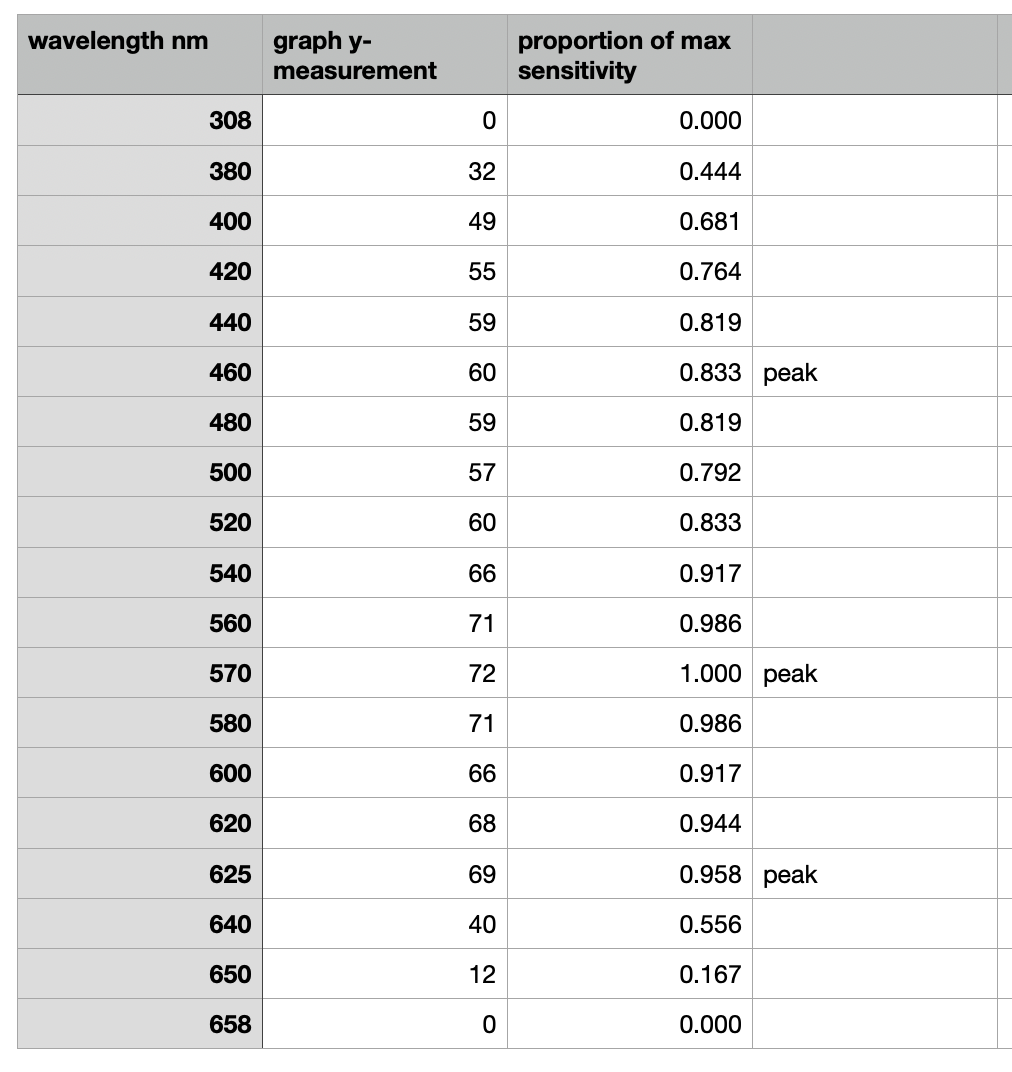

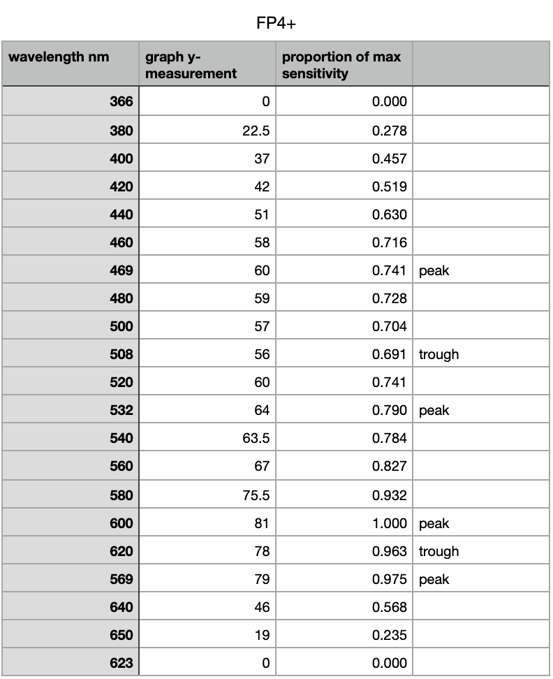

@Mark J: Here are the numbers for HP5+, for a start. FP4+ to follow later today. Regrettably, Photrio doesn't allow me to attach an Excel file, but hopefully you can copy and paste into Excel. Ignore column 2, obviously.

Note : Since the Kodak data is presented as a 'spectral sensitivity curve', my assumption is that this was done with a monochromator, which provides a (calibrated) flat response vs. wavelength over the whole spectrum. If there was any use of 'Daylight' ( eg. D65 ) in the test, Kodak would have stated that, and they didn't.
