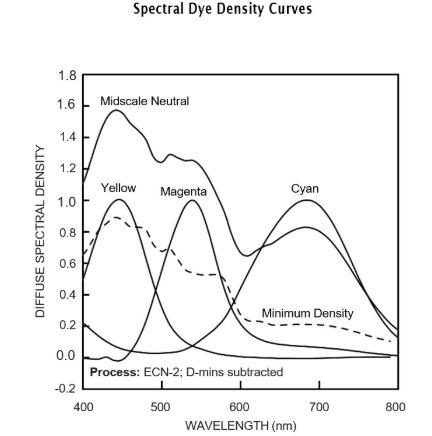

Datasheets of Kodak color negative films include Spectral-Dye-Density curves (see below for Kodak Ektar 100). Can someone please explain how these curves are measured and more importantly how to interpret them? If Kodak decided to include these curves in all their datasheets they must convey some important information about the film.

Still tricky because of the above. However, what I personally use them for is to figure out how a light source and/or a sensitive element (photo paper, a digital sensor) matches with the color negative. The dye peaks are discernable in these plots, so we can infer some things from it (to a limited extent!) in terms of the risk of crossover in the imaging chain. For me, a plot like this gives a starting point for a 'back of the envelope' analysis. This is the kind of stuff I mean: https://tinker.koraks.nl/photography/the-flipside-a-closer-look-at-printing-color-negatives/

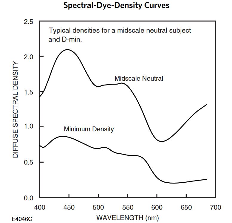

I don't get all that much more from it, and I think that's also about as much as Kodak intends us to do with it. Note that Kodak gives somewhat more detailed information for motion picture film; e.g. from the Vision3 250D datasheet:
Note how they give the actual dye peaks in this plot (and a broader spectrum), which I think is probably intended for the exact kind of analysis that I hinted at above - particularly digitization.

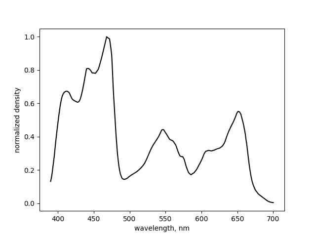

What I tried is obviously wrong but here it is.

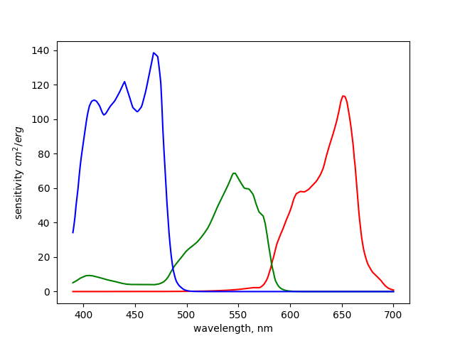

Spectral sensitivity curves for Ektar 100 digitized from the data sheet and converted to linear scale:

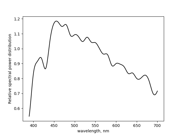

I multiplied each curve by the spectral power distribution of standard illuminant D65
and added the three curves:
Regardless of the question whether it was 'wrong' what you did - I'm wondering what you tried to learn by doing it?

I think the main conclusion you'll end up drawing is that the datasheets are insufficiently specific to be interpreted to any level of detail. What you can take away from them, is mostly at the level of some generic/superficial patterns. These are generally sufficient to effectively put the material to use.
I pay a lot of attention to how steep the three respective hills are, and to what amount they're fully independent, versus how much they overlap lower down. That tells me a lot about how specific negative films differ. I the case of Ektar you get rather cleanly separated steep peaks, which indicates a rather contrasty film with crisply defined hues, which is, of course, exactly what Ektar is.
By comparison, most color neg films have broader mountains with a fair amount of deliberate crossover lower down, for sake of less contrasty complex skintone reproduction.
