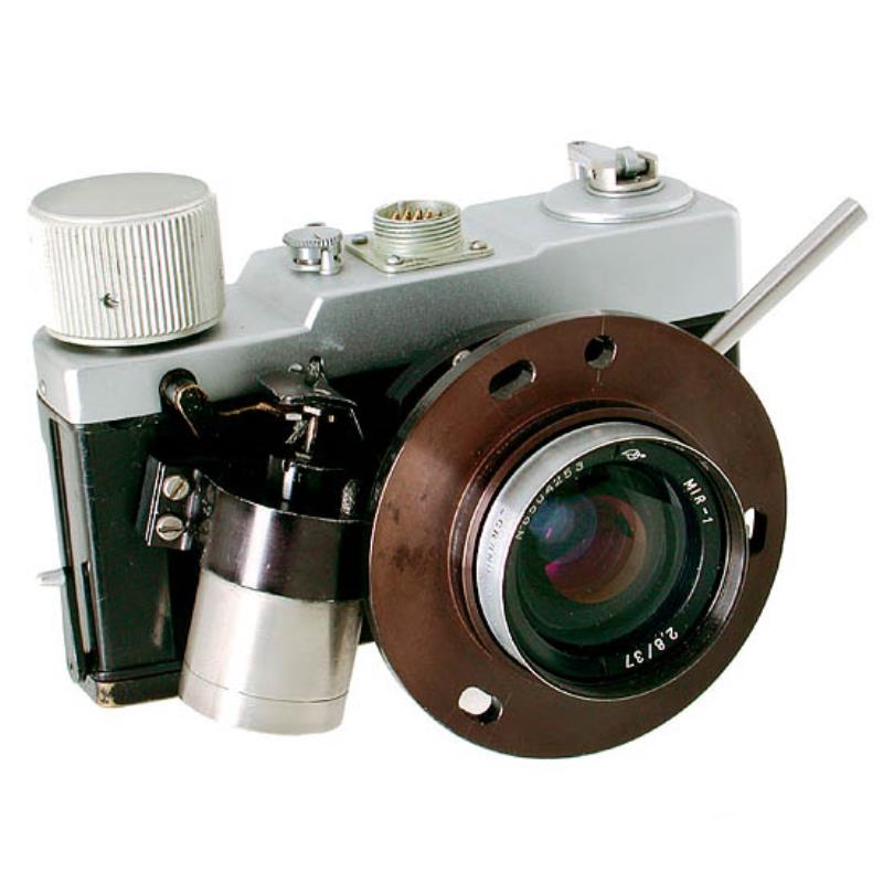

Kiev 6 Space Camera - http://ussrphoto.com/wiki/default.asp?WikiCatID=17&ParentID=1&ContentID=121&Item=Kiev+6+Space+Camera

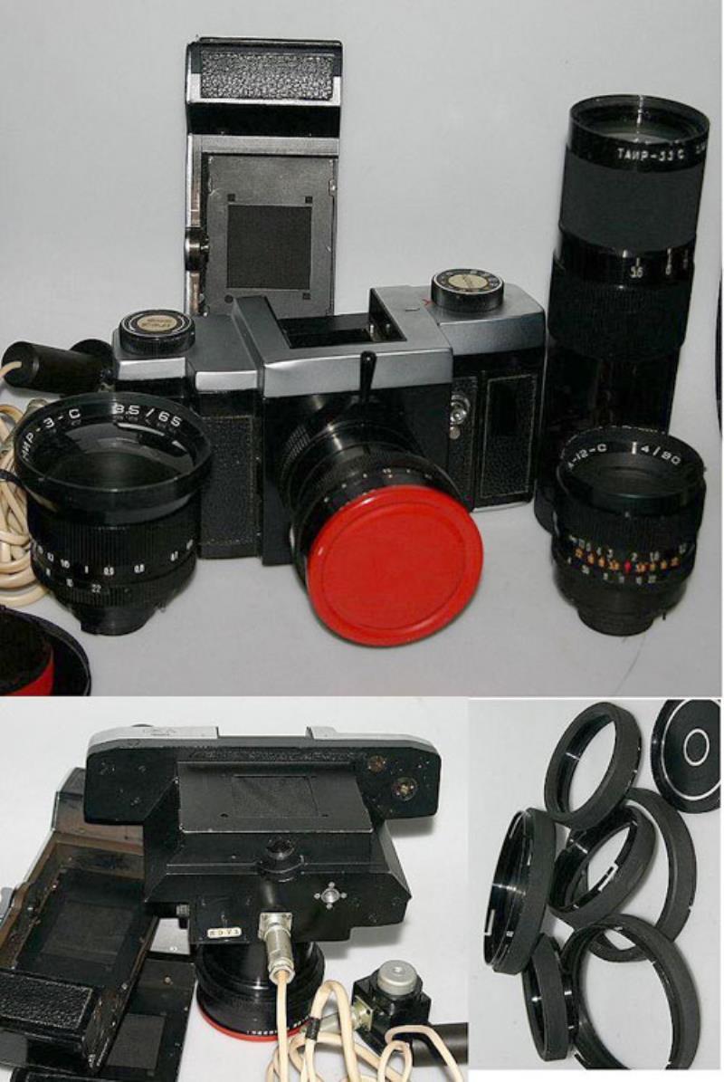

Leningrad - Space version - http://ussrphoto.com/wiki/default.a...&ContentID=143&Item=Leningrad+-+Space+version
and few more I don't see online reference for them, only in books.

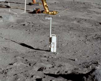

Kodak designed and built the "APOLLO LUNAR SURFACE CLOSE-UP CAMERA". It was a stereo camera with electronic flash. It used 35mm Ektachrome MS Film in a special metal magazine.
My first full-time job at Kodak was working on this. I graduated from RIT in March 1969 and started work immediately. In July the camera was carried to the Moon, used, film removed and the camera left on the Lunar Surface. I made sure that I handled each of the cameras delivered to NASA in order to make sure I handled the ones that were going to be left on the Lunar Surface. I was just a "kid" at the time.

That's pretty darned kewl. I hope you left a few very clear fingerprints somewhere inside the cameras so your fingerprints are on the moon.:smile:
