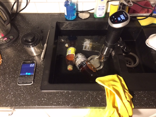

so, my cheap chinese or somewhere-cheap manufactured circulator (bought at the Jula swedish stores that we have also here in Norway), there set at 38C, chemicals in the sink, a thermometer on the side for checking temperature of rinse and wash water that will be used on the smaller side sink. An old Blackberry phone is the stopwatch .
Very little is required. Have done hundreds of rolls like this, never a problem.

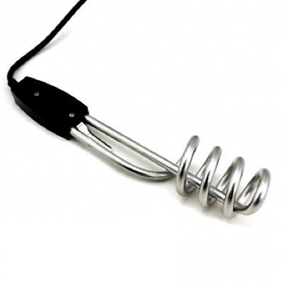

the oldest basic water warmer electrical device (without temperature regulation/control), the good old Tauchsieder or whatever you call it in english:
