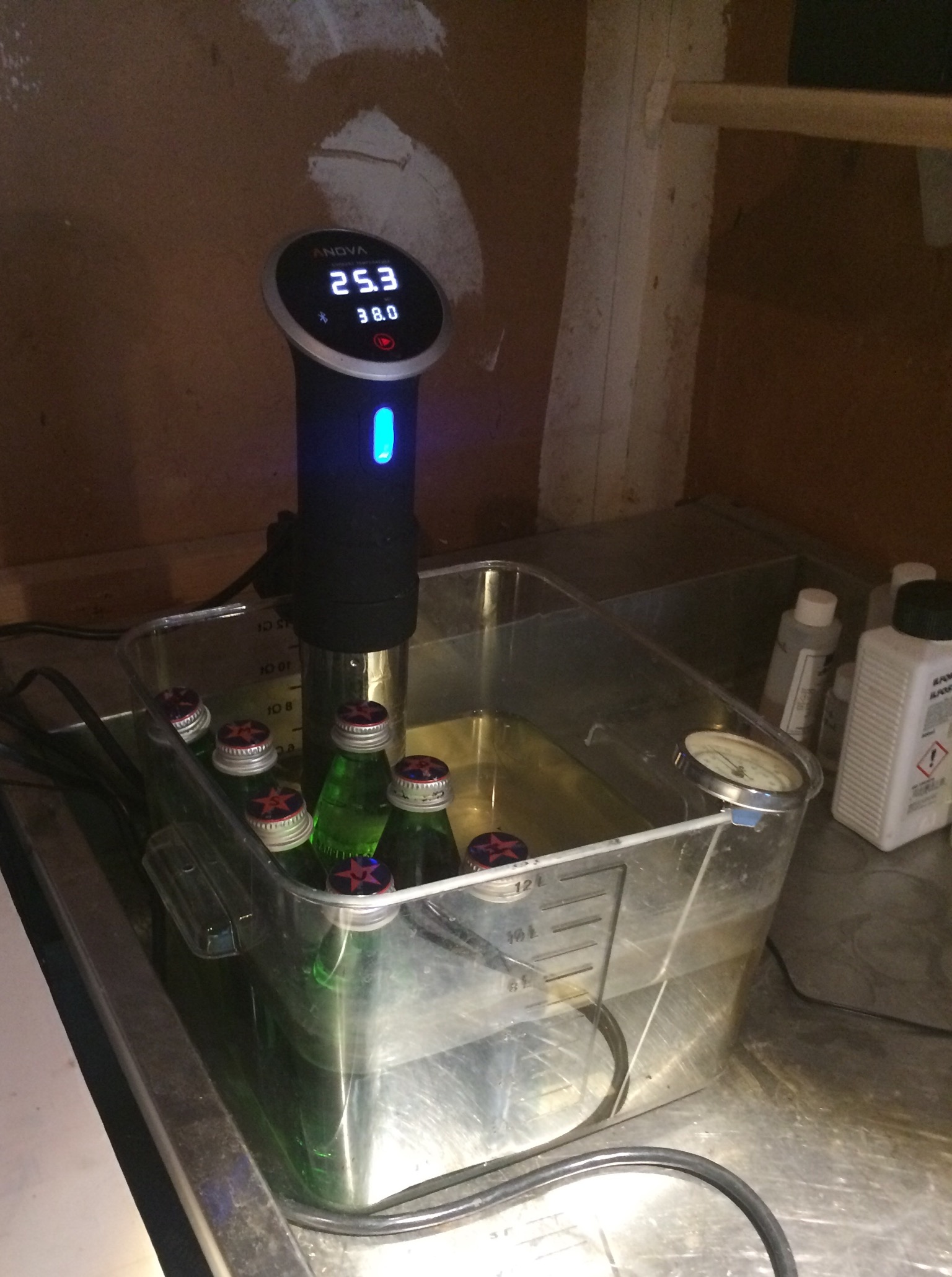

I use an Anova sous vide heater for both C41 and RA4. It’s a simple set up. I bought a Rubbermaid food storage container off of amazon that was the right dimensions for a relatively small footprint but still high enough to fill over the min point of the heater.
The heater is accurate to my thermometer. But make sure that you give the bottles enough time to heat up. The water bath will stabilize before the bottles.
I use 250 mL San Pel glass bottles for RA4 with a 16x20 drum and 500 mL amber plastic bottles for C41 with a Kindermann SS tank with 2 35mm reels.
The C41 is immersed in the water bath for processing and propped up on a ramiken to the right level. I usually have to go about 1 degC above temp on the Anova to account for changes in temp during pouring and agitation.
Since the RA4 is done in a drum outside the water bath I set the Anova at about 2 or 3 degC above rec temp. This becomes much higher if I process at low ambient temps.
The Anova can be set low as well. I set it to 5 degC in the winter to prevent freezing of my chems. My darkroom is in my uninsulated garage.
I’ve been using the Anova for two or three years with no problems at all. The photo above is my water bath in the RA4 configuration.
