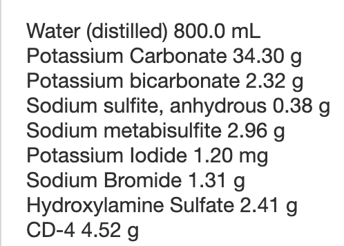

Not sure what version of C41 without looking at the sources I used, but this is my recipe. I use Kodak blix replenisher. You can find it in bulk online at the usual photography stores
Do you need a starter for the blix?

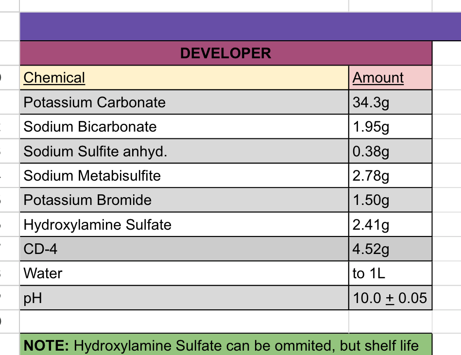

Curious, your formula is similar to the one I have issues with. I wonder if the differneces between the relative Sodiums and Potassiums has something to do with it? This is the one user RPC says works for them with the Pot F bleach.
The carbonates and bicarbonates are acting as a buffer to help with the pH of the developer. The potassium iodide helps prevent fog so perhaps maybe that would solve things. Although my ECN-2 films processed with my recipe have no fogging.
I’m no chemist either so maybe using the sodium/potassium for both carbonates is better than using a mix of the two idk
In the developer, it won't matter. This will affect solubility of a concentrate, but if you're mixing a working strength developer in one go, it doesn't matter and certainly doesn't explain any fog.
In a blix, this can be a very significant factor. There are some posts from @Photo Engineer that discuss this. IIRC sodium and especially potassium are to be avoided in blixes.
