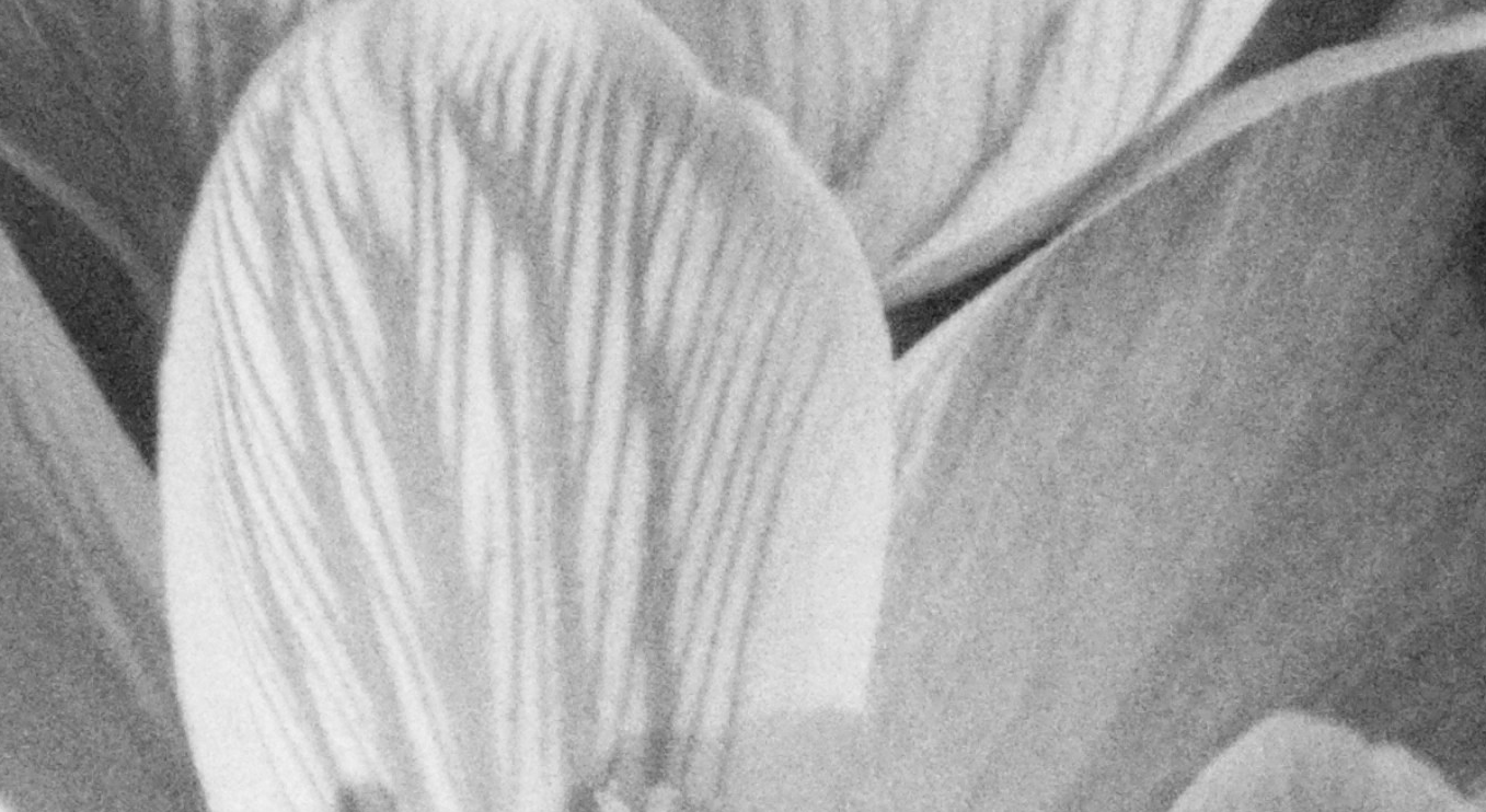

Just as a scientific exercise, please find below 1:1 versions of (portions of) the last three pictures, those pushed to 1600 ISO, in the same order as in the OP. No interlacing or smoothing, just pure 1:1 mapping of pixels on the screen. Hope they do not get resized by the import....
The flower was a surprise for me as well: it was shot with an old Yaschica MC 75-200mm zoom at fake-macro (1:4) ratio, focal length 200m, f:11, I guess at 1/250 or 1/500 as it was ovcercast. I bought the lens off ebay for 25 quids (LOL), clean, functioning and all. I honestly expected a much softer touch from it, especially at 200mm, which would have been amplified even further by the pushing. That is why I am impressed by how it came out, after all.

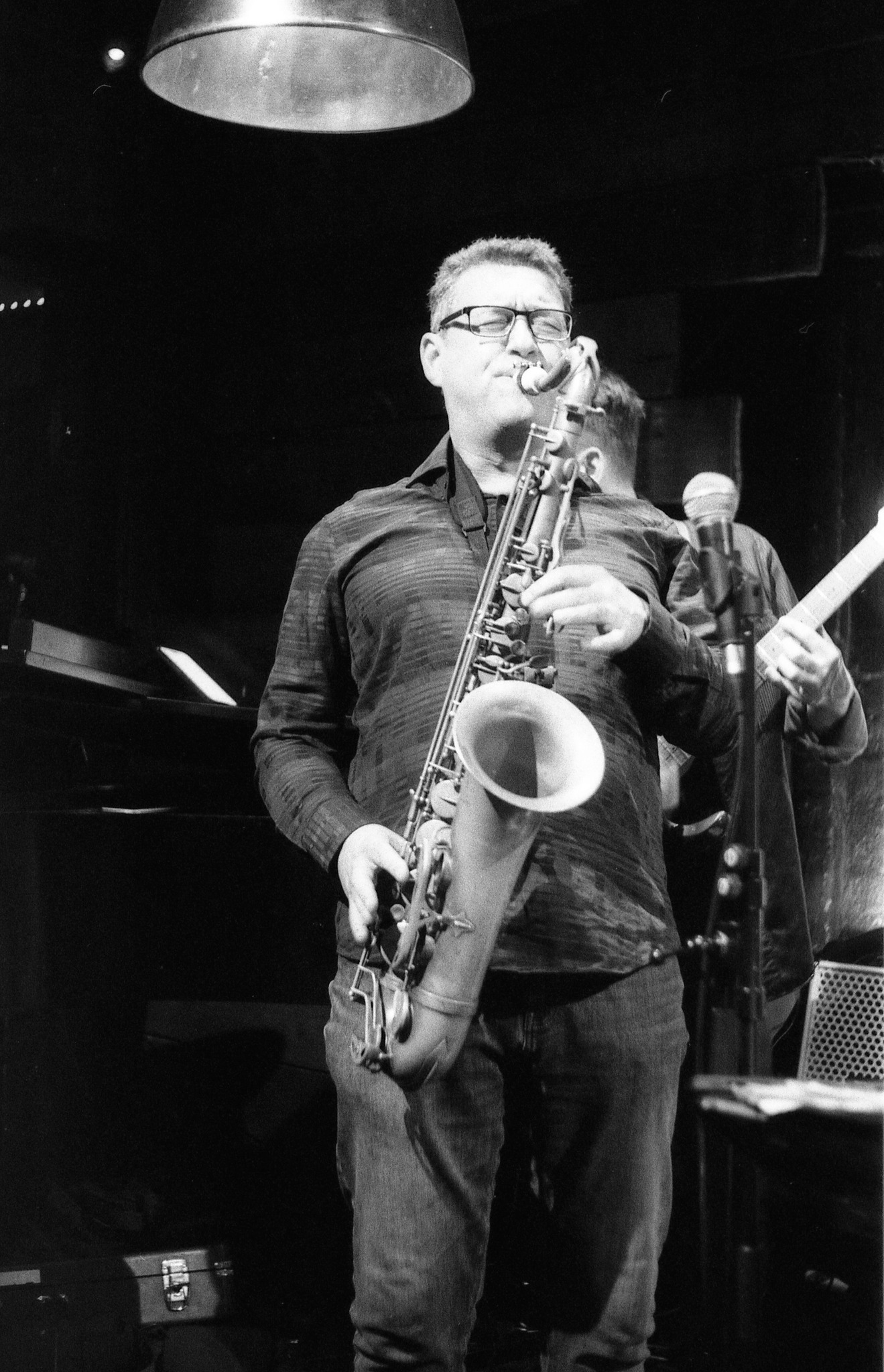

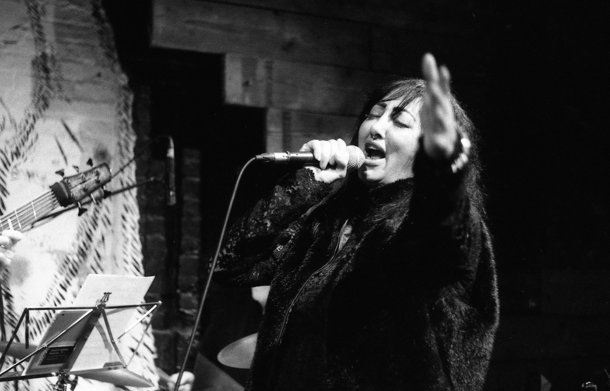

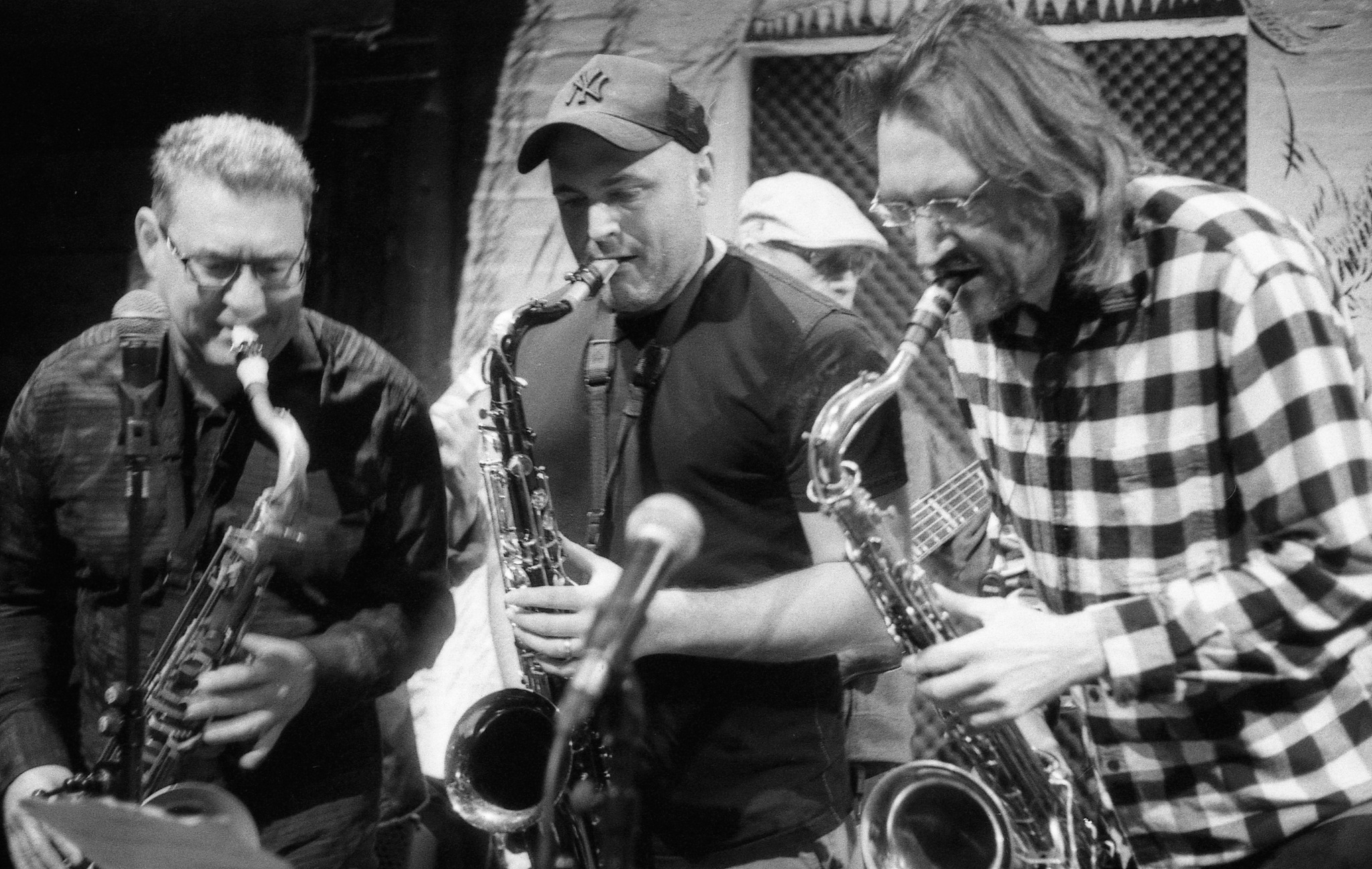

I've moved to Kentmere 400 for my gig photography, pushed to 3200 in Ilford Microphen. I scan using an ancient Epson V-series flatbed. These I lifted from my social media as I am currently at work without access to the original files....but they give an idea of what Kentmere 400 can do pushed to 3200
Thanks for sharing those @Agulliver , much appreciated! You results are very good, and it looks like Microphen did a truly decent job there. I used Microphen a lot during my previous film life, mostly with FP4+ and Agfapan APX 400, but I am intrigued to see how far one can stretch ascorbate-phenidone developers, which I had never tried before (I had used exclusively MQ or PQ ones).
I am now really tempted to try and see how BWG would behave on Kentmere 400 pushed to 3200 ISO.... :smile:
BTW, the last two shots (k1.jpg and k2.jpg, the two saxophonists) are really amazing.
Thank you very much. It's a tricky lighting situation because the back wall is backit in red, one of the spotlights shines directly down (it's known as "the transporter") and use of the regular spots is inconsistent. They only really started using the spots because of my regular presence!

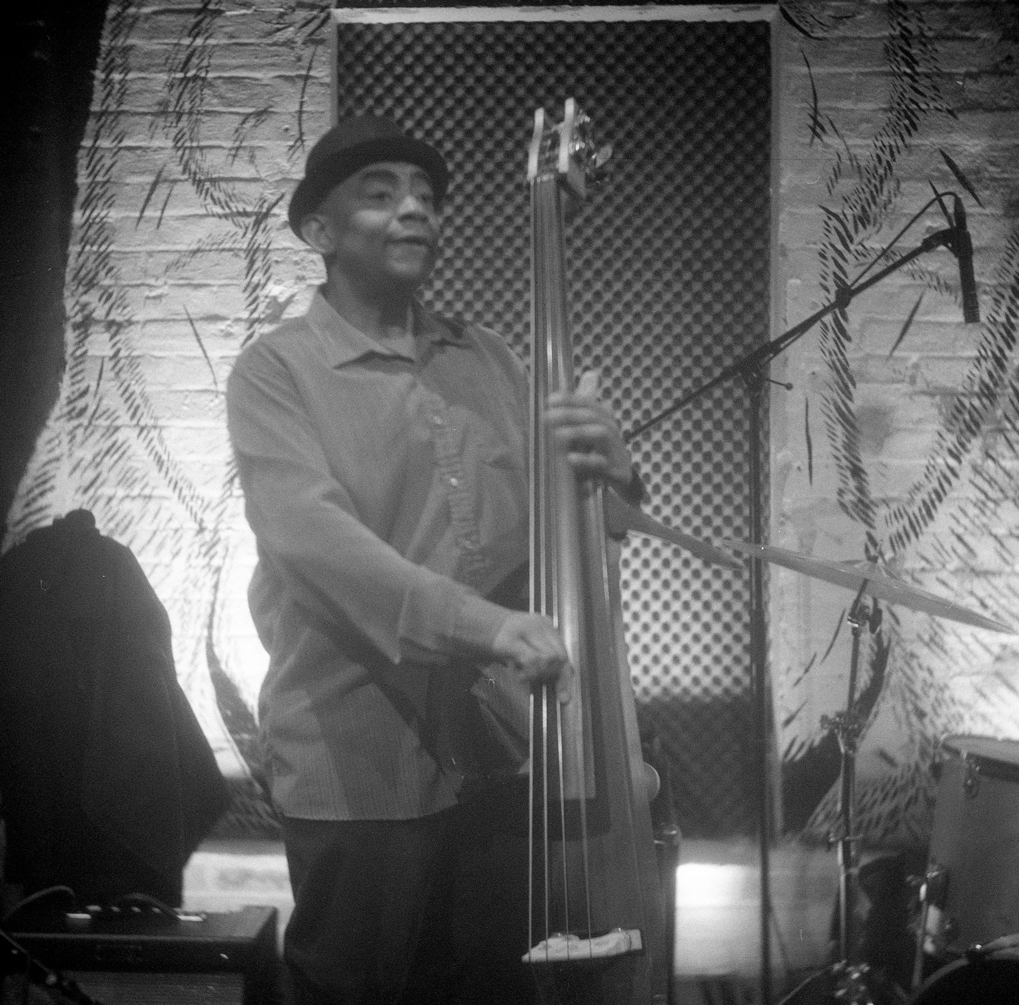

Curious to see how your pushed K400 with your Super Ikonta comes out. I use the same Super Ikonta B with the f2.8 Tessar, but very, very rarely shoot at f2.8.
I did put a roll of Delta 3200 through it shooting at the same club at f2.8. This was actually a test roll, after acquiring the camera. I think it did OK.
If I use K400 at f2.8 and around 1/30 shutter speed, that will be the same parameters in which I shoot 35mm when I push K400 to 3200. It'll be interesting to see the difference, probably a lot more contrast. I like the small depth of field when I nail the focus.

That seemed to work out just fine. The first Super Ikonta B I had had an uncoated lens (I loved it) that was sharp, but lower in contrast. My present one has a coated Tessar, but is still a little lower in contrast than a modern style lens. For stage shooting that might be a little plus and add something to your pictures.
