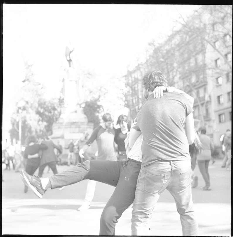

Pretty much all of my negatives comes out looking like the first negative on the left, flat and milky (the version on the right is after photoshop has done its thing). I shoot medium format Ilford FP4+ and use Ilford Ilfosol 3 as my developer. I develop for 9 min, 1 min Stop and 10 min Fix at around 19-20'C (68F).
I have another roll I'm planning on developing today. Should I add 1-2 minutes to the developing time and see if it improves?

If you constantly print on #4 or #5 paper you could increase development time by 25%. Printing on #4 or #5 paper emphasizes grain, so if you want that effect, you could continue as you are.
Scanning provides minimal useful information for your situation. Examination of properly processed negatives on a light table should show they are less contrasty than the original scene. Like 60% to 70% less contrasty to the eye.
If they look like projection transparency slides in negative, with deep blacks and clear areas, they are likely too contrasty for condenser enlargers.
If you can see a positive reflection of your scene on the emulsion surface (like a Daguerreotype) then they are likely not contrasty enough for diffusion enlargers.
You want somewhere in the middle.

It may not feel right, but your negatives don't look right either. Try 4 minutes, or dilute 1+14 and go for 7 minutes. I have never had a problem with the times from the Massive Development chart. I use the app all the time.

Your scan looks both overexposed and overdeveloped. Then again, a scan is difficult to judge. I'd like to see a photo of the negative itself.

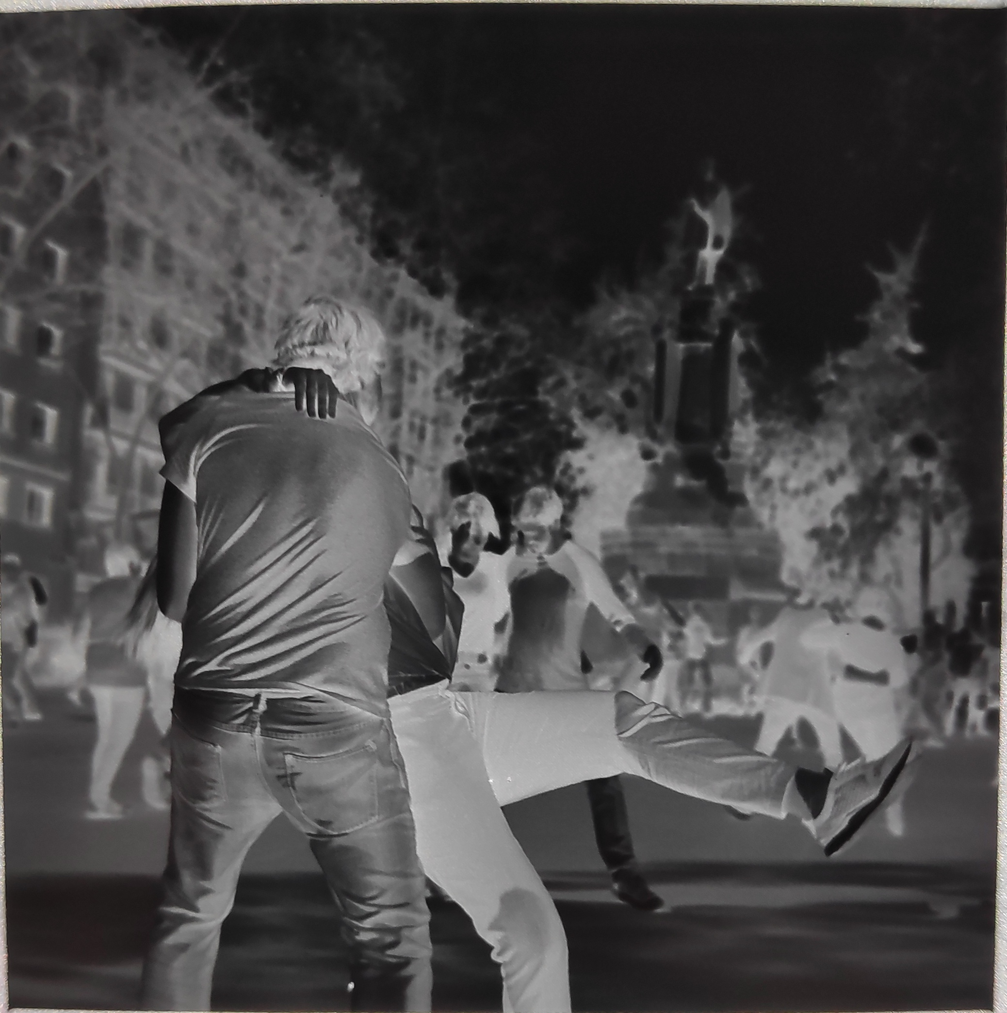

Not sure if this will be useful or not. Had to improvise with my tablet as light box and shooting with my phone.

You can develop quite a bit less. And your exposure is quite liberal as well, but that's less problematic as a little extra shadow detail doesn't hurt.
I agree. If this were normally exposed, you'd have detail in the sky, even if you underdeveloped the shot. This looks a lot like one used to experience shooting an old TLR with a slow shutter and then taking it to a lab where they developed everything for 6 minutes at 20 C, no matter what film it was.
Something does not seem to make sense about your question because developing FP4 in Ilfosol for EI 125 for 9 minutes at 1+9 and 68 degrees (a combination whose time is listed at 4'15") should result in very, very dark negatives, especially the way this negative looks like it was exposed. So maybe it's bad developer, bleaching all the image out with fixer, or something unusual.

As was posted above, good negatives look much less contrasty than good slides.
The negative that you have photographed with your phone looks to be over-developed and possibly over-exposed. The "milky" response you referred to in your opening post is the result of your scanner having problems with the too dense negative.
The following link has a useful article about assessing negatives. While the illustrations aren't perfect, they should give you an idea about how a good negative should appear: https://www.ephotozine.com/article/assessing-negatives-4682
If you look at the illustration of the negative that is described as being properly exposed and properly developed, you will most likely note how relatively "flat" and "thin" that negative appears compared to yours.
I hope this helps.
Please tell the group:
- How you are measuring temperature
- What camera this is
- What light meter you are using
- Your exposure index (125? 500?)
- What your dilution with Ilfosol 3 is - and how old your developer is.
- Are you diluting the fixer or using it straight out of the bottle?

Thanks for the input guys.
I shoot on an old TLR as you suspected Dante. A Yashica D. I measure temp with a digital food thermometer. I haven't invested in a light meter yet. I don't know how old the developer is as I can't see a date anywhere on the bottle. But it was bought from the biggest supplier of analog equipment in Barcelona, so their turn-around should be trustworthy . And I have so far used 1+9 dilution. The fixer I use is the Ilford Rapid Fixer and I have diluted that 1+4.
Regarding the approach of taking the same photo with different exposures. That is something that makes perfect sense and that I will have to do. Better to burn some film early on in order to take better photos later.
