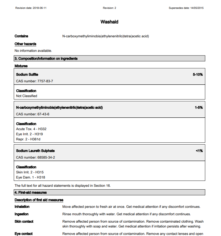

And here is a page from the Ilford Washaid MSDS - it is essentially sodium sulfite:
OK, I am convinced! I shall change my practices. Thanks. I might even just use sodium sulphite rather than having a rapid throughput of Washaid (and all that packaging).
Sodium laureth sulphate rang a bell, as a commonly listed among hair shampoo ingredients? It seems to be a surfactant/foaming agent. Any idea what the third ingredient with the very long name might be doing? I guess it isn't necessarily the least important just because there's less of it than the sulphite.
