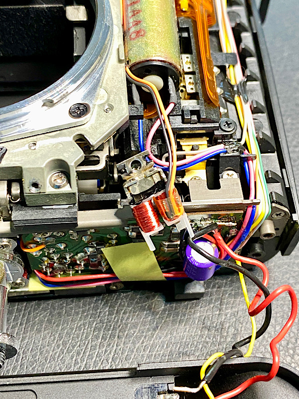

The solenoid in a Canon T90 that controls the movement of the mirror. A magnet wrapped in enameled copper wire holds a metal armature (not visible here).
If no current flows through the coil, the armature is attracted again and the switch is closed.

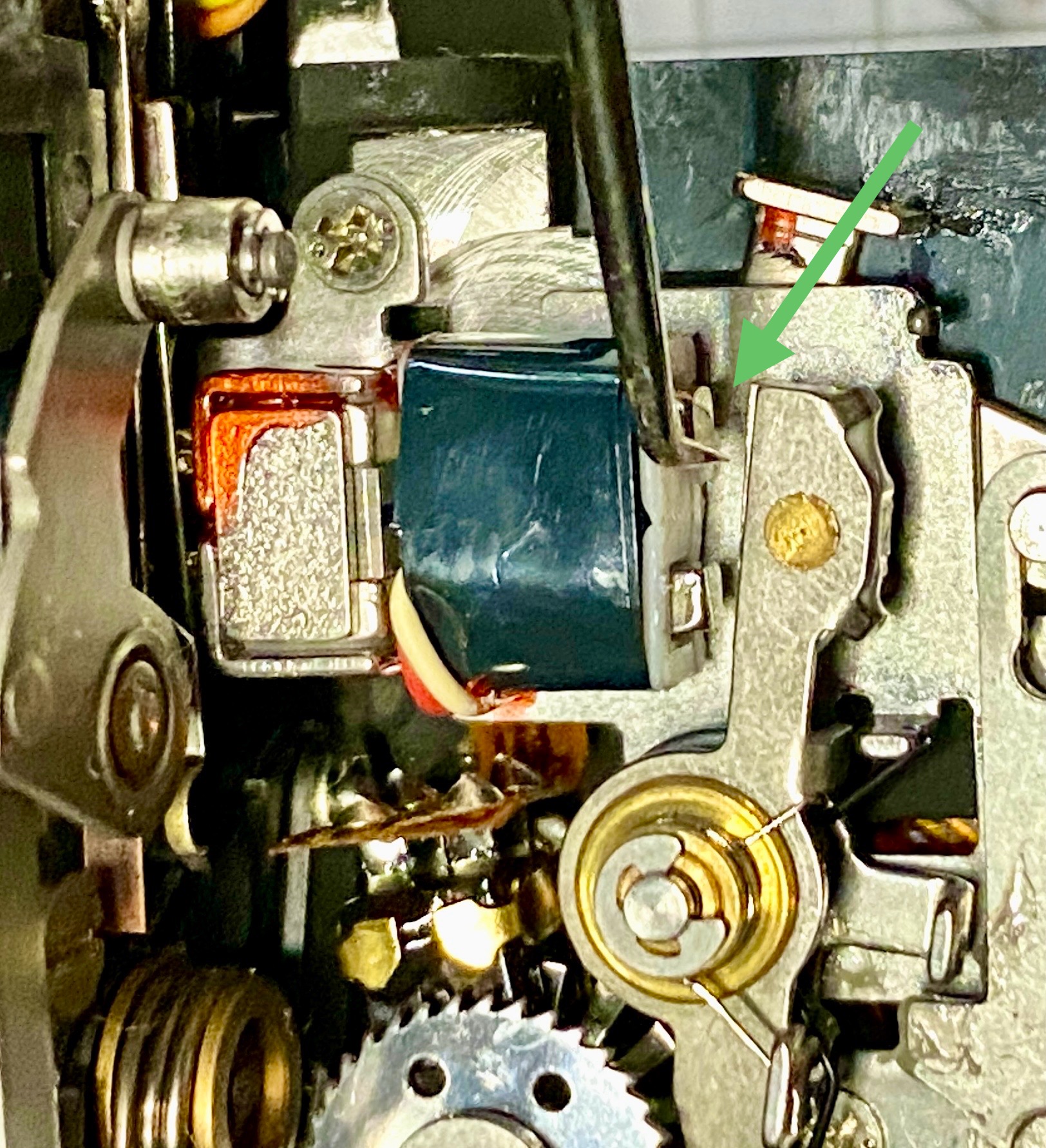

The aperture control solenoid on the mirror box of a Minolta 7000 AF. The armature is held by the magnet, so the switch is closed ...

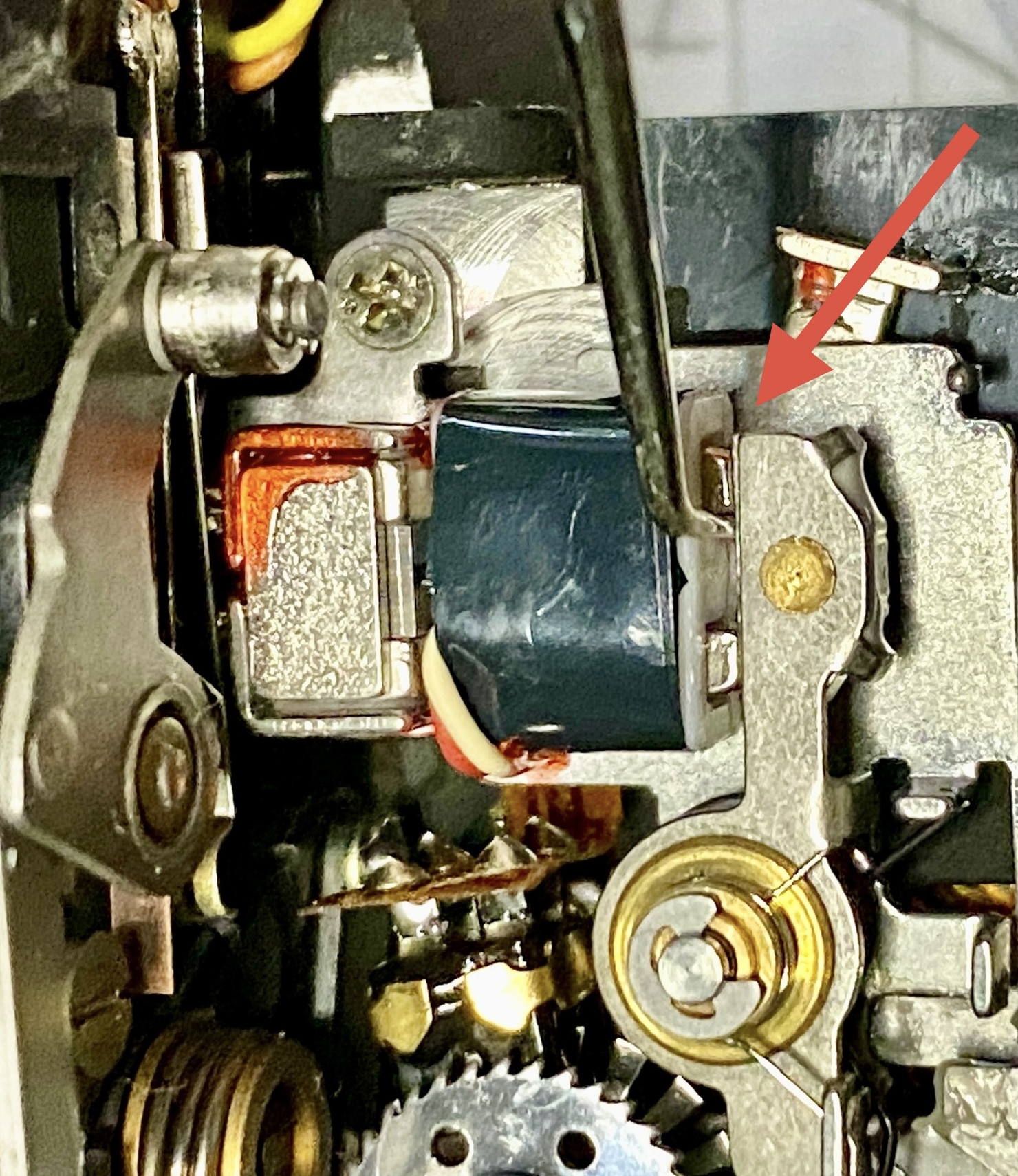

… after current has flowed through the coil (here coverd with black tape) the magnet releases the armature and the switch is opened.
This is made possible by the fact that the current that flows through the coil creates a magnetic field that cancels out the field of the magnet.

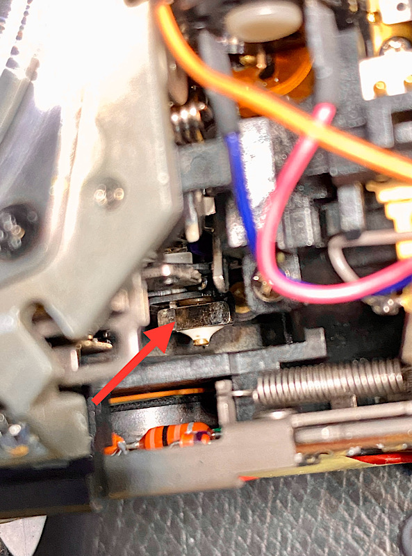

If solenoids no longer work properly or no longer work at all
it is often because the contact surfaces between the magnet and the armature are contaminated, eg. by oil.

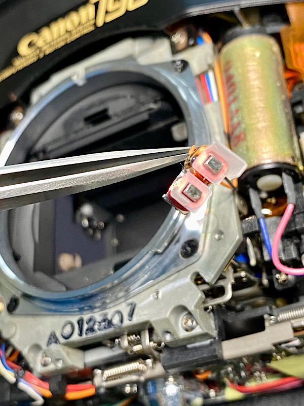

To access the mirror solenoid on the Canon T90, the camera must be disassembled to a small extent.
The magnet and armature can then be separated …
… and their contact surfaces cleaned from contamination.

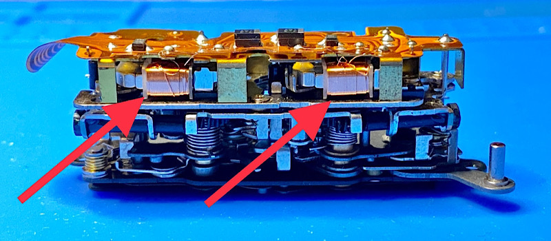

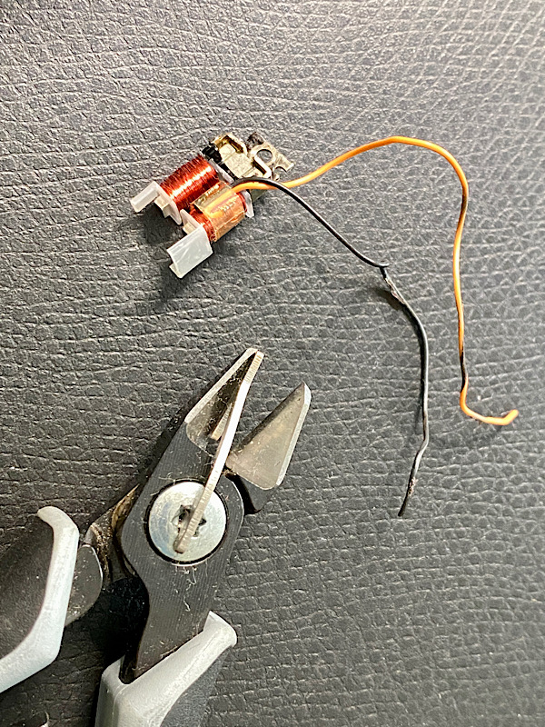

Interruptions or short circuits in the fine coil winding made of enamelled copper wire can also put solenoids out of action.
However, in order to reach the two shutter magnets on the Canon T90, the camera has to be disassembled deeply. An effort that is not always worth it.
