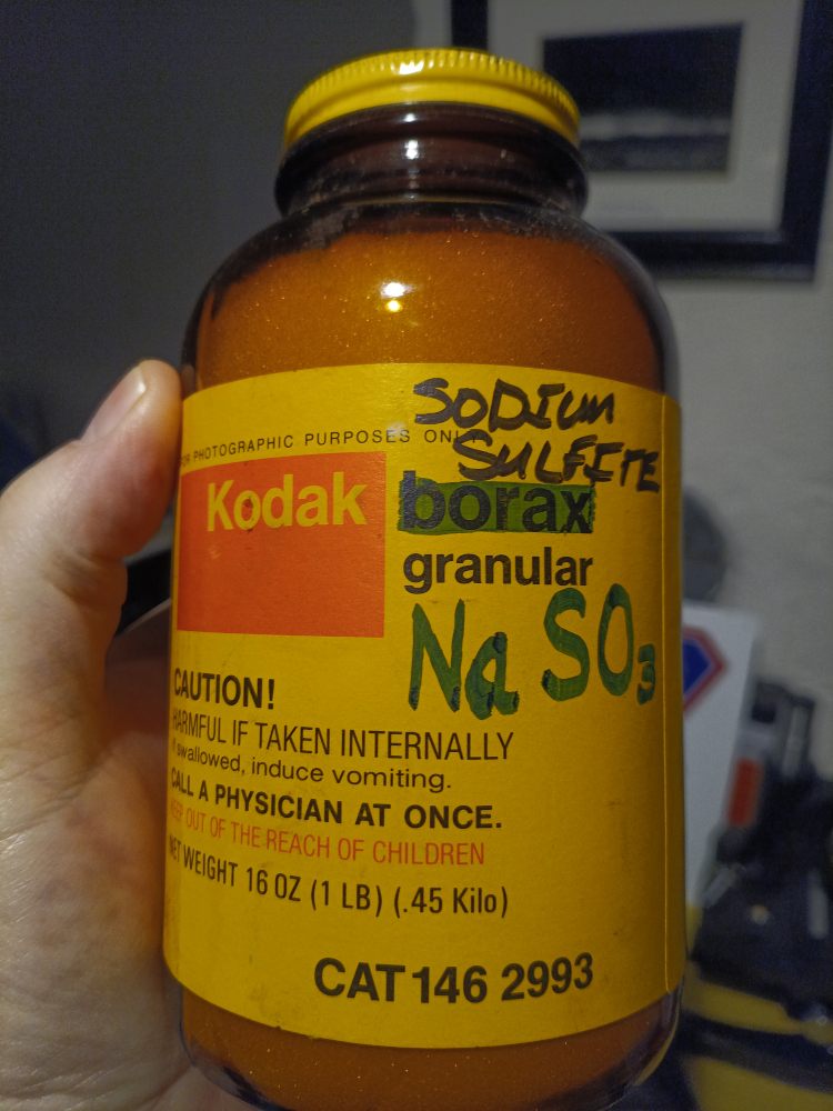

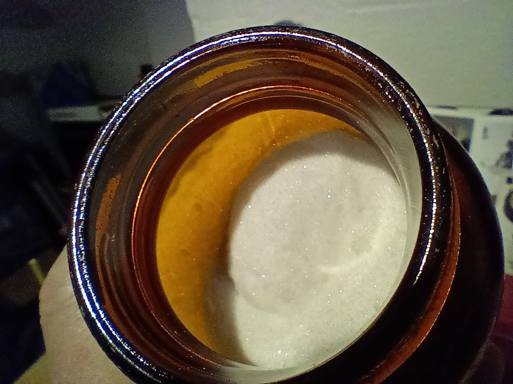

For years I have been staring at a repurposed brown, Kodak chemistry jar, filled with a white powder with "Sodium Sulfite" and "NaS03" scrawled on the label. Got the bottle with some darkroom equipment and it's still fully dry, powdery and well sealed, but I don't know what exactly it would be, as NaS03 purports to be "Sodium Sulfate".
Anyone know of a practical test to determine the true identity?
If it is Sodium Sulfate and not Sodium Sulfite, what practical good is it in photo chemistry? I do not ever recall seeing any formula call for Sodium Sulfate.
I would hate to toss pretty much full quart of a good chemical, but unidentified it will have to go to the next hazmat disposal event.
Sodium sulfite is Na2SO3
Sodium sulfate is Na2SO4
Make a solution and test pH. If it's neutral, it's sulfate. If it's alkaline (~pH9), it's sulfite.
I think it's an ingredient in Kodak's ECN2 remjet removal/softening bath.
Thank you. Good information.
A practical test would be to mix up 250ml of D23 as a 1:1 dilution. So, 1 g metol, 13g of your mystery powder, in 250ml water. Then develop a bit of film. If it works properly, you have sodium sulfite. (Or something you can pretend is sodium sulfite because it does what you want.)
The jar looks great, and sulfite is very cheap. Throw out what's inside and refill it with a fresh batch :smile:
By the way, dissolved sulfite has that characteristic smell common to most black-and-white developers - familiar to anyone who's spent time in the darkroom…
